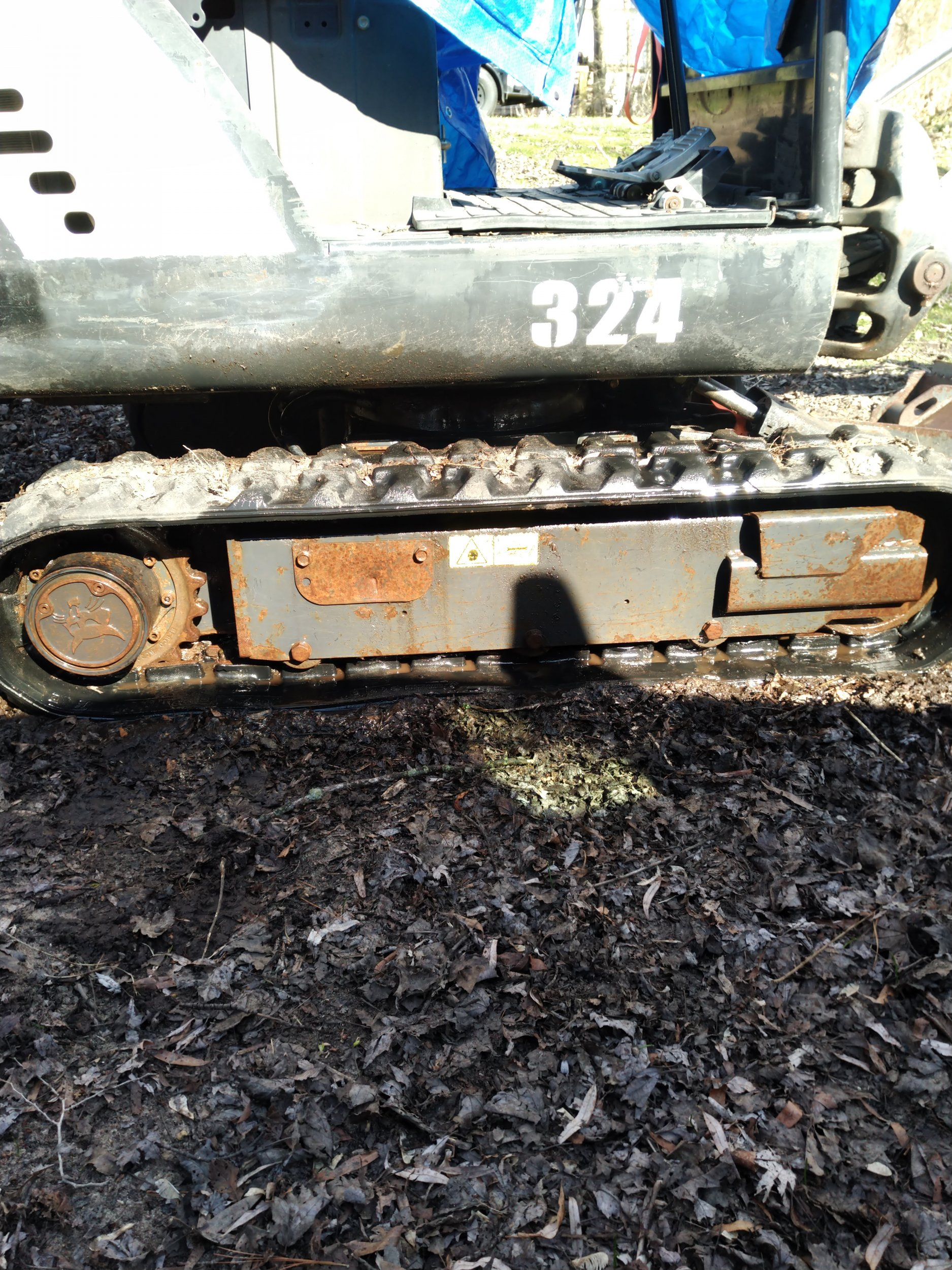

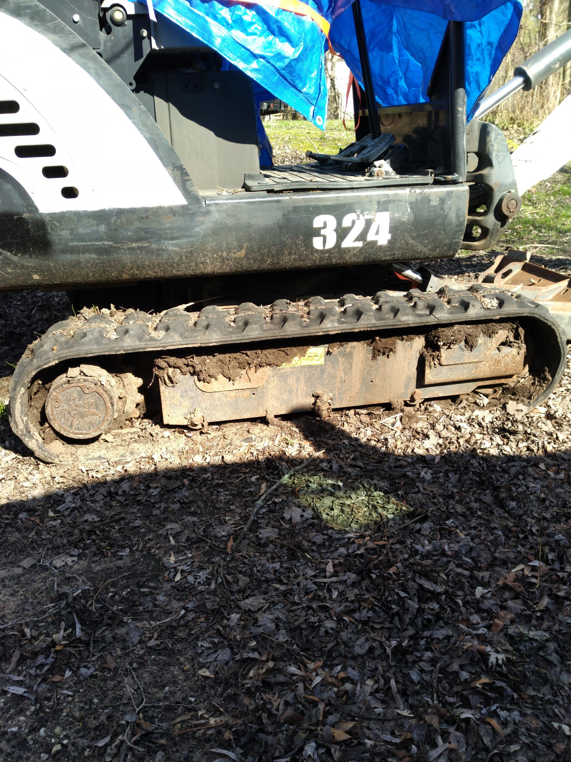

Volume is key...1000 psi is plenty with a 5 gallon per minute pump....
Agreed. Excavator tracks tend to carry a fair amount of dirt and small rocks. It takes volume to wash that away.
/ Pressure washer with suction?
#37
Works pretty good. Not gonna remove paint but still knocks mud off
