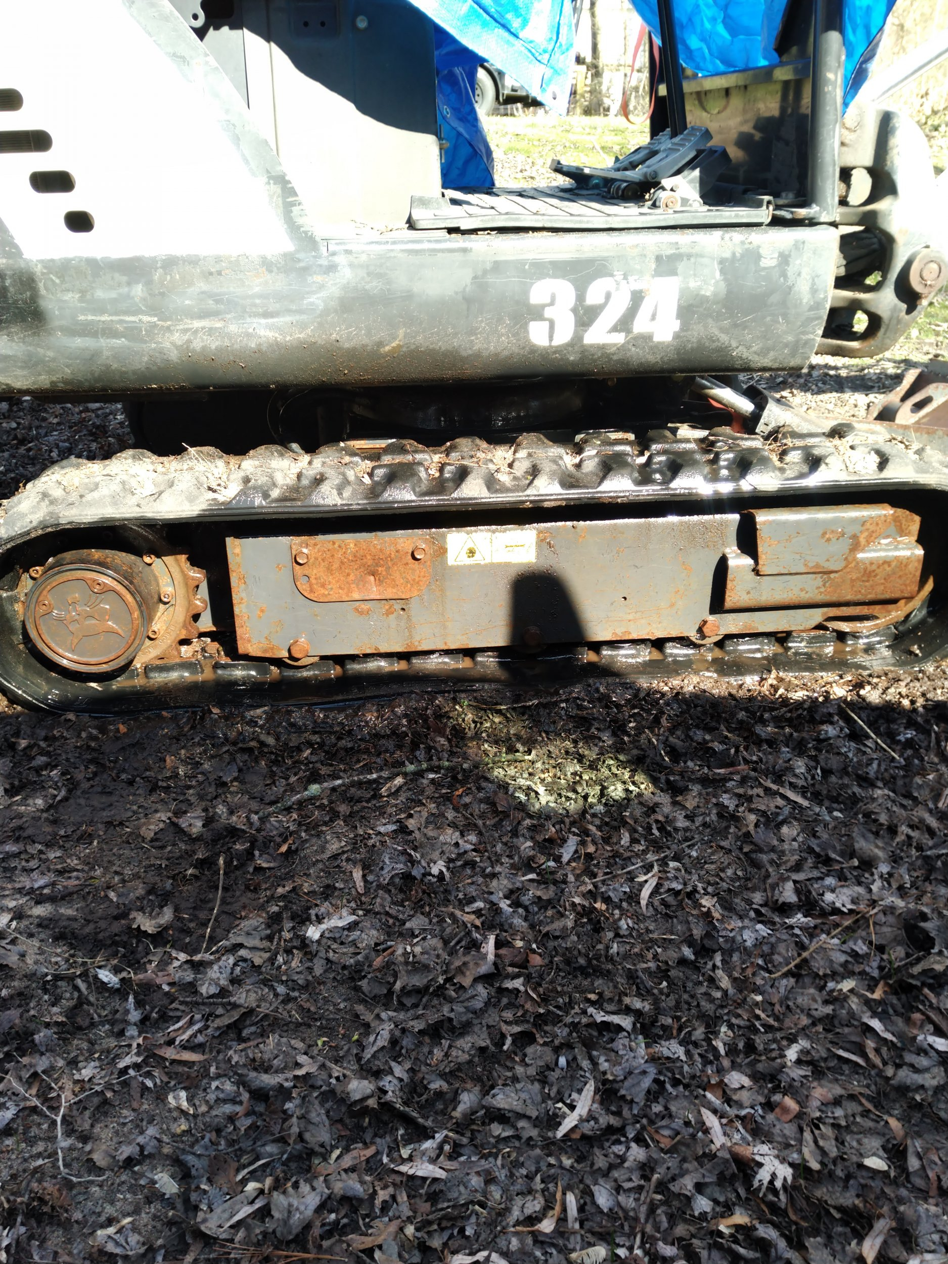

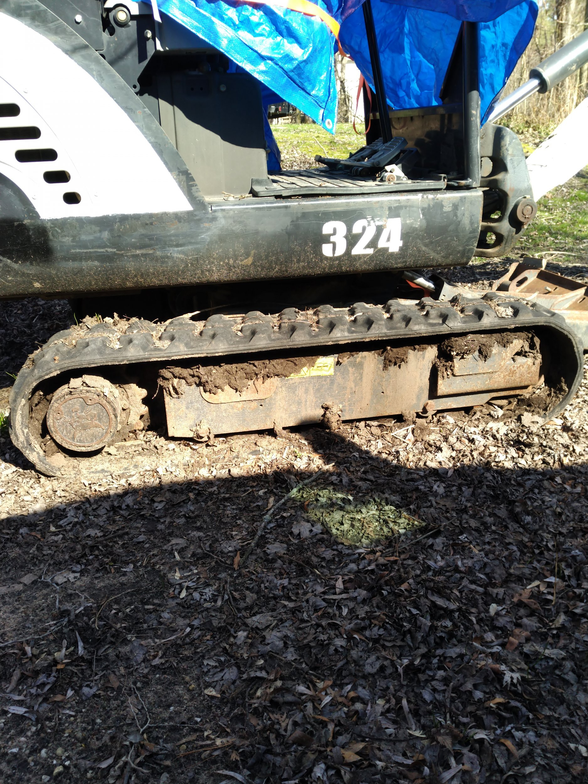

With that little battery powered DeWalt, took about 5 minutes and roughly 3 gallons of water for 1 track.
It will do what I'm after but still not sold on it. It was worth a try. It's better for knocking road dust off a 5th wheel camper which is what my friend uses it for.
