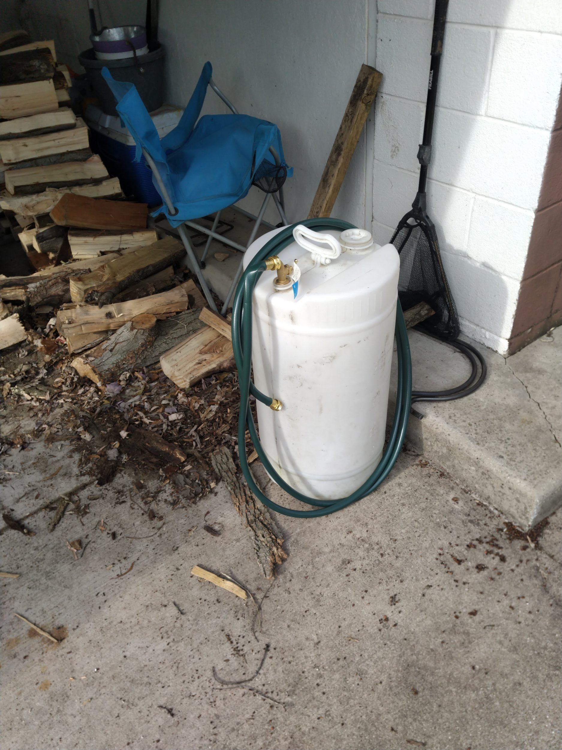

I got an 8 year old generac and this weekend I tried gravity feeding it. It actually worked quite well. PSI was down from hooking up to the house. I'd say it was running around 1500-1700 psi. Washed the wife's truck and went through about 12 gallons of water. Pump did start to heat up so it gives me an idea.

I don't think mine "sucked". I filled up one of those plastic 20 gallon jugs, put in the faucet and hooked up the hose to the washer. It was up on our retaining wall so roughly 4 ft above the pressure washer.
How long was your hose from the water source and how much of a drop?
   / Pressure washer with suction?
#32
Hose was 15 ft and the barrel was raised roughly 4 ft above the washer.
