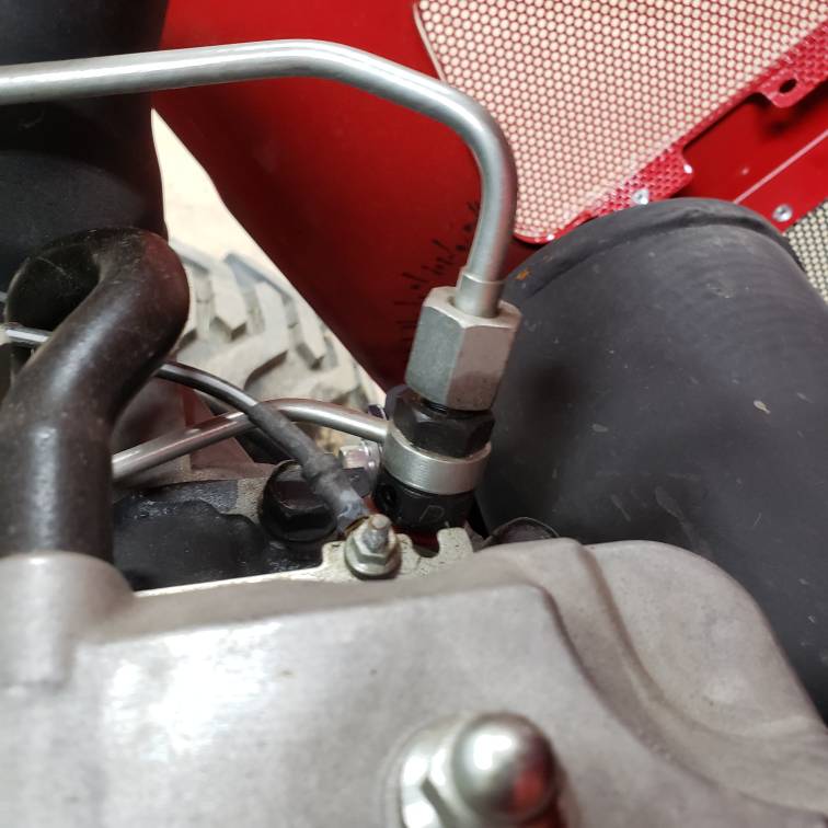

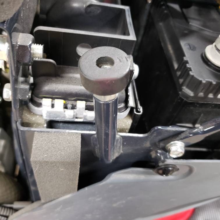

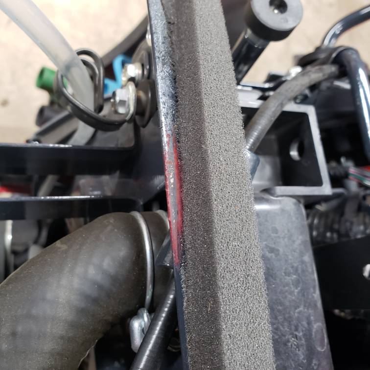

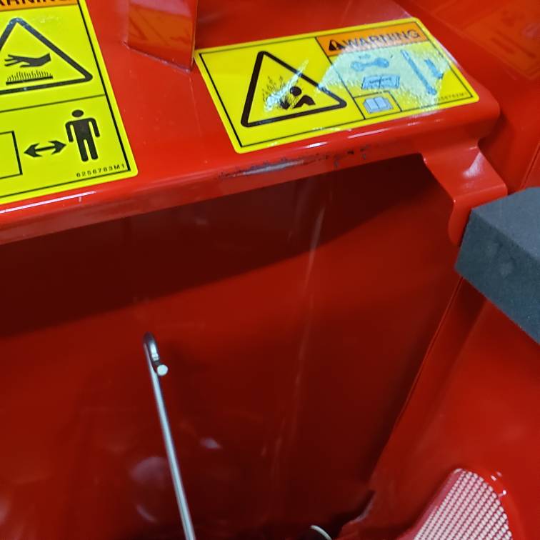

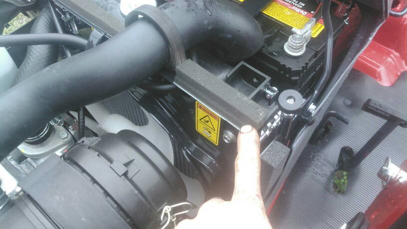

20 hours on the clock.
My tractor is vibrating so much at idle that the hood shakes a lot and has been rubbing through the paint in some places where it touches the supports. I also think I may have found some wetness around an injector fuel supply line nut.
Anyone else have to tighten their injector fuel lines on these?
It may be nothing but since the tire issue I'm having and this vibration happening again since last season, I'm on alert for every little thing. This rough idle isn't exactly a small thing, though.
My father-in-law remarked that it was pretty bad when I showed him today. 20190427_230904.jpg20190427_230839.jpg20190427_230506.jpg20190427_230843.jpg20190427_231345.jpg
