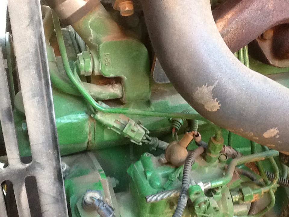

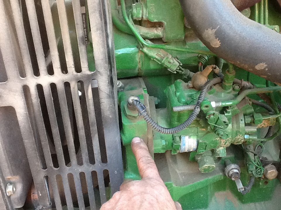

By looking at your pictures, it appears that your fuel filter is original. It is painted green which is how they come from the factory. Not sure how old the tractor is or how many hours is on it, but I would definitely start with changing your filter. There is probably a smaller in-line filter that should be changed as well. In your earlier picture of the injection pump, The green connector above the injection pump is the connector for the cold start sensor. Follow it up to the thermostat housing to find the sensor. It is barely visible in your photo. It appears that it is connected so I doubt it is your problem..

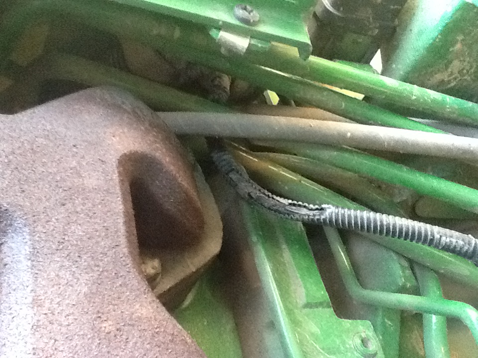

There's what your talking about in the first picture I think there in that order I'll see when I post. I unplugged it and pushed back together to make sure it's getting contact. The second picture I do not know what it does but when I followed it back it was touching the maifold and it melted the wire loom off and the two wires are burnt and hard. Not burned into but hard.

2nd photo of yours is sensor for speed-hour meter(tachometer) RE60021 FILTER ELEMENT, ELEMENT,FL FILTER,S ADD 21.97 USD & AL153517 FUEL FILTER, PRE-FUEL FILTER ADD 33.43 USD(parts key 5) With electric transfer pump(parts key 7) bleeding air out of fuel filter should be very easy.
