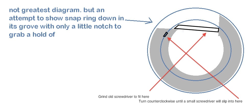

What some people are missing is that this is an INTERNAL snap ring. It won't come out by expanding it. :)
Using the OP's diagram in post 10, I added some arrows and text showing how I have removed this type of ring.
Bruce

never did get the snap ring out. i got to budge with the one tool were i could almost get something in behind it. then i fudged the one good pry end of the snap ring i need to get the snap ring out.
here in a bit will be ordering entire piece (pto casing), pto rod, 2 gears, and a drive shaft out to the pulley for the belly mower. i saw 3 last week, 2 on ebay, and 1 i think i craiglist. will just order entire thing. and be done with it. tired of fighting it. will work on it this winter. after i get other entire rear end, on tractor and grass mowed. grass is getting about knee high now.
and to note it, the one tool almost got me to your image BCP, but just would not give it up, so close, so so close, and then fudge the pry snap ring were i could pry.

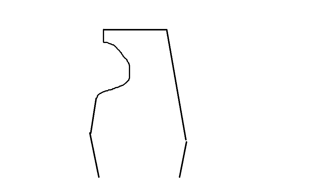

For those snap rings I use a flathead screwdriver specially ground. And it needs to be a larger, and higher quality screwdriver. Guys that work on automatic transmissions know all about them snaprings.
The screwdriver will look like this
