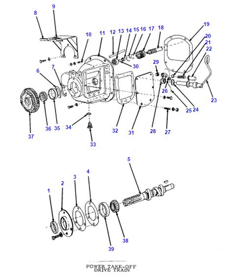

i need to remove PTO shaft #5 from gear #37, main issue is #7 snap ring. ((see below link)) once i get these out of the way. i can get to belt pulley shaft, and tear it apart, find what all needs to be replaced.

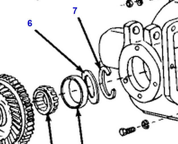

#7 snap ring / retaining ring / circlip

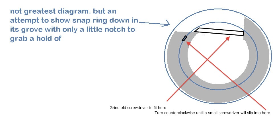

it is an internal snap ring. (no holes for regular snap ring pliers *big frown*) one end = a 45 degree notch. i have not figured out anything that i can use to get in behind of the little edge. and pry out the snap ring from the grove. i have searched internet everything is for "with holes" not without holes. and if without holes, it = only installing not removing them *arghs*
i have used various screw drivers, metal filler end, that i grinded down with a little notching. but so far all the metal i have on hand. bends before i can barely get the snap ring to budge. (not enough to get anything behind it. to pry it out).

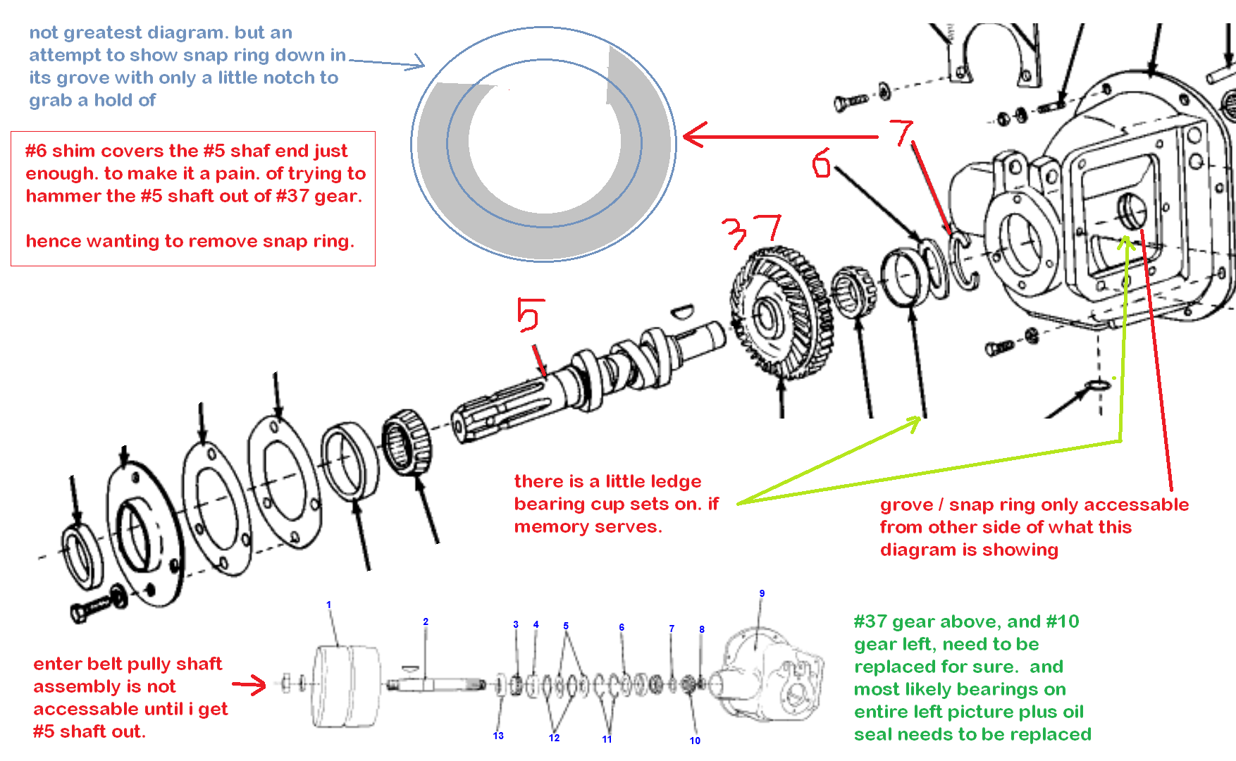

i am a bit un-easy drilling a "hole" into the main casting / pto body. near the snap so as to create a spot to pry the snap ring out. the snap ring holds the bearing in place. and any place i might get a drill bit into. is rather very ugly spot to drill into. and would be afraid of weakening things. to point of hooking up say a rotatory cutter or post hold digger, or other equipment. and run pto internal shaft right into the transmission.
i see comments in internet searching as a "one use only snap ring" assuming folks giving up and just grinding as much as possible of the snap ring out with a dremal. and buying a replacement snap ring.
going to need to find a "slide hammer" or something. to nock #5 PTO shaft. out of gear #37 (to get past the key in the PTO shaft). i had to replace the PTO shaft a few years back. due to cracking in half. and i had to use some rather hefty hits of a regular sledge hammer to nock everything together.

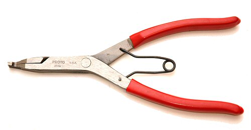

I had a snap ring like that with no holes and 45 deg cut a few weeks ago. It was in a spot very difficult to reach. I was able to use these pliers to get the clip open enough to use a long skinny small flat screwdriver to pop it off.
Snap Ring Pliers with Interchangeable Heads
It did take several tries and some bad language, but I finally got it off. After you play with the pliers a bit, you will get the hang of opening the clip, trick for me was getting in the screwdriver in without letting it pop back in place. Maybe somebody will have a better plan.

This is the tool to remove it.

Here's some screen shots of the snap ring... hope that helps with suggestions. Part #7 is what the O.P. is looking to remove.
/ problems removing snap ring / circlip / retaining ring #8
It looks like you'd have to remove all that other stuff before it to get to that snap ring to open it to get it off the shaft?

leejohn
a pair of angled needle nose pliers, no go. there is nothing to pry on per say.
mossroad.
shim between bearing cup and snap ring. covers end of PTO shaft, just enough. to make hammering the shaft out rather difficult.
allis chalmers ca pto shaft snap ring.png large exploded diagram. once you click image you may need to click it once or twice to see large picture.

LeeJohn nailed it, I have several Allis tractors and that pair of pliers and a thin screwdriver will take them out with some work.
/ problems removing snap ring / circlip / retaining ring #12
boggen - the tool that leejohn shows is what I have and exactly what you need.
The jaws open when you squeeze the handles to expand the ring.
In some cases, the trick is that you don't want to remove that snap ring - you just need to expand it enough to get it out of the groove in the shaft.
Then you should be able to slide the rear cover off, over the end of the shaft, or slide the shaft out from under the snap ring.
I had to do a similar job to take a manual gearbox apart on an old Volvo - that's when I bought those pliers.
Took me awhile to figure out that the dang ring wasn't coming off without something getting broken, but if I could get it out of the slot, all the gears & the shaft would come sliding off under their own weight (like a freight train that's run out of track & onto the concrete floor)!
You should be able to get those pliers at NAPA or similar - worth a try?

What some people are missing is that this is an INTERNAL snap ring. It won't come out by expanding it. :)
Using the OP's diagram in post 10, I added some arrows and text showing how I have removed this type of ring.

never did get the snap ring out. i got to budge with the one tool were i could almost get something in behind it. then i fudged the one good pry end of the snap ring i need to get the snap ring out.
here in a bit will be ordering entire piece (pto casing), pto rod, 2 gears, and a drive shaft out to the pulley for the belly mower. i saw 3 last week, 2 on ebay, and 1 i think i craiglist. will just order entire thing. and be done with it. tired of fighting it. will work on it this winter. after i get other entire rear end, on tractor and grass mowed. grass is getting about knee high now.
and to note it, the one tool almost got me to your image BCP, but just would not give it up, so close, so so close, and then fudge the pry snap ring were i could pry.

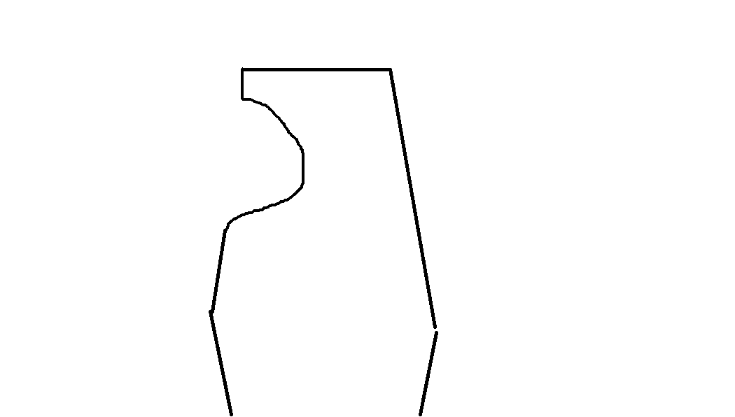

For those snap rings I use a flathead screwdriver specially ground. And it needs to be a larger, and higher quality screwdriver. Guys that work on automatic transmissions know all about them snaprings.
The screwdriver will look like this
