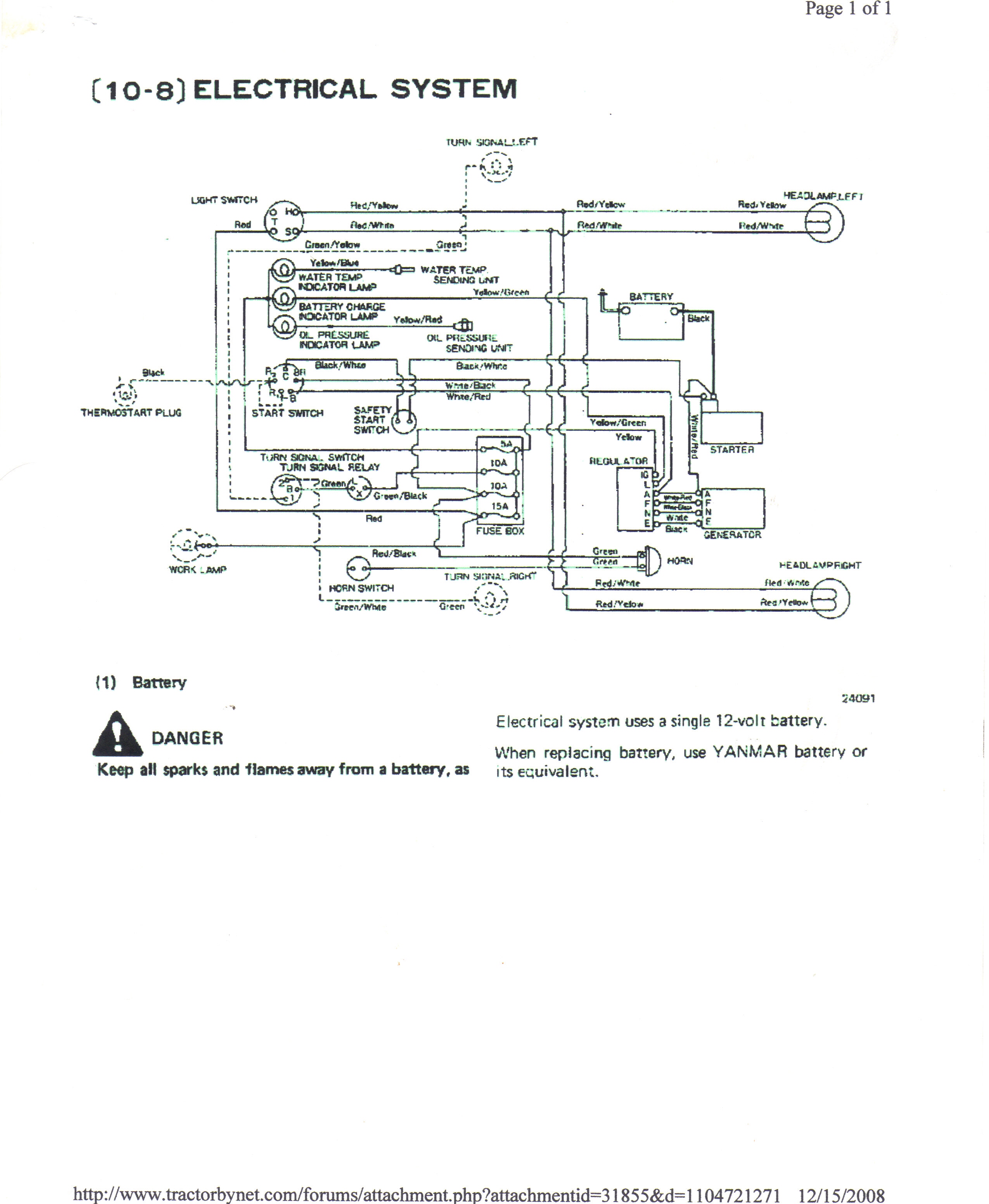

This should come in handy. Oh! forgot to mention I'm in Walton co. ;)

Great, I went through Walton county yesterday going to see family. I grew up in Snellville. Its alot differnet now than it was back then. Came to the country 12 years ago, best thing, for me, that I ever did. Diagram will definitely come in handy. Thanks. So I took the battery to the local big chain auto parts store. They tested and charged it for free. Suggested that I bring my starter and alternator to be tested and I did. Starter tested out to be ok. When I removed the starter I found a loose connection< guess I missed it, easy to fix right. Wrong, the nut that the wires connect to was cross threaded. So I destroyed half the threads to get the starter off. Anyway I made a field expedient repair and seem to be ok. Will have to get the starter rebuilt in the future. Definitely getting good connection now. The alternator failed, but failed on the voltage regulator. Isnt the volt reg separate? Anyway I brought it all home and re-assembled. Of course when I got it running this am I moved it into the sun, anyway she started up. I rode around again. No problems. I guess I am just going to have to stay after it and work the kinks out. I need her to be reliable. If my alternator is bad wont it shut off if I remove the pos battery cable? I know it works on gas engines. I tried it and it kept on running.
/ Problems starting YM 1700 #10
I moved to Snell. in the late 70's. 5th. House built in Summit chase. The Golf course wasn't even complete yet. And S.Gwinnett. 3 hallways. with only breeze ways in between them. LM_ O. On your Regulater it's to the R. next to the ignition switch in the dash. There is A Solid State available now thats fairly reasonable. Check the Fuse links on your fuse panel. When I first bought my 2000 my Alt. Light would irratticly come on. Trying to resolve my Chrg. prob. found out I have both reg. old style and new SS. When I had Adv.Auto check the Alt.and Reg. everything showed to be good;) Finally found it. Bad Wire connection on the back of theFuse panel. That would be the least of my worries. You only use the battery for Starting and Lights :cool:
Nothing you do in the electrical system will shut off the engine. On these early diesels, the electrics are purely to maintain the starting battery plus run headlights etc. There isn't even an electric fuel shutoff solenoid. As soon as you quit cranking, the electric system is completely unrelated to the engine.
If you meant the alternator should quit sending current if there is no battery - I don't think so. Somewhere in the manuals it says leave the key off if you don't have a battery in the tractor and start it by jumpers or towing. So I interpret that to mean that current is generated whenever the key is on and the alternator is turning. The voltage regulator is a tin box on the firewall behind the steering column. (Or if it has been replaced, then smaller and potted in plastic).
if you haven't found this by reading old posts here: YM1700, YM2000, YM240 use the same alternator and regulator as '70~73 Datsun (Nissan). Tell Autozone to set their tester for '72 Datsun. Datsun-spec parts are a direct replacement if you need to replace either/both. But test your components thoroughly first.
