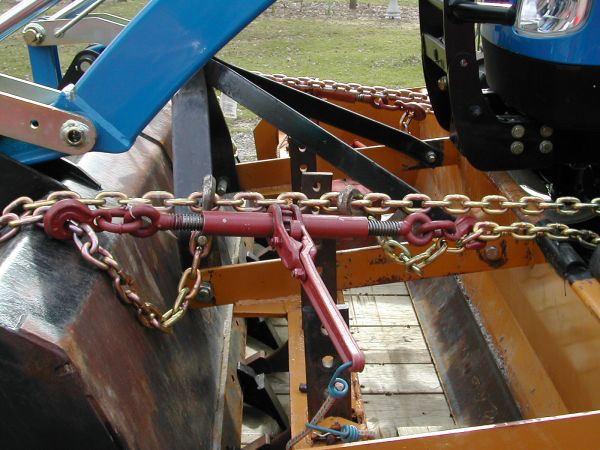

There appear to be a couple folks using Grade 43 chain, and I'm not trying to pick on anyone in particular, but I want to point out that just because a chain is rated for a specific weight, does not mean it can come close to dealing with the shock effect that a moving load can impart onto the chain. Take a 4000 pound tractor, slam on the brakes at 55mph and the rear chains are going to take a good shock, that shock is likely to be equal to something that is substantially more than 4000 pounds and will very likely exceed the working load limit of your chain by a wide margin. Take a potholed road and a trailer that bounces the tractor and you have the same effect. The shock load is something that is far different than the working load and is something you are not considering.

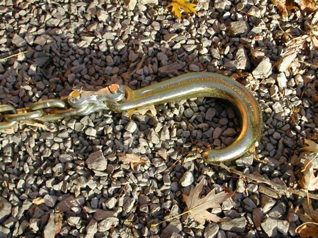

HighBeam; Unless you're using Gr70 chains and appropriate binders, please keep away from myself and family when on the road. I'm no metallurgist, but if I'm not mistaken, that Gr43 chain will stretch where Gr70 won't, thereby increasing the shock load our your rear tiedowns if you have to stop fast.
On that same note, I don't use my ratchet binders on the rear chains. Binders I have are rated below the chain WLL whuch I think most are. I use the binders on the front 2 chains. I'll load machine, wrap my chains [2] around the rear axle, then move tractor forward until they're tight. Then hook my front axle with J Hooks, run my chain thru the Drings, then use my ratchet binders to lash it all down. Machine with FEL and BB weigh around 5500#, I'm using Gr70 3/8" chain and appropriate binders.
Oh, I also suggest US made for the same reasons as Dargo.

The Gr70 Jhooks
