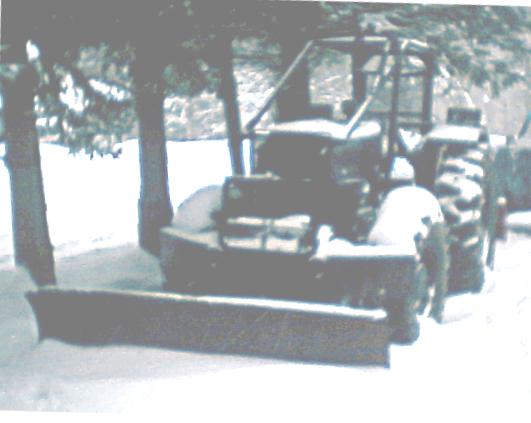

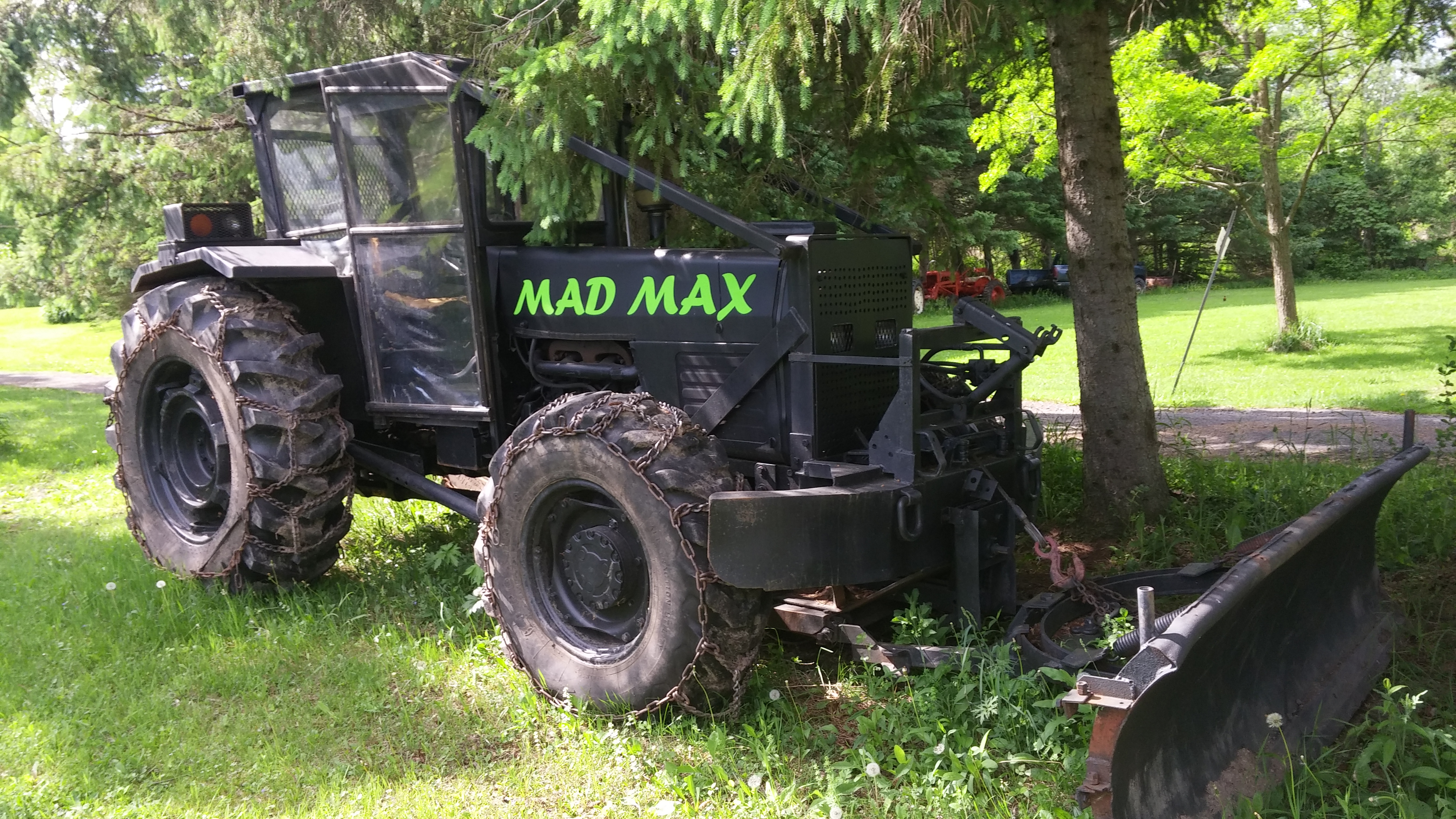

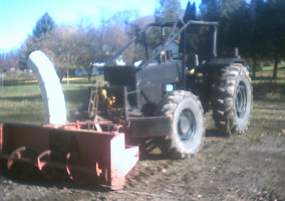

I set up Max to mount the blower on either front or back as in the photos . I found the front mount works great but we don't get those big snowfalls often enough to need the front blower and it is much faster to just use my plow truck with side wings if the snow is not over about a foot, so I just mount the blower on the back of the tractor and it's immediately available if we do get dumped on and the 9 ft blade is available for pushing over the banks on my large parking area (about 50 x 75) where the blower is not ideal to use. My driveway is only 350 ft and might think differently if it was as long as yours. The one photo is Max before the panels are removed and he gets his summer bushhog. max front blade.jpgView attachment 676908max front.jpg

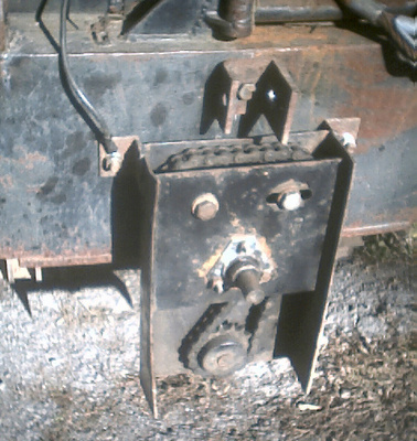

I had thought about going the hydraulic route but found this reverser about 30 miles from where my niece lives up in Quebec for $100. The economics where were about 15 to in favor of the reverser even though there was more fabrication required. If interested, this is a link to how I did it. https://www.tractorbynet.com/forums/build-yourself/187397-max-snow-beast-finished.html?highlight=004.bmp.jpg

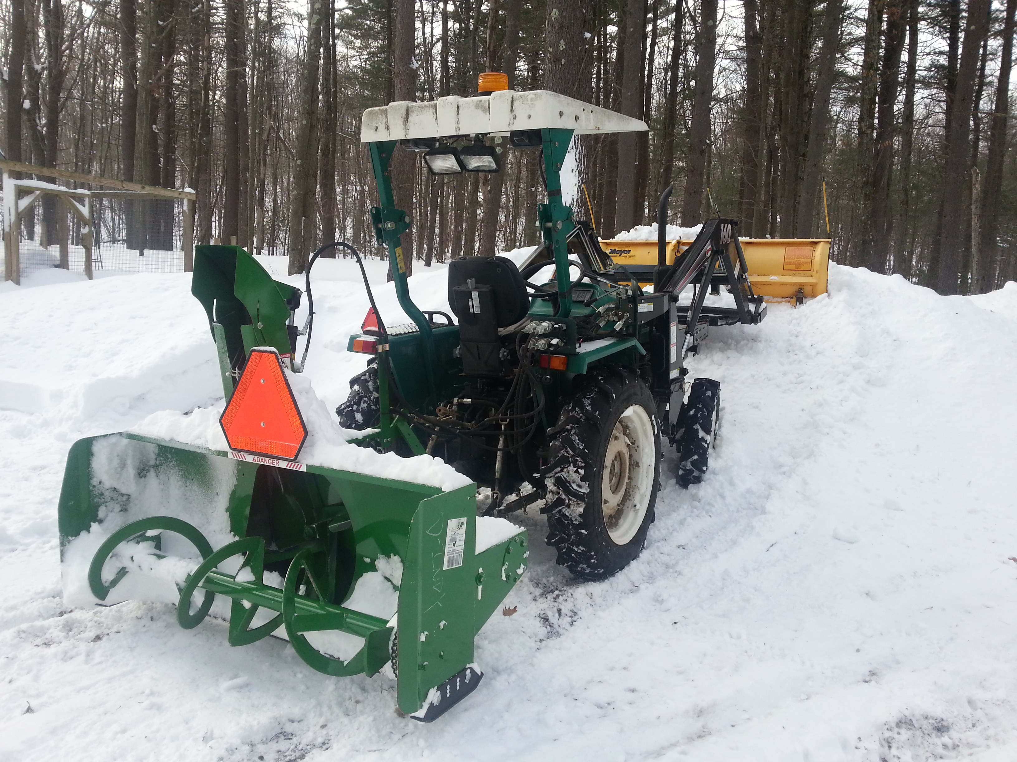

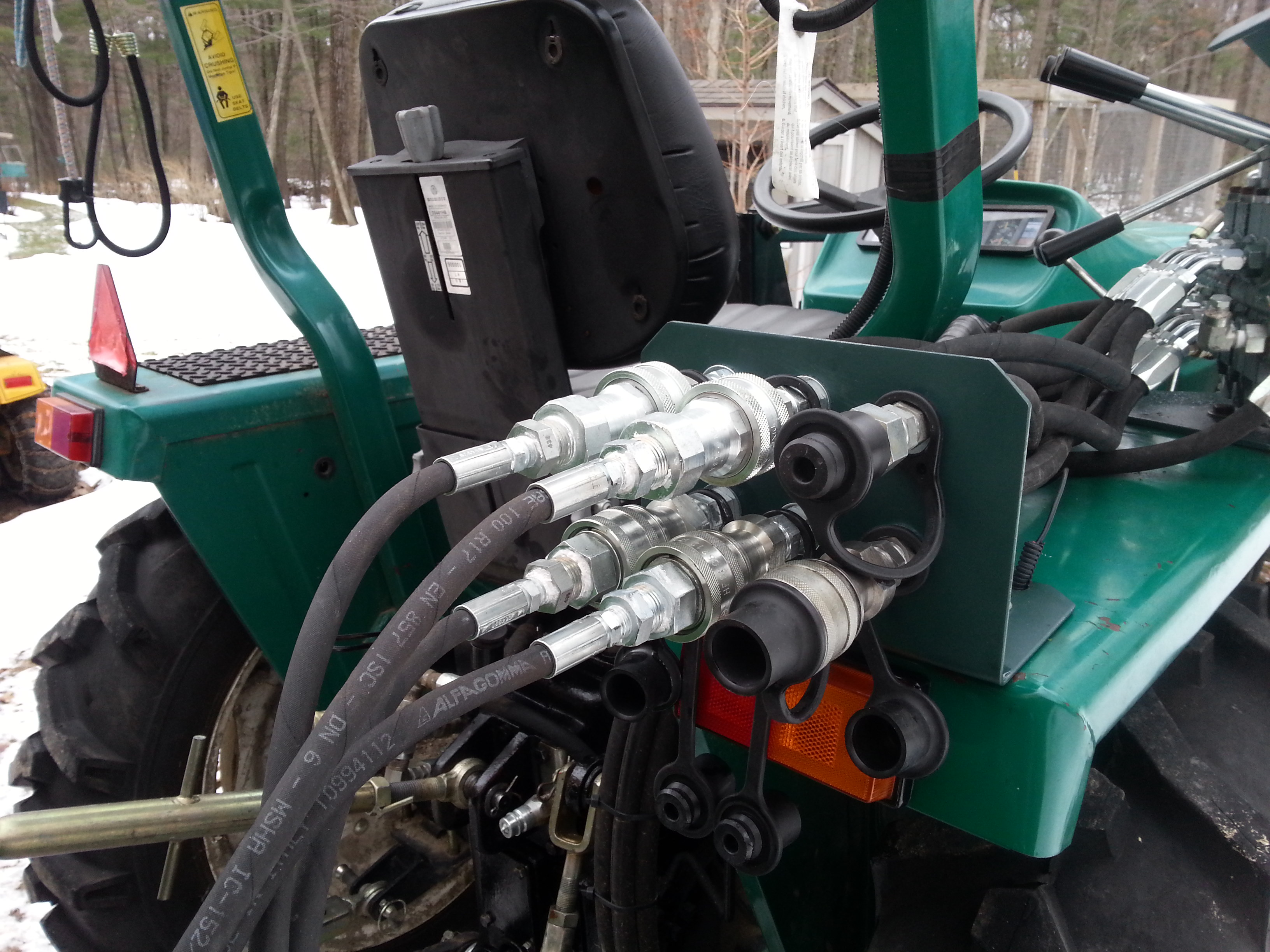

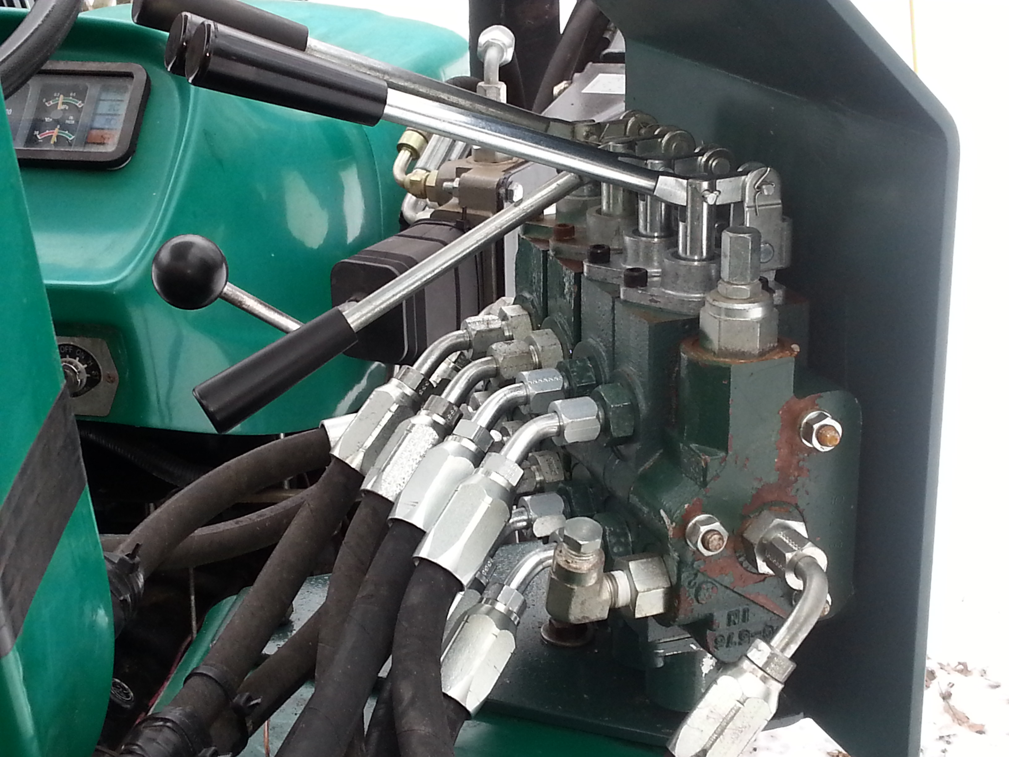

For my needs, this is the best of both for different snow conditions, accumulation, etc. Having the ability to pile up snow 6-8' is convenient, too. By adding more functions and QD's, I can curl, dump, and angle the plow as well as control the blower chute rotation & angle.
