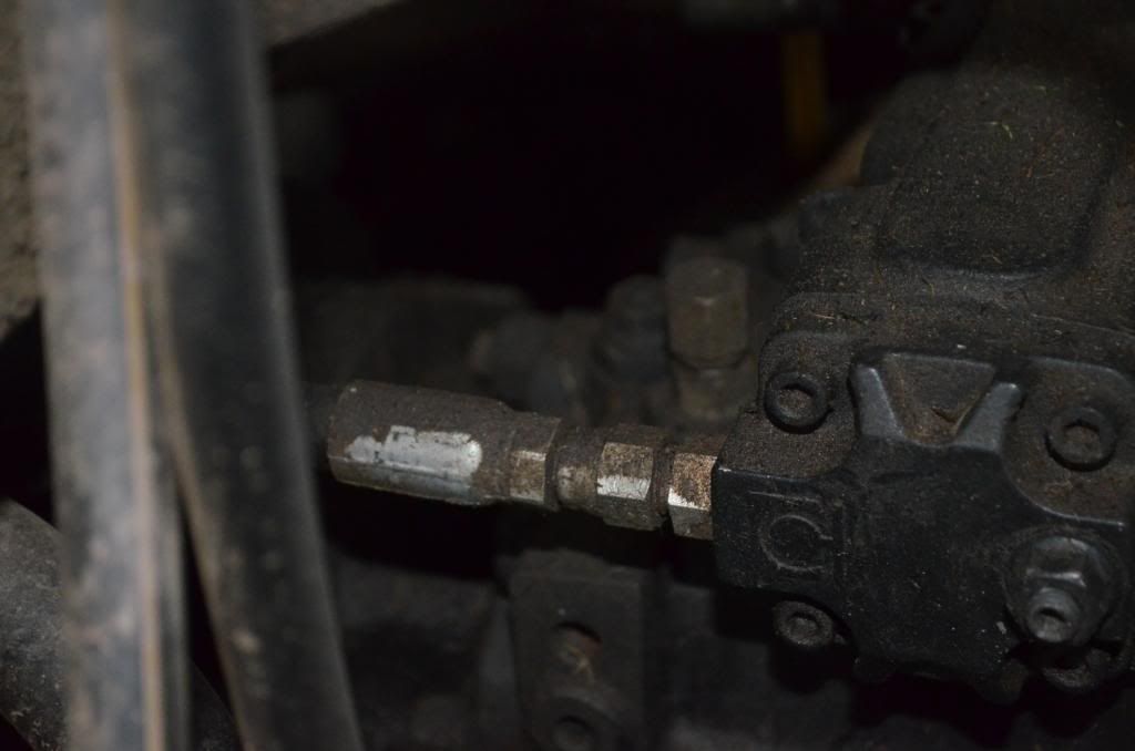

I am having problems, but the problem isn't the engine bogging down. It just doesn't go. Engine stays at full RPM, and the fluid blows by the swash plate. (I guess) Doesn't matter whether it is fully mashed down, halfway mashed down, or 1/4 mashed down. Does the same thing.
   / PT 1460 traction #34
OK here are some pics of the tram pump. Very hard to photograph.
The first one is looking in from the right side. The adjustment on the right controls the creep. Clockwise makes it creep forward, CCW reverse. A simple wrench and Allen key is all you need to adjust. The adjustment on the left has something to do with the swash plate control from the treadle, maybe controls the maximum swashplate deflection?
This next photo is from the left side, there is another adjustment for the treadle swashplate control. I believe that this one is reverse, and the other is forward. There are two other adjustments that are hard to see. One on top just to the left of the the brass test port, and one on the back of the pump. That is all the adjustments I see on this pump.

I wonder if your maintaining pressure when you mash it down going up hill. Starting to sound as though either pump isn't or the wheel motors can't.
Pretty sure that the tram pump is not developing enough pressure in the forward direction. Acoording to PT, the motor should stall before the tram pump gives up. Everything works fine in reverse, so I doubt it is the wheel motors.
Now, if we could only figure out which adjustments to make on the tram pump.........
