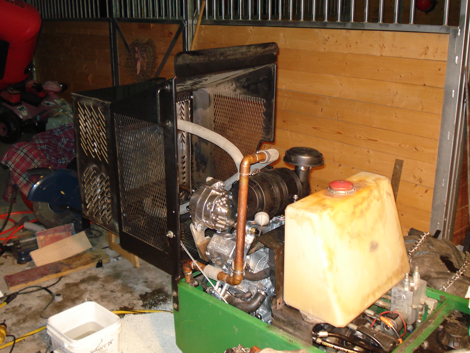

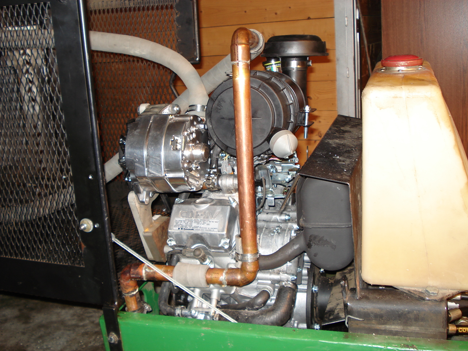

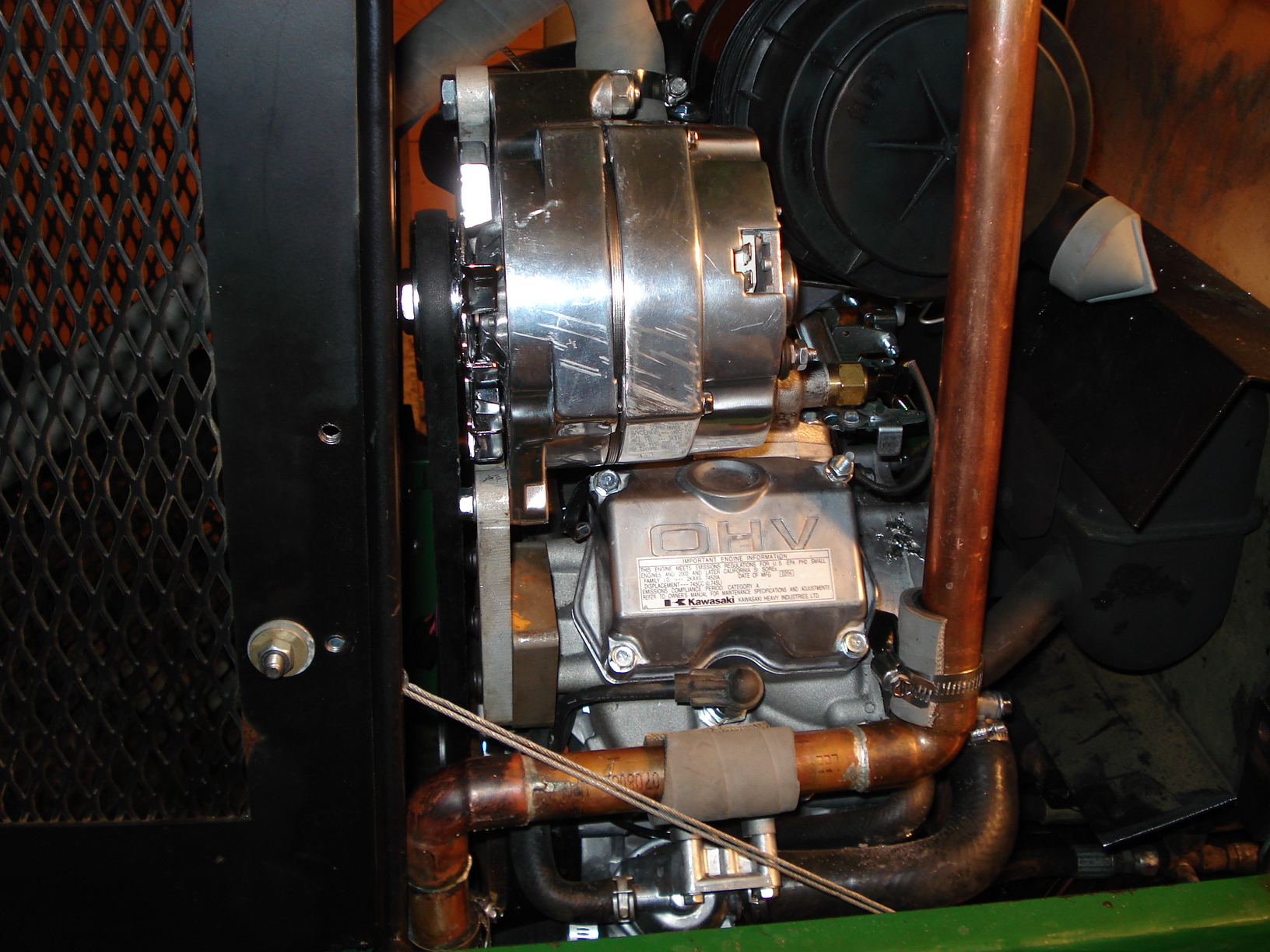

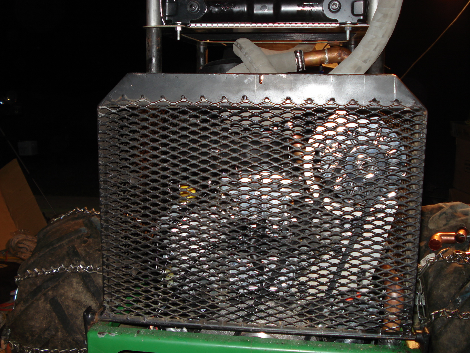

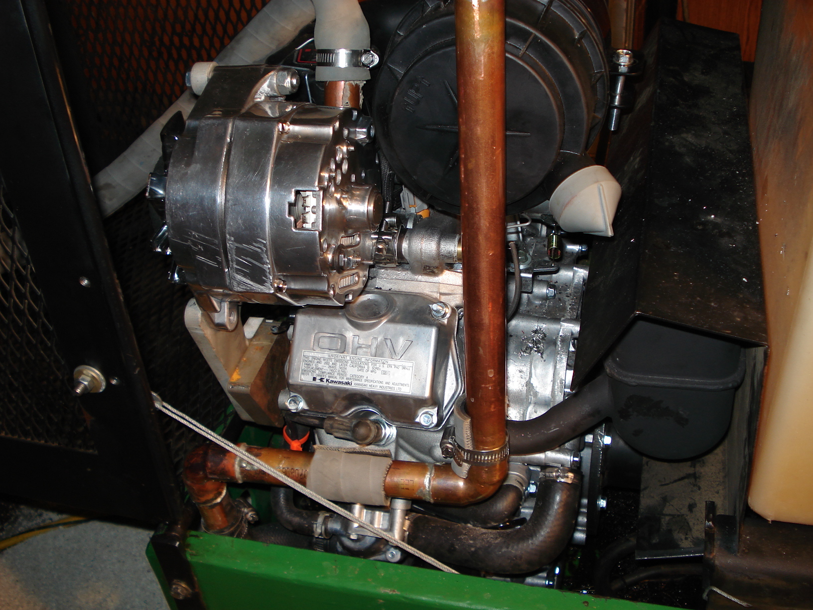

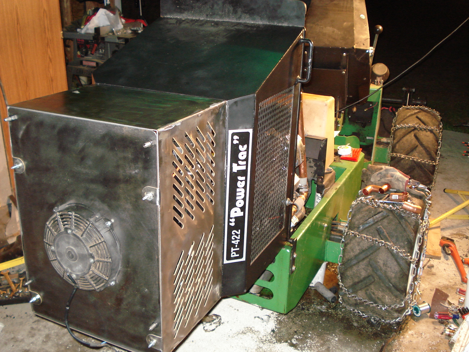

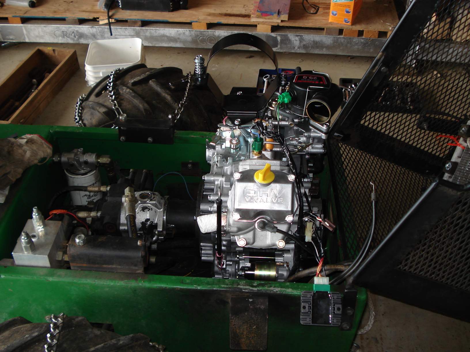

PT 422 Mod to kawi 29HP FD791

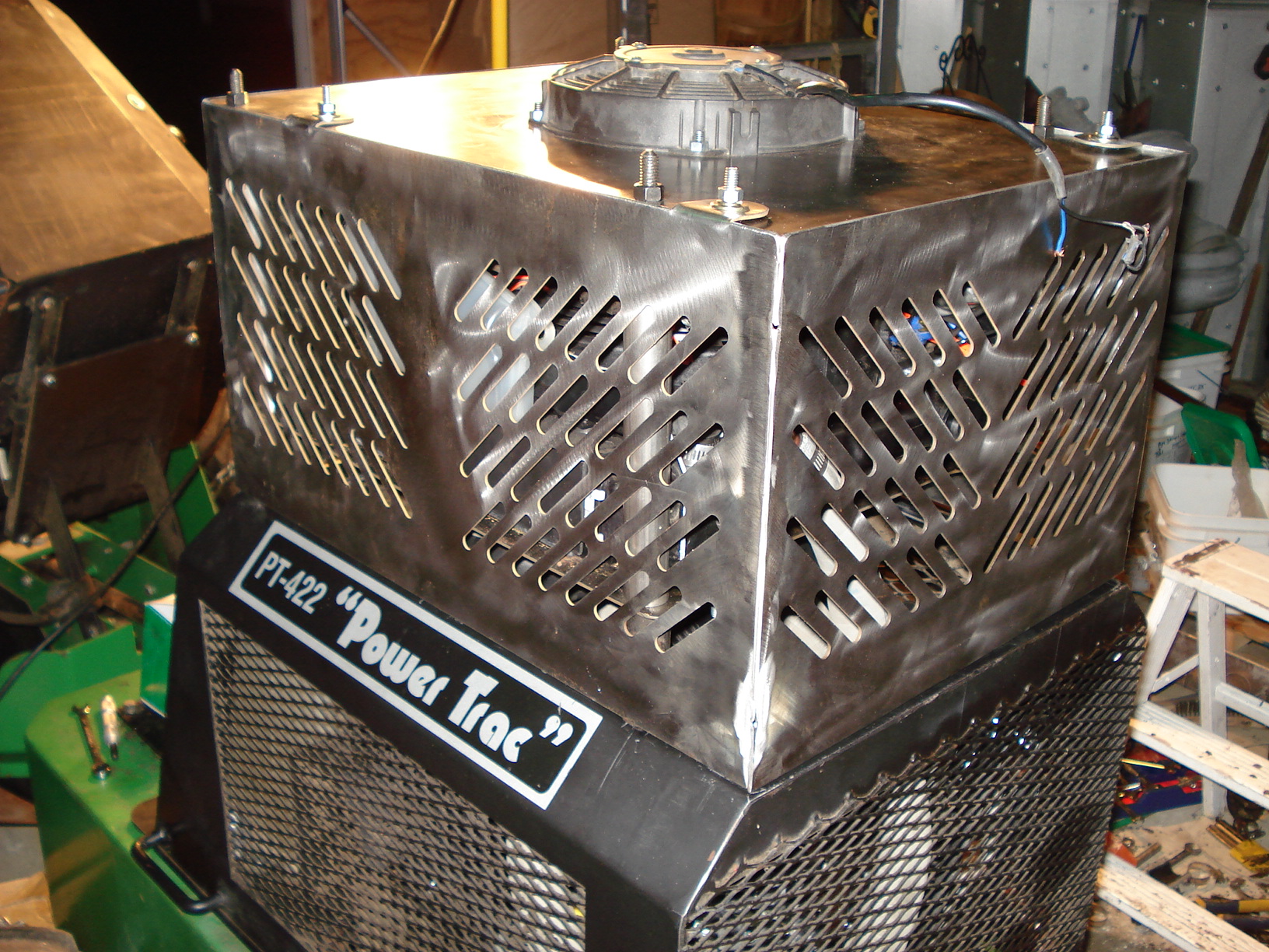

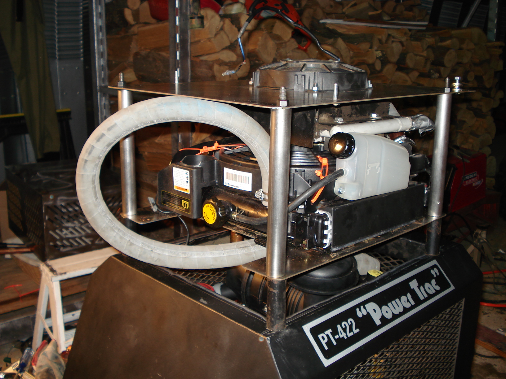

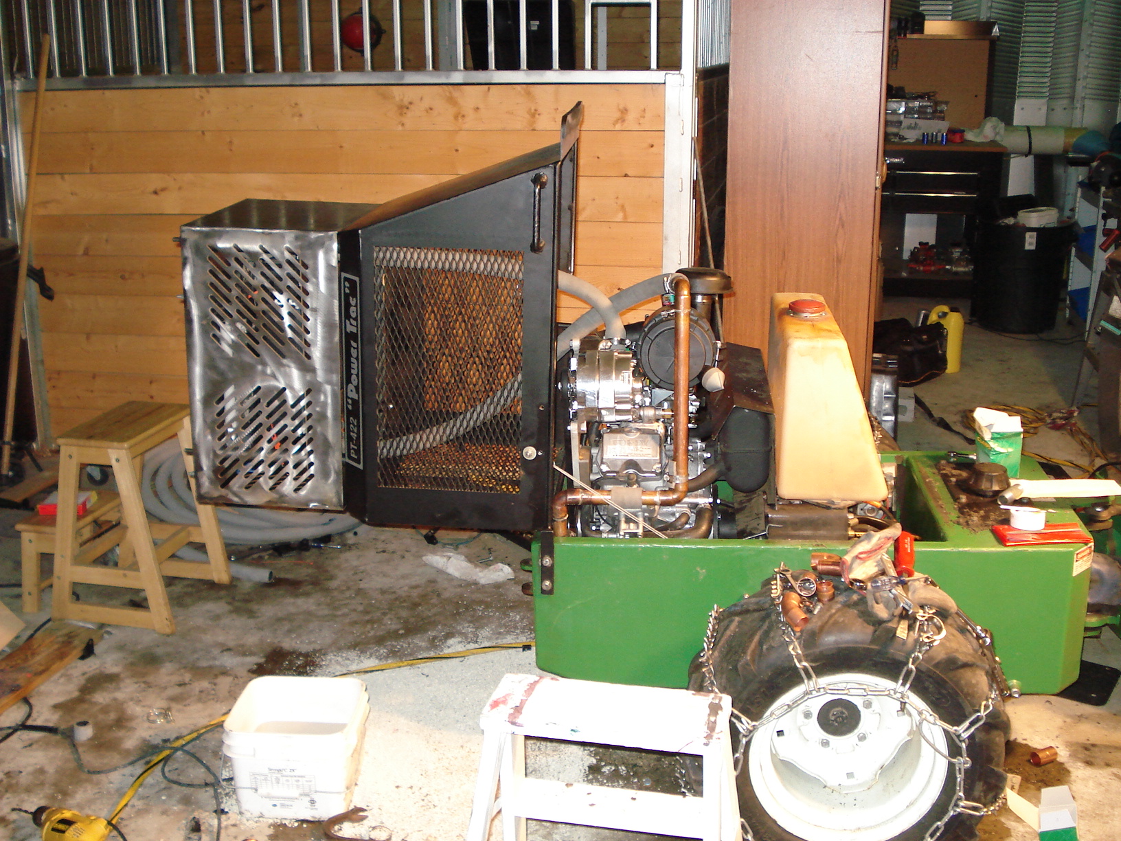

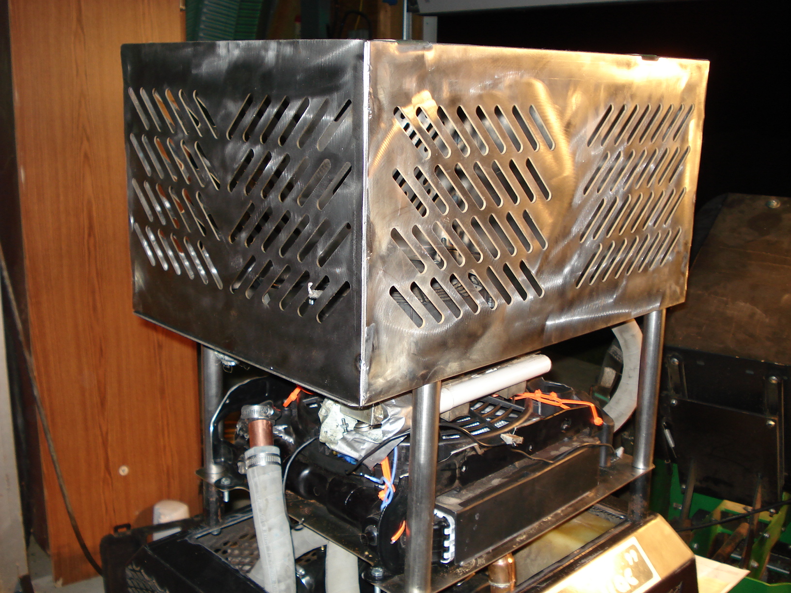

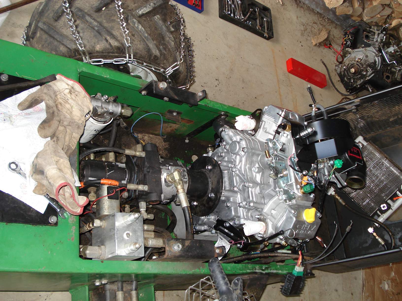

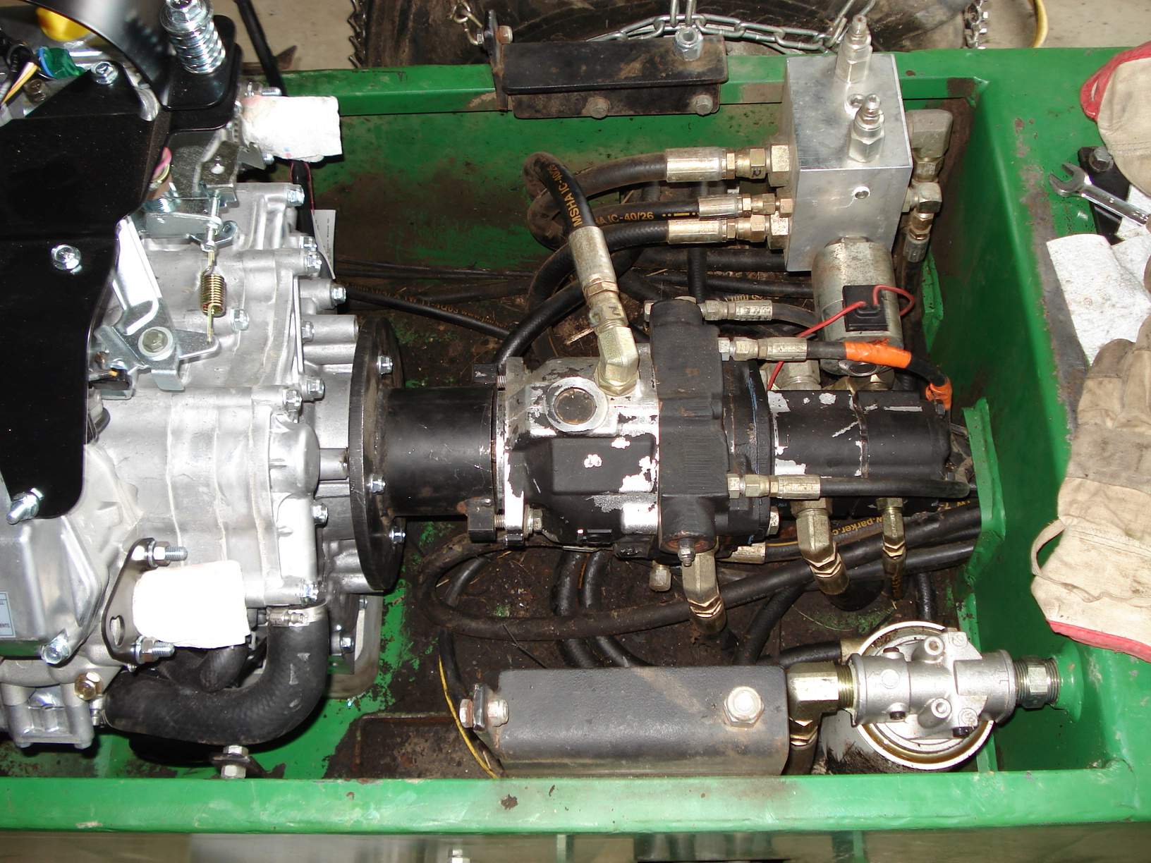

Okay here are a few random at beginning middle and almost the end which will hopefully occur this week.
Thanks,
Steve

Wheres your blower? :D

Nice design. I wonder how easy this would be to adapt to my older 422 with the engine between the pumps. (Pumps driven of the front and back of the engine.
/ PT 429 project #4
Man, Steve, that looks GREAT!!! Excellent job making it look like "factory" ....not PT's factory, but one more interested in quality and attention to detail ;-)
You gonna build and sell kits as the rest of us evolve and need engine swaps?
Phil

I just got through going through all the pics. Really nice job, and I hope it runs as well as it looks.
Congrats.

Maybe I could move the engine to the back of the vehicle and thereby give better weight balance. I had not thought of that.
/ PT 429 project #8
Dear Scarg,
This does look great. Did you consider running the cooling hoses on to the engine cover at the hinge, so that they would have a small (well 90 degree) axial twist as you open and shut the cover? It would save you a lot of hose and pipe.
I hope that you end up with all the power and Pizazz that you are hoping for!

FYI - Below is email I just sent to Terry at PT-
When all is up to snuff i will take more pictures and video with sound and upload. Probably be a couple weeks before that happens though.
I am extremely physically and mentally worn out but i wouldn't be right to hold back information from fellow pt owners! Please excuse anything that doesn't make sense-
also The PT429 has a lot of power and adds about 200 pounds over the stock robin 22 - like I said in am physically exhausted but would do it again in a heartbeat. To turn that key with a weak undersized battery designed for an atv at idle speed and have it start instantly is nice.

This is the tractor that I installed a Model fd791d-s01 29HP Kawasaki liquid cooled fuel injected engine.
The engine runs great / starts great even at 15 degrees and fits very nicely and I also installed a 100 amp alternator to power the hyd rad fan and liquid cooled radiator aftermarket fan (not enough room to leave the original kawi with belt driven fan i.e. I hand to relocate these items under a top mounted cage. Have not connected the fans yet which will be run by the alternator which is used for all but charging battery. I should be able to put some pretty bright lights on it in the future. The hoses fold into correct position when the cage side is installed with no kinks. A36 carbon steel plate cut with cnc abrasive water jet at our factory. Mechanically everything went together perfect and only took me and another guy about 1 hour to physically install and connect to hyd pump. All the easy stuff was a nightmare the the complicated stuff went perfectly.

1. wiring mistake I had to purchase to new ignition coils (which a local john deere cross referenced and they were purchased under a john deere part number and the boxes and coils were Kawasaki – interesting huh….I verified resistance to oem spec and they worked great). It was impossible to get the coils using the kawi part numbers in less than 3 days and no junk yards with this engine (I checked with all the area guru’s to no avail) probably have about 10 hours in this one troubleshooting and installing etc….
2. copper tubing solder job leaked in to spots and I had to use super sealant stuff and larger diameter short hose to reseal – probably had 15 hours laying out building and installing plumbing. The grey hoses very robust and tend not to kink and fit perfectly of 1” nominal copper tubing.

I had the fuel tank and heat shield installed and also a heat barrier material (unknown was given to me but did not do the job)
If and only if I can find a way to thermally shield between the exhaust and fuel tank I will use the stock type PT tank and I will test the material much more closely for obvious reasons.
Do you know of any suppliers that would have a thin (3/8” maximum thickness to shield the fuel tank from the exhaust system?)
So the bottom line is the fuel tank started to melt and the stock PT heat shield (with minor material removal and spacers to adjust position slightly).
I used a laser infrared temperature gauge and paid very close attention to the temperatures of the exhaust, heat shield, thermal barrier material, and fuel tank (stock PT).
I don’t recall the temperature at which I determined to shut down the unit (fire extinguisher was present!) FYI fuel level in tank was about 1” and that portion of the fuel tank did not cause concern heat wise.
I immediately killed the engine and some melting occurred to the stock PT fuel tank but did not melt through only pushed it in and I wasn’t concerned about fire once the engine was shut of because it was about 18 degrees F outside and everything quickly cooled down.

PT gas tank is $175 ouch- Therefore I made a 5 gallon tank from 8" sch 40 pvc pipe and mounted it to the back of the original PT cage. I finally got to actually use the tractor today to get my forks at the top of my hill and also move a 700 pound round bale of hay to pick up and dump in horse round feeder- no PT pucker when going with round hay bail either.
The added weight of the heavier engine and top cage and fuel tank probably adds 150 extra pounds directly over the read wheels.
I have a hill behind my house that is maybe 40- 50 degree angle - very steep. The oringal robin subaru 22HP 422 would not climb it (even with not attachments) and i always had to go around the steep part and literally zig zag back and forth (light on the treadle - tried everything just didn't have the power) and slowly it would inch it's way up the hill on the 15 degree section.
Today i drove the PT 429 over to the steepest part of the hill and stopped. Keep in mind i have very agreesive tire chains on all 4 tires.
Okay i am now stopped at the steepest section - At about 3/4 throttle 3600 is max) I mashed the treadle the all four wheels (with wheel chains) were spinning and ripping the ground apart as the full fury of the PT 429 unit was unleashed. I was stunned at how much more power this 29HP Kawasaki has. It's a beast of a machine now.
Low end torque with slow engine rpm is also amazing and as far as how the PT 429 feels it is not just the expected 20-30% increase in torque and horsepower but 1t feels like both low and high end power is 5-10 times over - the robin 22HP enginer maybe more. Starting even at 12 degrees the 429 kawi
Runs awesome and is extremely quite. I need to have some brackets made this week to permanently mount the gas tank paint cage etc... Looks like a 6th grade scienc project right now until brakcts are made.
I obviously have dozens if not a hundred or more hours into this project but i would do it again in a heartbeat.
When i get the 429 completely finished i wll take some more images and maybe a video of the hill climbing to show you all what i mean when i say it has a lot of snot.
I removed the alternator and it's brackets becuase i can run the aftermarket 12 VDC radiator electric easily and i have it on top of the radiator and the hyd radiator directly above it. So the top original PT hyd cooling fan will just be an ornament for now. The amount of air the aftermaret 12 VDC fan moves is incredible. So the old hyd fan it just along for the ride.
As i mentioned before i still have to paint the top cage and it has a very very slight leak on one of the solder joints.
I'll keep you posted as i move forward.
Thanks,
Steve
