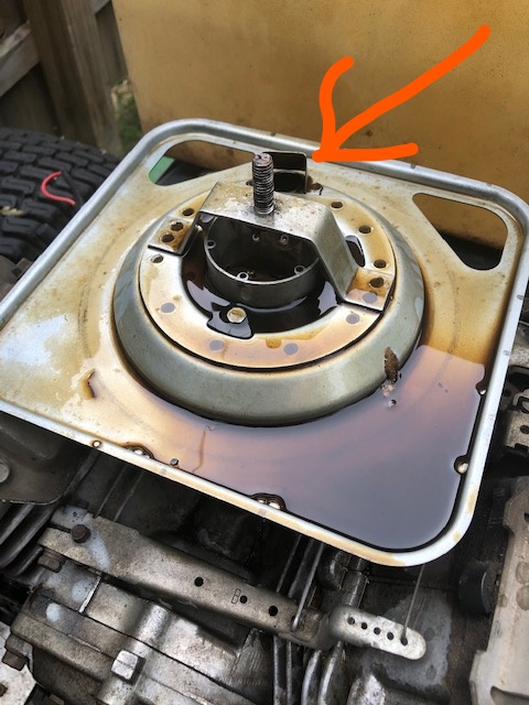

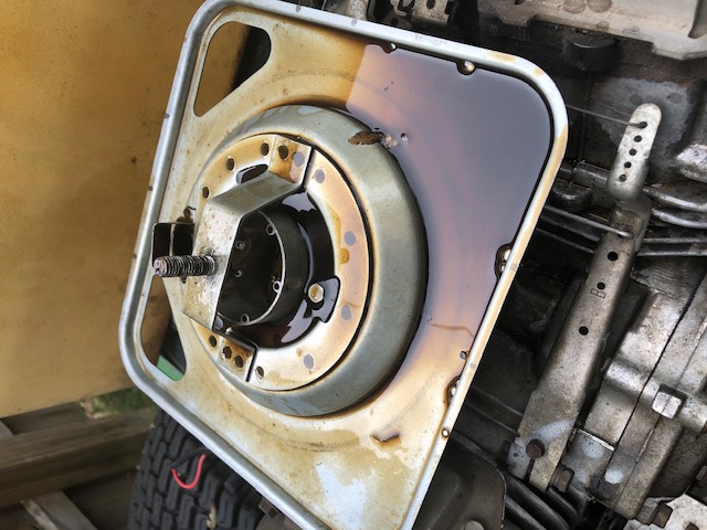

HELP! PT-422 (Robins/Subaru eng.) cranked over and began to run for about 3-5 seconds, stopped running, and as soon as it stopped fluid shot out, like it was REGURGITATING! Out of what I thought was a breather tube (I don't have a schematic for the carb so don't know exactly what that port/tube is). At first I thought the fluid was gas, but turns out to be gas mixed with oil (see pic). I cleaned the fluid up and it did the same thing 2 more times!
Can anyone tell me why fluid is coming out of the port/tube, where it is coming from, and the possible fixed that I may be able to attempt. I appreciate all you PT guys on here, and the help you have always provided me.

Check the level of the oil in the crank case with the dipstick. gas may have leaked into the crank case through the carb. thats where i'd check first. if it did, you'll have to drain the oil, change the filter, and refill with oil.

Yes, breather.

Yes, this could have something to do with your problem.
This Subaru engine is notorious for leaking fuel into the cylinder heads and contaminating the oil (killed my last engine)...I assume, due to the needle value failing to seat. However...this could also be related to the failed fuel solenoid (which, I didn't know the engine had since I haven't been into the carb of my dead engine).
The combination of oil in the gas coming out the breather, but no gas in the oil in the engine makes no sense to me. For example, the oil level would need to be high to get past the oil rings. This usually occurs when the engine case fills up with gas...due to a problem with the needle valve, fuel solenoid, or fuel pump (leaking fuel into the engine case).
Either way, I don't see how you'd have a thin oil/fuel mixture at the breather AND not see or smell any gas on the dipstick.
To move forward, I would shut the fuel off and remove the fuel line from the engine to ensure no more leakage and confirm the shut off valve is working. Then, change the oil and filter. Reattach fuel line and open the shut off valve while cranking the engine. Once the engine starts, let it run a few seconds then shut off the fuel and let the engine die of fuel starvation. Change the oil and filter again...even a very small amount of gas in the oil will change the oil's viscosity.
You've now confirmed the engine is ok, but you don't know the root cause of your problem (assuming to didn't discover something like a failed shutoff valve). I would replace the carb solenoid and give strong consideration to adding another electric fuel shutoff on the fuel line (I just added one to my tractor). If you don't want to go further with the diagnosis, then you have to ensure no fuel can get to the carb when the engine is off. A manual shut off valve isn't good enough because you'll eventually forget to shut it off and potentially ruin the engine.
My two cents.
