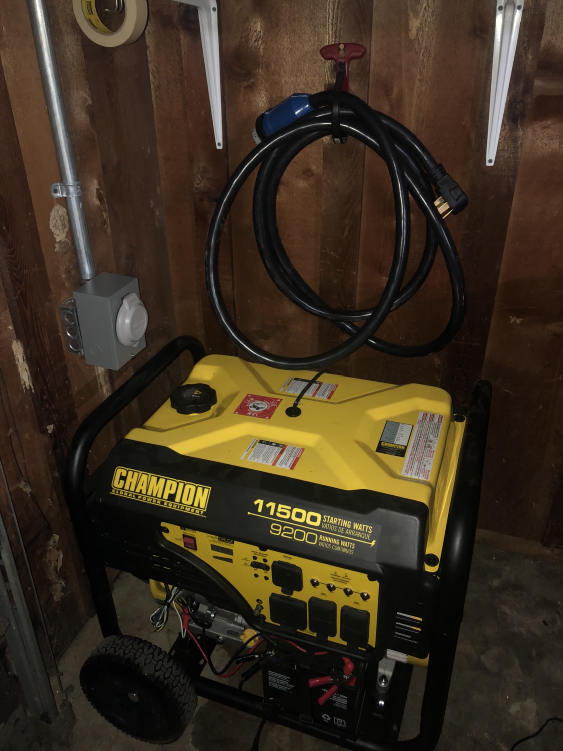

I just recently setup a generator for the house.
Wanted easiest setup for wife or anyone I needed to set it up when I am out of town.
It’s a champion power equipment model 100110 ( 9,200 running watts, 11,500 max watts). I have a interlock switch to prevent the main breaker and generator breaker from being able to be on at the same time.
I am currently keeping 28 gallons of fuel on hand with a full tank ( 7.7 gallons) in the portable generator. It is said to get 10 hours at 50% load on the 7.7 gallons. So I got just under 5 full tanks/ 50 hours of fuel available. I am looking into a 55 gallon drum to store more fuel.
Overall, it’s simple to setup and get on line, runs all but my stove, oven m, dryer and AC. I can run some of the stove but not all.
I don’t want to loose wattage output by converting to LP or NG. Happy with the setup overall. $3,500 at most invested. View attachment 569878
