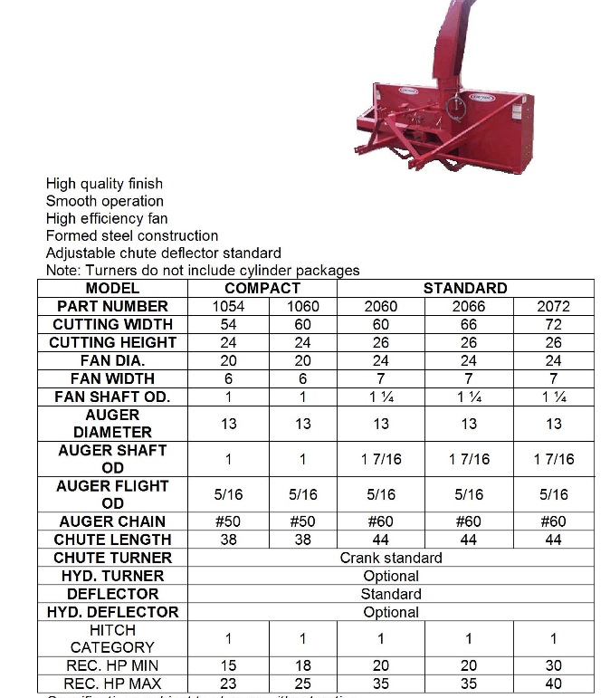

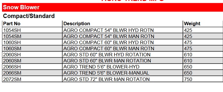

Assuming that everything is working as it should, is it possible the blower is too high for the tractor? When lowering the blower, does the it change angle as soon as you start backing up? Could the blower frame arms be too high, pushing on the 3PT arms, resulting in an upward or downward angle? Without position control, it could easily happen. The 2060 isn't just a wider blower, but also higher. Perhaps a 1054 or 1060 would be a better fit for the SC2400. I have a C-48 on my MF GC2300, similar sized tractor, and have no issues.

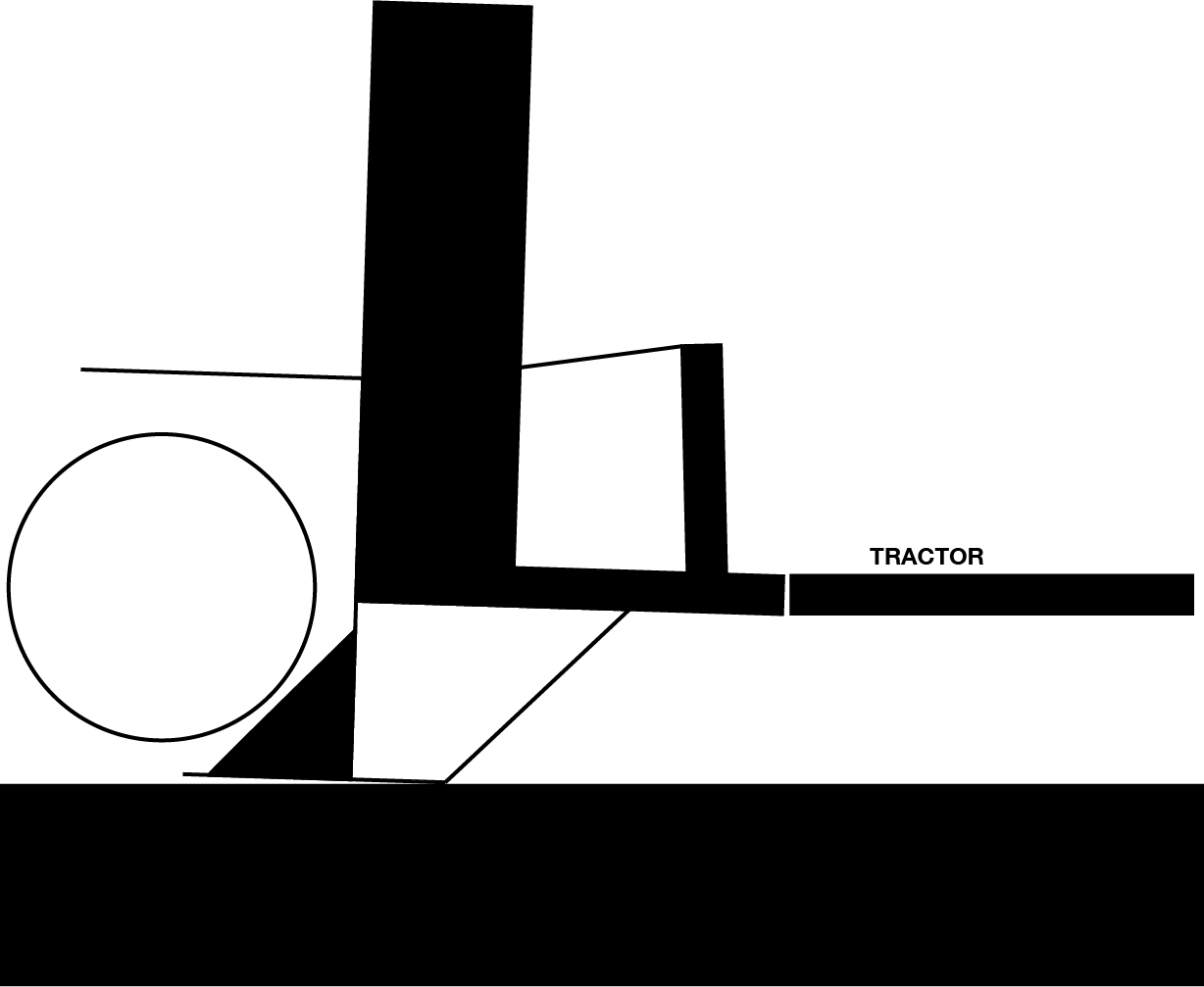

I think you are right. When I drop the 3PH to the lowest position, you can actually see that the blower arms are slightly higher off the ground than the 3PH lower arms. I made this crude diagram to illustrate it. It does actually have enough difference to adjust the angle.
The strange thing to me is that no amount of adjusting the top arm seems to fix the problem. Even when I lengthen the arm enough to make thing appear level when parked, the angle does change immediately upon backing up.

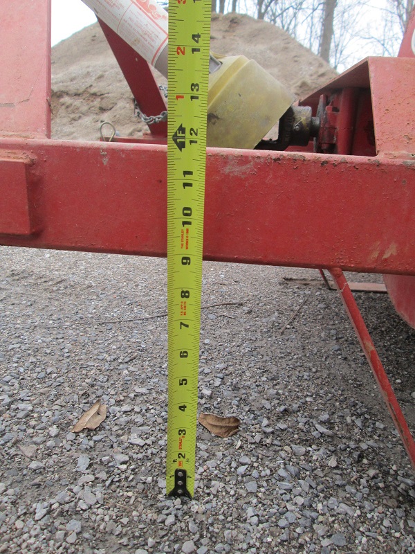

On my Toolcat, the pivot (tractor end) of the lift arms is about 14-15" off the ground and that is the same height as the 3pt pins on the blower. So, my lift arm should be about level with a level blower.
