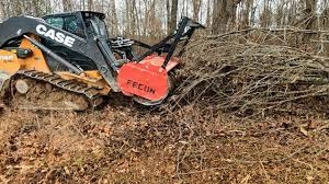

If you are clearing brush and cr@p already on the ground go rent a forestry mulcher with a minimum 100HP CTL or bigger machine. It will be faster and less manual labour than using a chipper.
