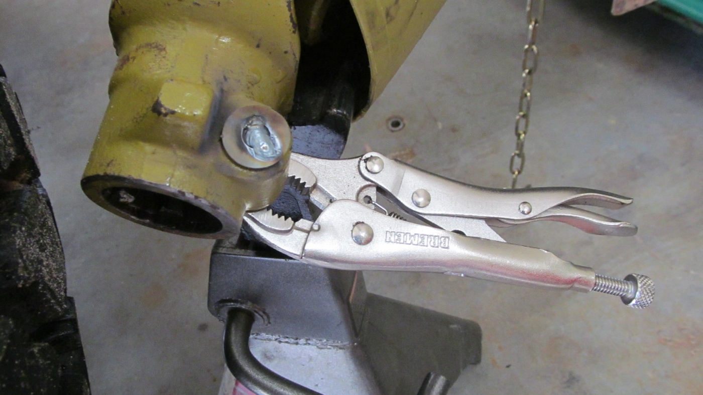

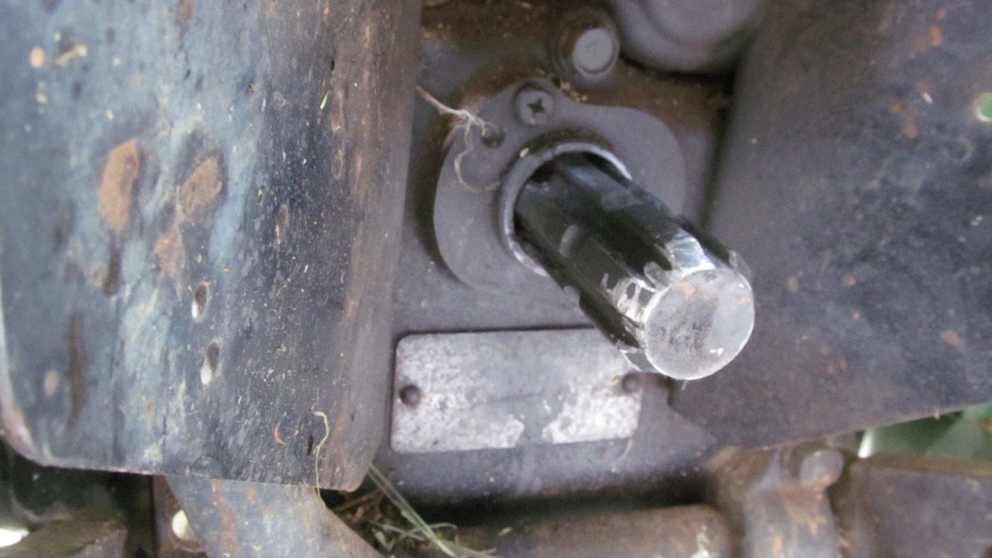

I have just been through the worst battle trying to connect a PTO shaft ever. Part of the problem is my little JD855 locks the output PTO shaft when the the PTO is turned off. That shaft cannot be turned by hand under any circumstances. Connecting my finish mower is usually somewhere between a cinch to very limited frustration getting the shaft connected. Hooking up the mower with the quick hitch is a breeze. I am usually hooking up the finish mower and everything is still where it got turned off at the last use. The other day I used my brush mower and when I tried to reconnect the finish mower it wasn't having it.
I took a hint from the dime in the glove tip I saw in another thread but I decided to weld a flat washer to the button on my yoke instead. This made the button MUCH easier to push and may have weakened the spring a little.
It still would not hint at engaging the splines so I used a saw chain sharpening stone on my dremel and went over all the male spline edges and beveled them slightly. I had previously cleaned, filed and felt everything and didn't see any burrs or anything but after cleaning it all up with the stone the shaft slid on like it was supposed to.

Not sure how you are doing it, but I ignore the lock until the yoke slides on the 1/2 inch or so until the lock hits. Then operate the lock and push the yoke all the way on. Holding the lock "open" while trying to align the splines is too awkward.

I’m thinking when I had my 755 you could put the lever in the mow pto position and then the rear pto could spin freely???

Not really a disparager, BUT. did you park the mower up on wood so that you could spin Shaft without the blades hitting the dirt? If the stub shaft on the tractor wont spin then the shaft on the mower MUST be able to spin. Take a long screwdriver thru the cross if you need to to be able to turn the shaft. Also suspend the heavy shaft with a bungie cord to the A frame so that the weight is not constantly wearing on you as you fiddle with getting the splines lined up.
Like you did the splines must be clean, burr free and lubed and should have a bevel on then to facilitate alignment. I used to struggle with PTO hookup, but after taking some of my own advice and doing it several times, I don't struggle any more.
