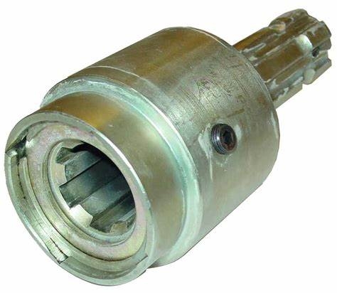

That PTO wrench looks pretty cool.
The tool junkies will want one!
Don't ask me how I know!
