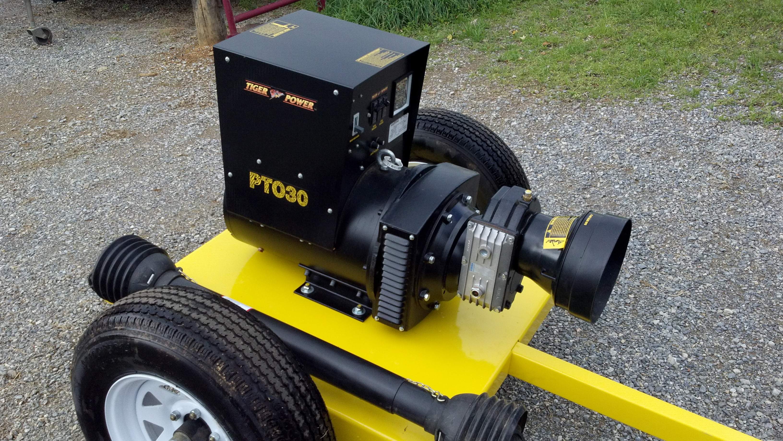

Howdy,
PTO generators come in many styles and sizes. I feel my Tiger Power 30K is overbuilt. I am sure the specs are derated. Since it is a larger generator, it spins internally at 1800rpm, and has LED lites showing the output volts and the amperage draw.
Over the summer, the power was down for 28 hours. (it was hot and humid (98 deg and around 70 dewpoint) Running the whole house, barn, shop, well etc.. Even with the 4 large A/C units running, it was a moderate 17.4kw draw. Yes, I could watch the surge when the large A/C units first kick on, but then levels out. Because of the size of the tractor, and the size of the generator, you would not even know without seeing the gauge. I now the smaller units will show the Hz cycle meter, and the 240 volts meter and that is all. There are some panels out there that have watt meters, and other have installed other types of meters to not only show the watts used, but also watts used per side. You do want to keep the loads per side kinda balanced. But as others have said, you just need to keep an idea about what you have powered. No unit out there likes to be run at 100% capacity. That is like keeping your car in first gear and driving 60mph down the highway. How long will that engine last always running at redline? The same thing can be said about the average house. 200 amps is a lot of power. Have you ever had every single light on, stove on, washer on, pump on, hot water on, dryer on, A/C on, coffe pot, microwave, all TV's, stereo, garage doors, a 15amp vacuum running in each room, more or less every single circuit full use capacity? Probaly will not be as much power as expected. You would be lucky to get to around 70% capacity of your panel. This is also why a load calculation is important to know what you can run and can't when when on auxiliary power. Large electric motors have a high starting wattage and then level off when running. That is why all generators have a surge rating to help offset those types of motor surges.
Buying advice = a lot of times the next size up is not all that expensive. Think about future use and growth.
