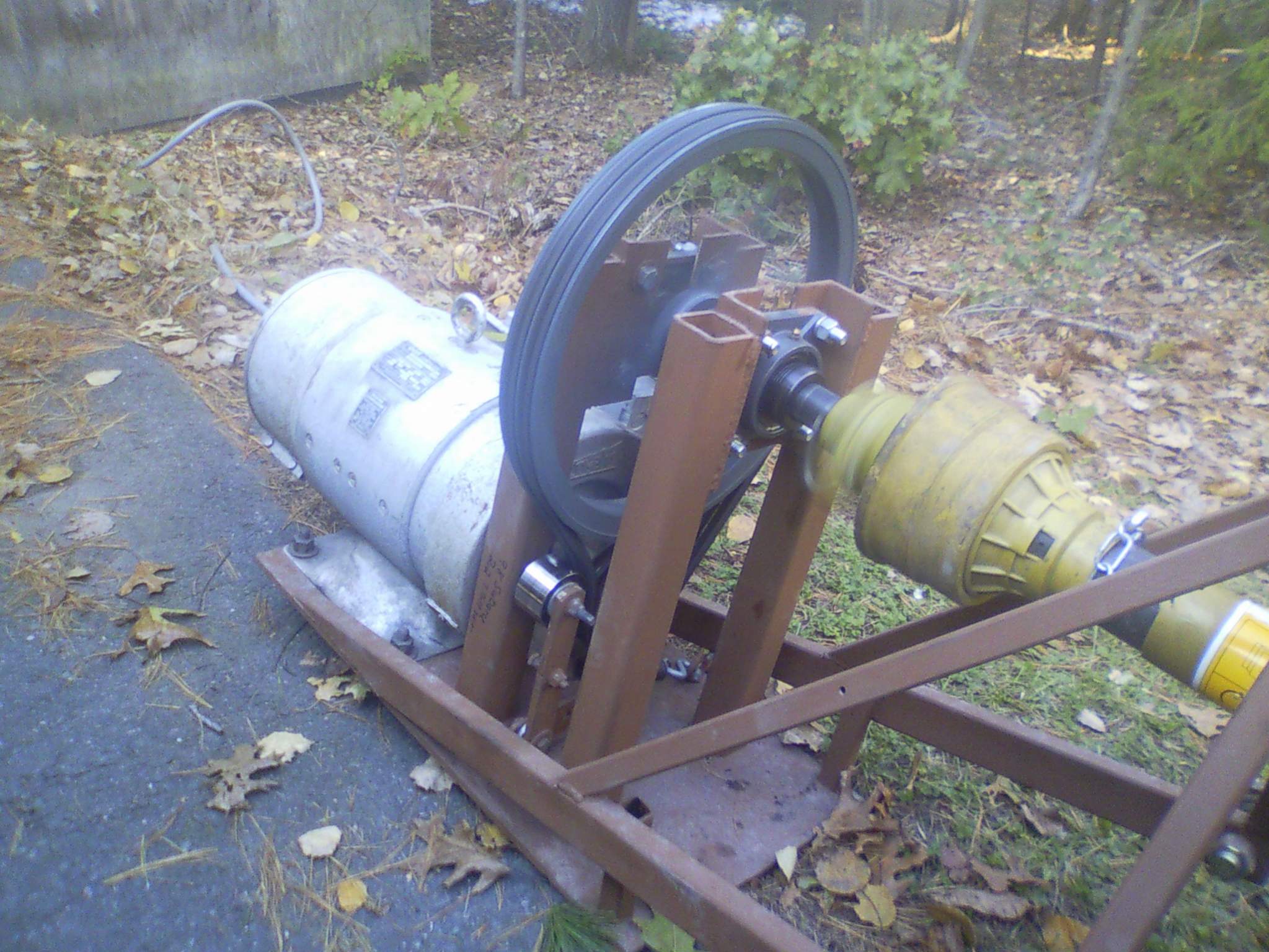

I am one of the New England people that was without power for 7 days. During the outage power for my house was provided by an old 7kw belt driven generator. My tractor, a B7100, ran 16 hours a day and was shut-off at night. To slow the engine down the PTO was run in high. I closely monitored voltage. We ran the furnace, 2 refrigerators, and misc lights. My spare generator went to the neighbors. We could not get fuel for several days so fuel oil was siphoned from the furnace.
That's a great option, the 2 or 3 speed pto. Especially for pto generator, lite load use. Wish my JD had it, got every other bell and whistle including cruise control :confused2: would of preferred 2 speed pto.
