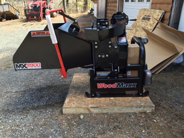

If you can handle the price, the MX9900 is the one to get. It has several design upgrades over the 8H. 4 blades instead of 2, hydrostatic drive, easy access to blades, fold up in-feed hopper (both a plus in maneuvering though the woods and smaller storage foot print), and overall just a cleaner / simpler setup.
I have one and it handles everything I have fed it, from 8" pine to 6" white oak. The only thing it doesn't like is the wild honeysuckle vines I have all over my property.

I've used my 9900 for the last 2 weekend and I've chipped up 13,500(+/-) lbs of chips.... yes we weighed them. And all I can say is that this thing is a beast! It took a little getting used to when adjusting the feed/speed control and anticipating the proper speed for the type wood I was feeding it, but after the first 1 or 2 hours I think I've got it down. My wife took some pictures and videos of it in action and I'll see about posting them here later. We are doing the Back to Eden Organic Gardening, so we are going to be using a lot of wood chips.
Setup was easy, I had to cut the PTO shaft to the proper size and, add the oil to the tank then run it at a very low RPM to get the air out of the system, that took about 3-5 minutes, and it was off to the brush pile.
So far It has proven to be every bit the chipper I expected.
I'll keep you posted.

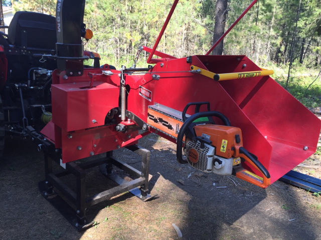

I am also looking at the hydraulic Woodmax. The reviews are good, the price is right, and there are some video reviews online.
I love mine!
