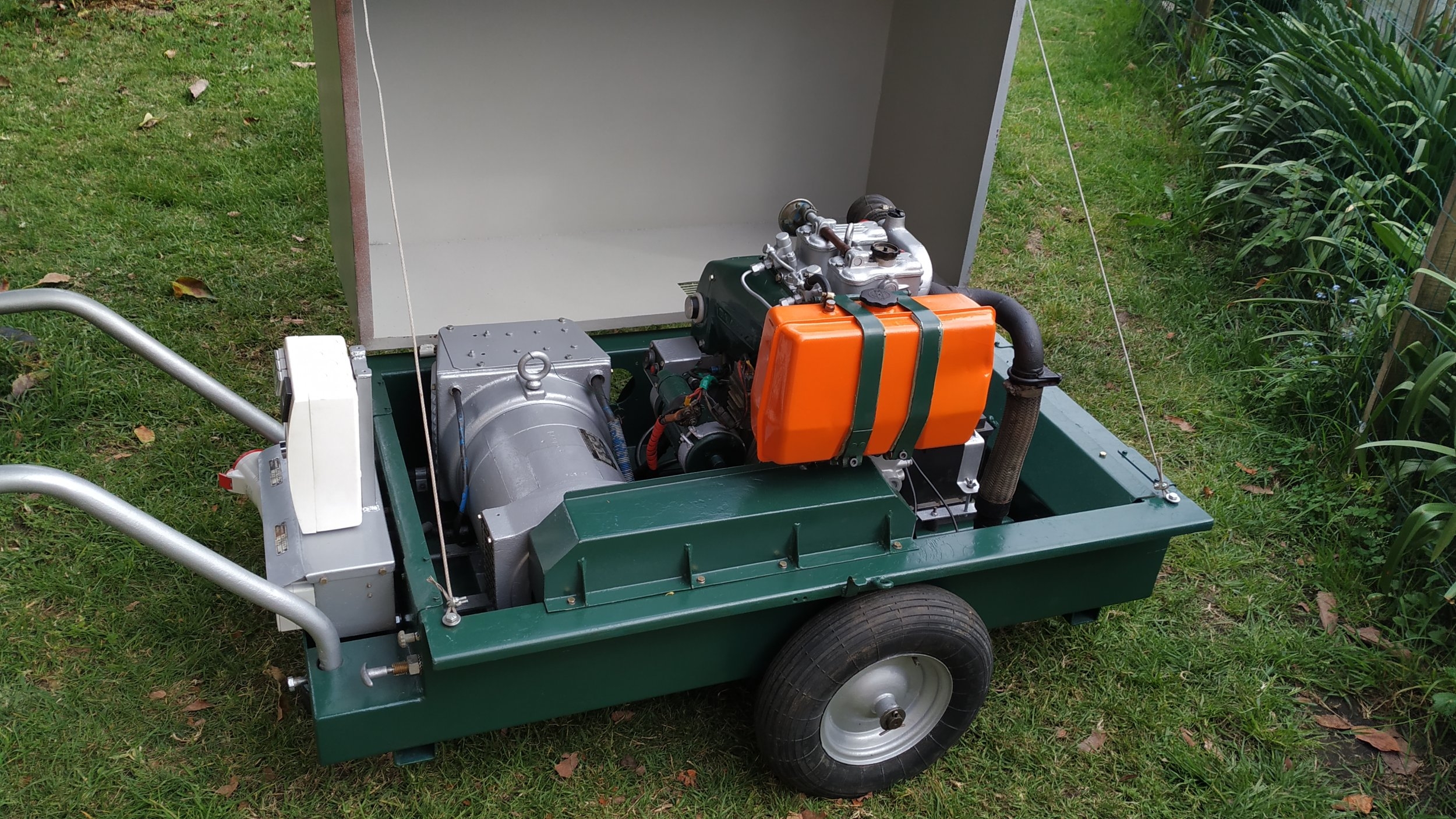

Mine is belt driven and since I don't actually need the 10kW, I got a bigger pulley for the engine and I'm now running the engine at around 1800 RPM. Plenty of power for a 3HP well pump and one of those small 50 liter air compressor. Way less noise and fuel consumption this way.

Thank you. This one was bought cheap, supposedly with a bad generator head. The intention was to pull the engine out and use it on my homemade backhoe but after a quick assessment, the old school voltage regulator just needed some tuning and new diodes to get it going again.
So a full restoration was in order, including taking the engine completely apart to fix some things, like a broken crankshaft thrust washer and several leaks.

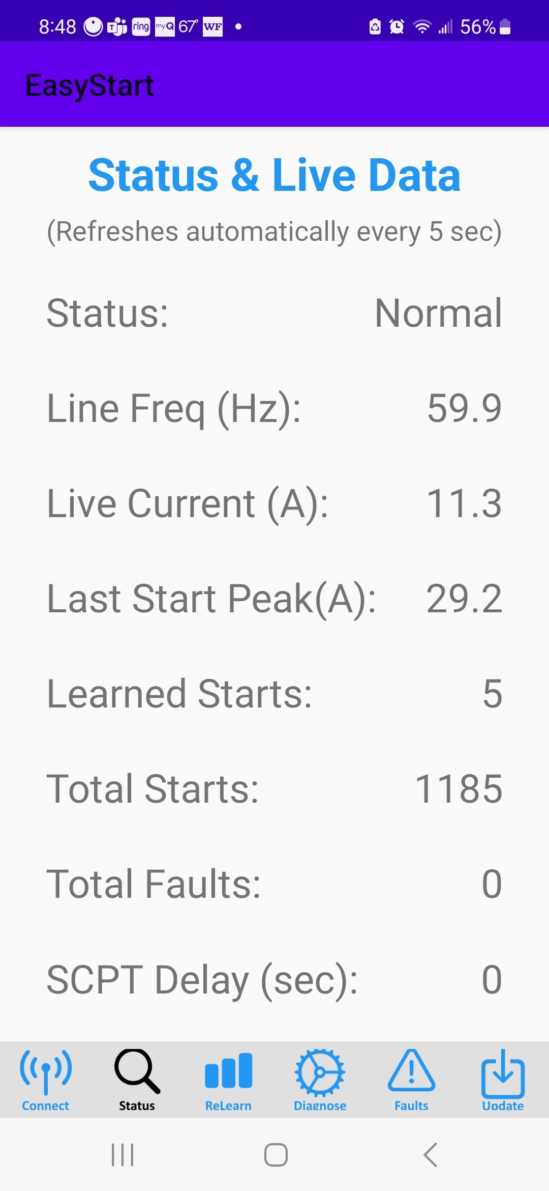

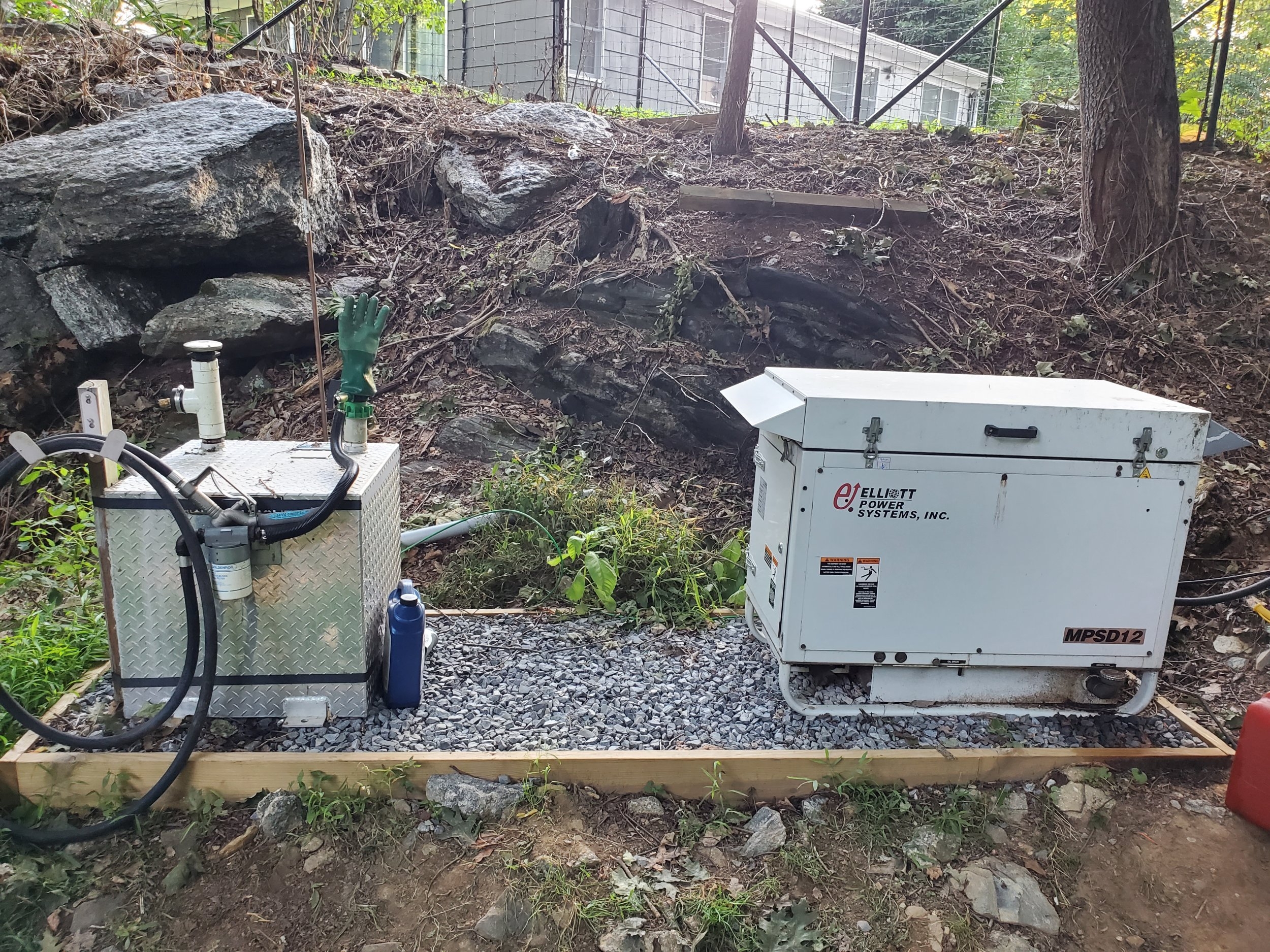

Easy Start owner here. My setup is a 12 KW diesel standby. Would run everything in the house but even with everything off wouldn't start the AC. Genset outputs 50 amps, AC has an FLR of 137 amps per the rating plate. Spoke with the folks at easy start who by the way were great, and went for the big one. It was real easy to install and it works great. The screenshot below was taken 10 minutes ago and is from the app on the Bluetooth model. I would suggest you call the folks at easy start and talk with them, they seem to be real honest. They told me what the max FLR draw would be using their device and it has always been a couple of amps below. Soft starts also lengthen the life of the motor. Very well spent $400.
