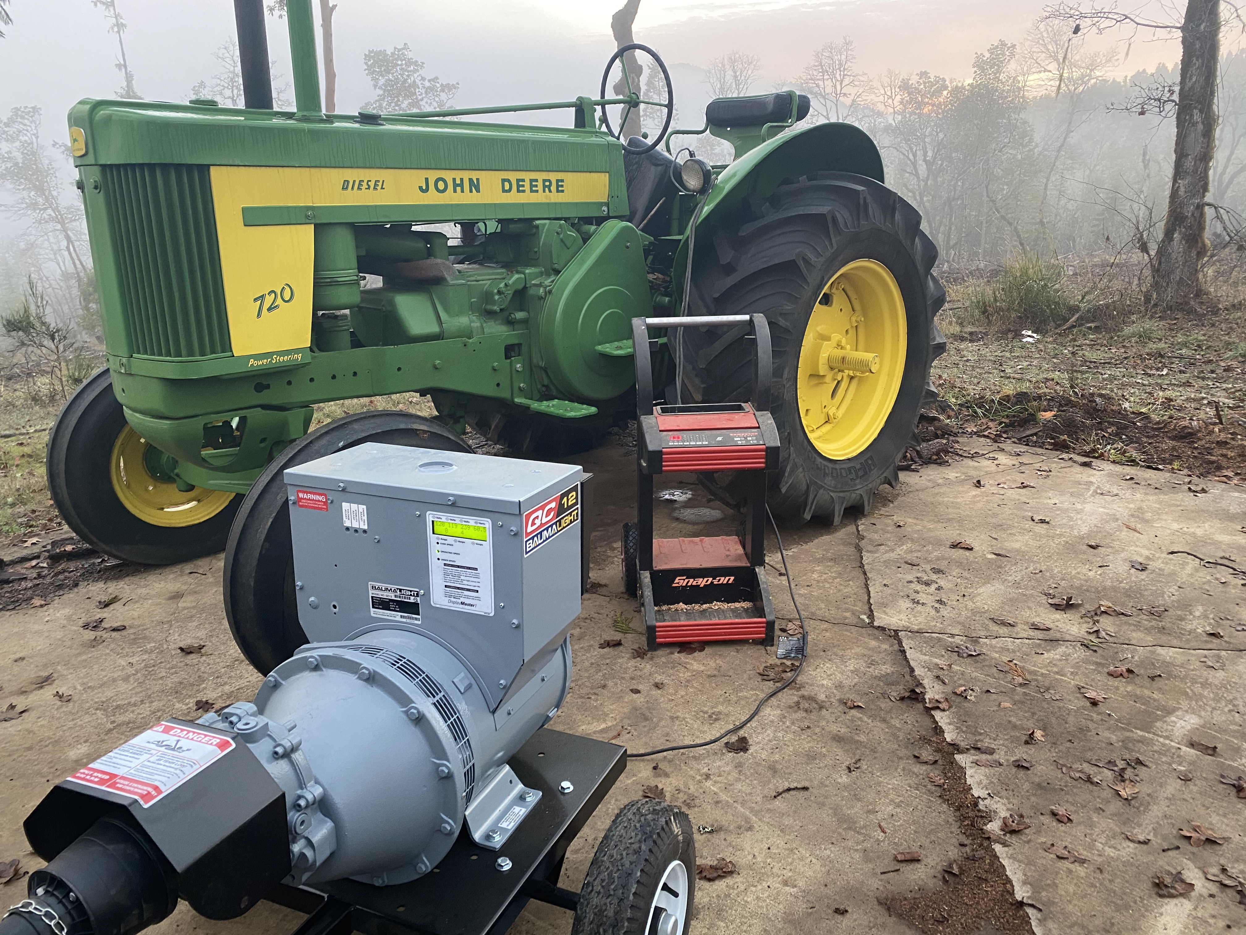

I have a 15kw Winco, and am happy with it. I set it on a trailer so I can wheel it around and store it easily in a small shed.
I agonized over the issue of needing the tractor during an outage, and finally decided I can just disconnect as necessary.
I absolutely hated maintaining a gasoline supply for my previous 7kw open frame Generac. The Generac was a great generator, but much louder than my tractor and PTO generator.

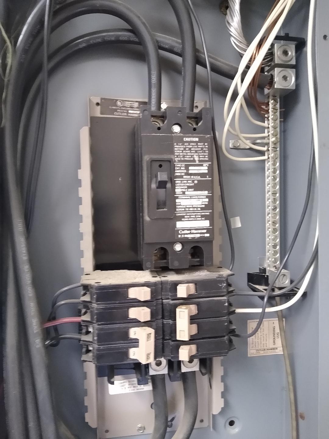

Mine is connected to the house through a 60a breaker and main interlock. The house connection link posted is not designed for generator supply.

They aren't cheap, but I have an 1800RPM Baumalight QC12 w/ a built in AVR. This is a very robust generator, and when running it in E-PTO behind my Deere 4052R, it's very quiet and fuel efficient.
When using as a home backup unit, I plug it into an outside 50A receptacle which goes to a manual transfer switch located inside my house.

At a minimum you should install an interlock device on your main power panel;
Generator Interlock Kits Archives | GenInterlock
This is an inexpensive alternative to a whole house transfer switch which is a neater and cleaner way to do it.
Your material list sounds good, just the location and the method of having to manual turn breakers off to isolate power with no interlock

Very nice. Another question is the receptacle on the PTO generator I'm looking at is 60amp.
Can I get by with a 50 amp plug/wire and receptacle on the other end?
Can you....or “should” you?
Generally, 50 amp plugs and wires “should” be protected by a 50 amp breaker.
Practically, if you don’t draw more than 50 amps load you’ll “get by”...
Does the generator have a 60amp main breaker?

The IMP and Winco PTO generators have a 14-60R receptacle which surprised me as the Harbor Freight generator has a 50 amp receptacle.
Wouldn't the 50 amp double pole breaker at the main panel in the house protect everything?
