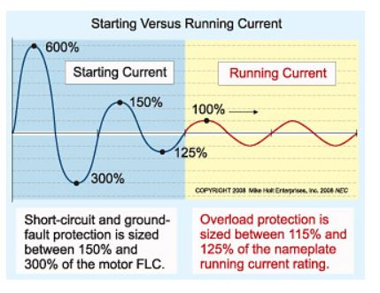

That's locked rotor amps! What happens when you lock a rotor on a motor? You blow the breaker! It's not the same as starting amps.
Motor Calculations | NEC content from Electrical Construction and Maintenance (EC and M) Magazine
" Motor locked-rotor current. If the rotating part of the motor winding becomes jammed so it can稚 rotate, no counter-electromotive force will be produced in the motor winding. This results in a decrease in conductor impedance to the point that it痴 effectively a short circuit. What痴 the result? The motor operates at locked-rotor current, often six times the full-load ampere rating, depending on the motor Code Letter rating [430.7(B)]. This will cause the motor winding to overheat and be destroyed if the current isn稚 quickly reduced or removed."
Electrical Motor Calculator
Plugging in 1 hp , 90% efficiency, 85 PF (power factor) and 230V to the calculator in this link.
You get:
1 phase = 4a.
FLA = 5A
What does FLA stand for? Full Load Amps! At full load the motor draws 5A, 230V * 5A = 1150W; 1 HP = 746W FLA for a 1 HP motor = 1150/746 or 1.54 times.
Now look at the chart for starting amps, what does the FLC state? 150% to 300% of running current and what's 300%? It's 3 times, exactly what I said. I work with this stuff everyday my systems are built on these calculations. Are you off the grid running several inverters on a daily basis?
While understandable, I'm afraid this is somewhat incorrect. A number of motors draw their locked rotor amps for a short time period at start up. Classic and common example is heat pumps. It's also true of some table saws, which has caused me joy over the years. My sawstop wired at 120 regularly trips the 20a breaker - surge is briefly 80 amps, per the engineers at the factory. Milliseconds, but still would stall out with a little 5k generator.
You can get around LRA with thoughtful staging of equipment starts - I have 3 HVAC units, and I bring them up big to small. But LRA is written on the plates for a reason (note, this is a purported advantage of inverter drive HVAC, no LRA issues)
Im glad this is finally being straightened out. All motors draw locked rotor current at startup because the rotor is stationary at that time. This is a very short term event that you will need a peak holding meter or an oscilloscope setup to capture because the current drops quickly as the motor starts to turn and continues to drop until it reaches speed. It is on the order of 4x or more of full load current. If this current times the Voltage exceeds the gen rating the gen voltage will buckle immediately. If it drops too much a motor with load wont start. A well motor starts without load , but immediately begins to develop an increasing load as it speeds up. This situation allows reliable starts at only 3x and lets you get by on a smaller gen.
Also, but not in your post, any suggestion to use 746 input Watts as equivalent to a 1HP motor will mislead the unwary. Virtually all motors use more than 1KW per HP. Actually it is a very good motor that can achieve that efficiency. And, as above, even a lightly loaded 1HP will still exhibit the high locked rotor initial current 4x above nameplate. Should this cause gen V to buckle it will cause big problems with other motors that may be running. Refrig or AC compressors may stop and take down the system. Multiple motors running simultaneously and cycling on gen power are going to cause an issue with systems not having ample surge capacity. Thats why its so good to oversize the gen while sizing the engine to supply the running load. The gen doesnt buckle and inertia controls V drop thru the surges of startup loads.

Good, now tell me how much starting motor reserve generator manufacturers recommend? How about 3 times. Now let's take a motor with 90% efficiency, 746/.9=828.9 watts. OK, now let's take some empirical measurements:

By the quote referenced, 300% at 80% of speed does not support your argument. At the initial startup, from a dead stop, the current can indeed exceed 300% of FLA. Also one is not interested in total power, it is instantaneous current that can be the limiting factor. Above a certain current, the generator field will saturate, limiting available current. The worst case scenario is with split phase motors. The high starting current limits acceleration and at the same time lugs the generator voltage. The motor never accelerates enough to trip the start switch so the motor chuggs at low speed and high current, the gen set is pulled down and if an overload does not save the day, you could fry the generator or the motor or both.
Bottom line is that 3x FLA is a good RULE OF THUMB, but peal currents at initial startup can definitely exceed that value. Just look at the motor specs I posted earlier. Will the motor start if less than the typical peak is available, most likely it will, but a few may not.
