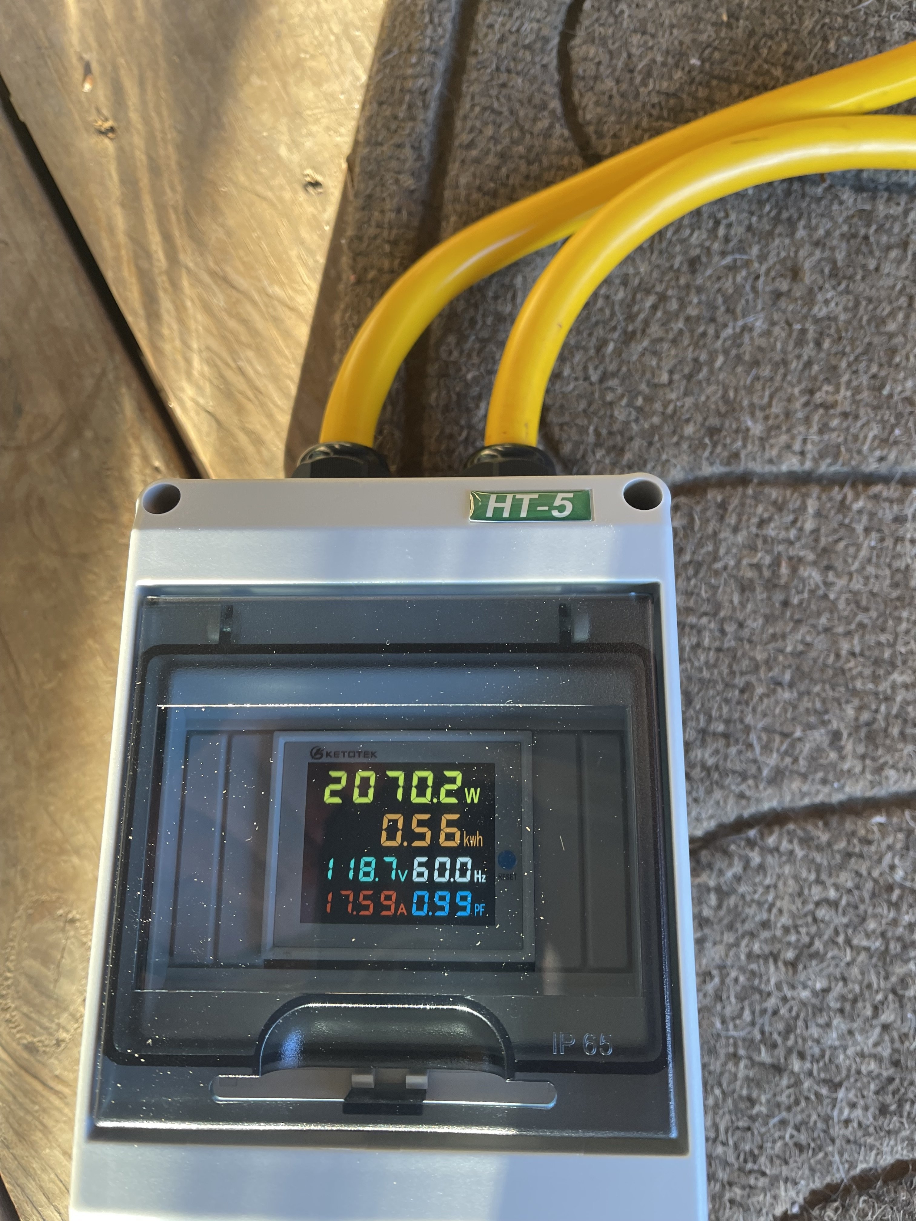

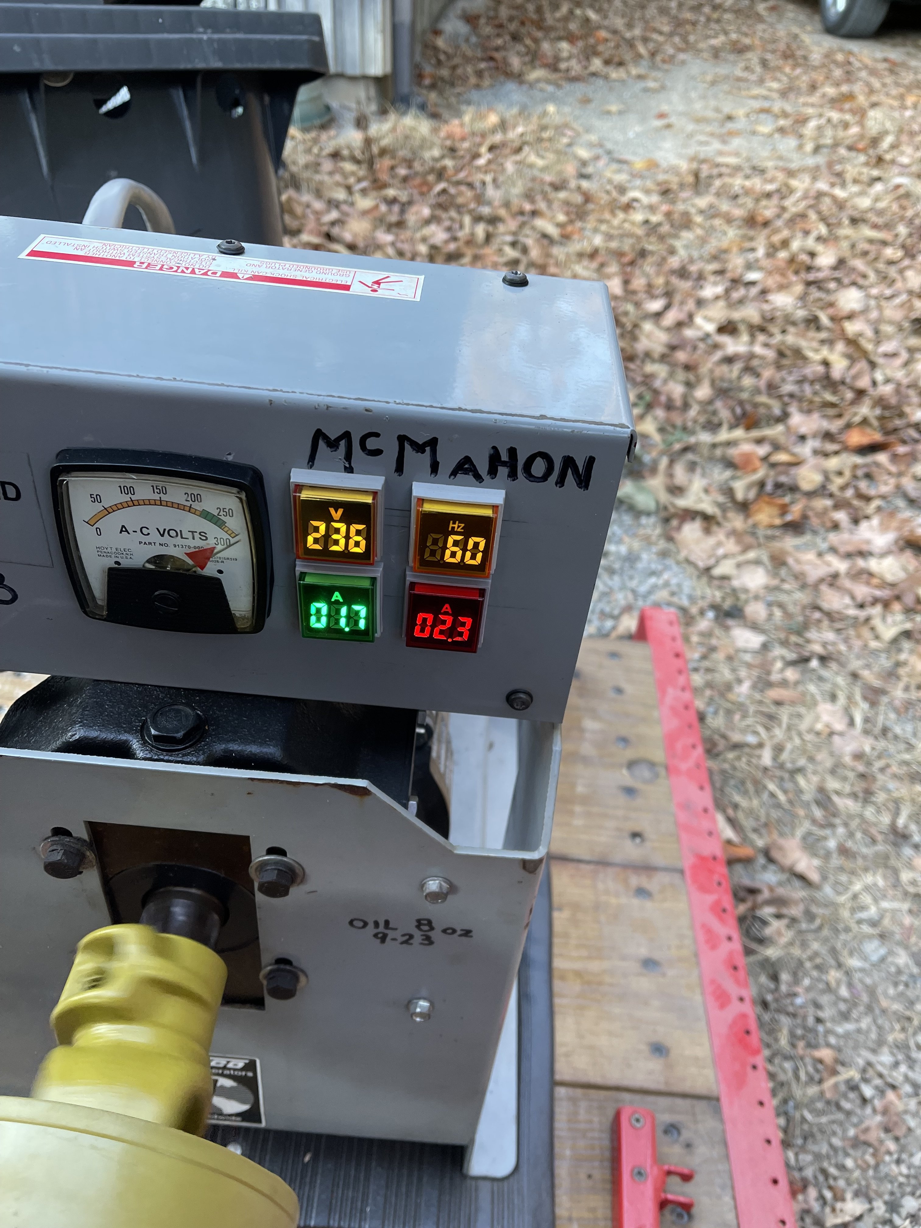

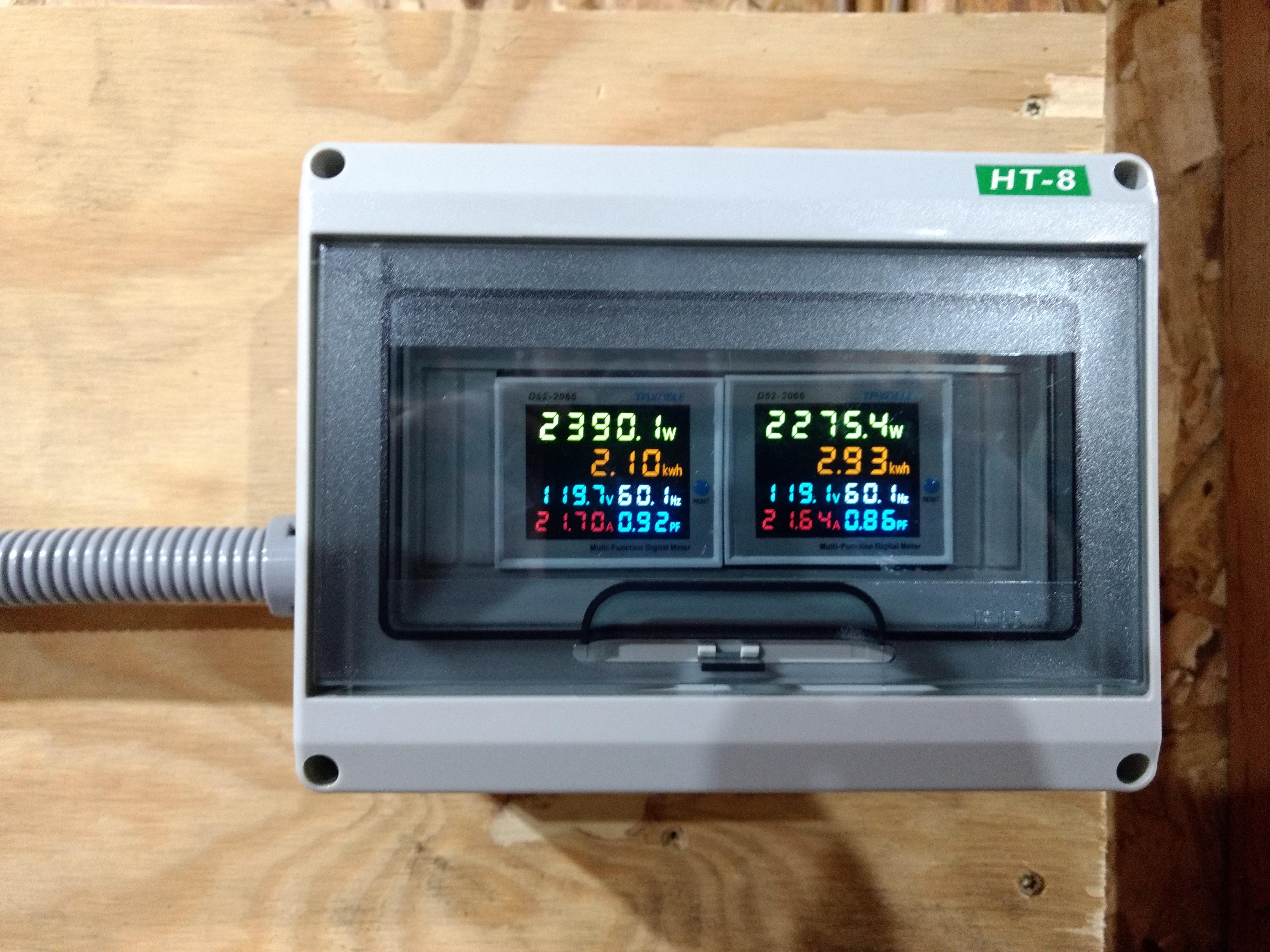

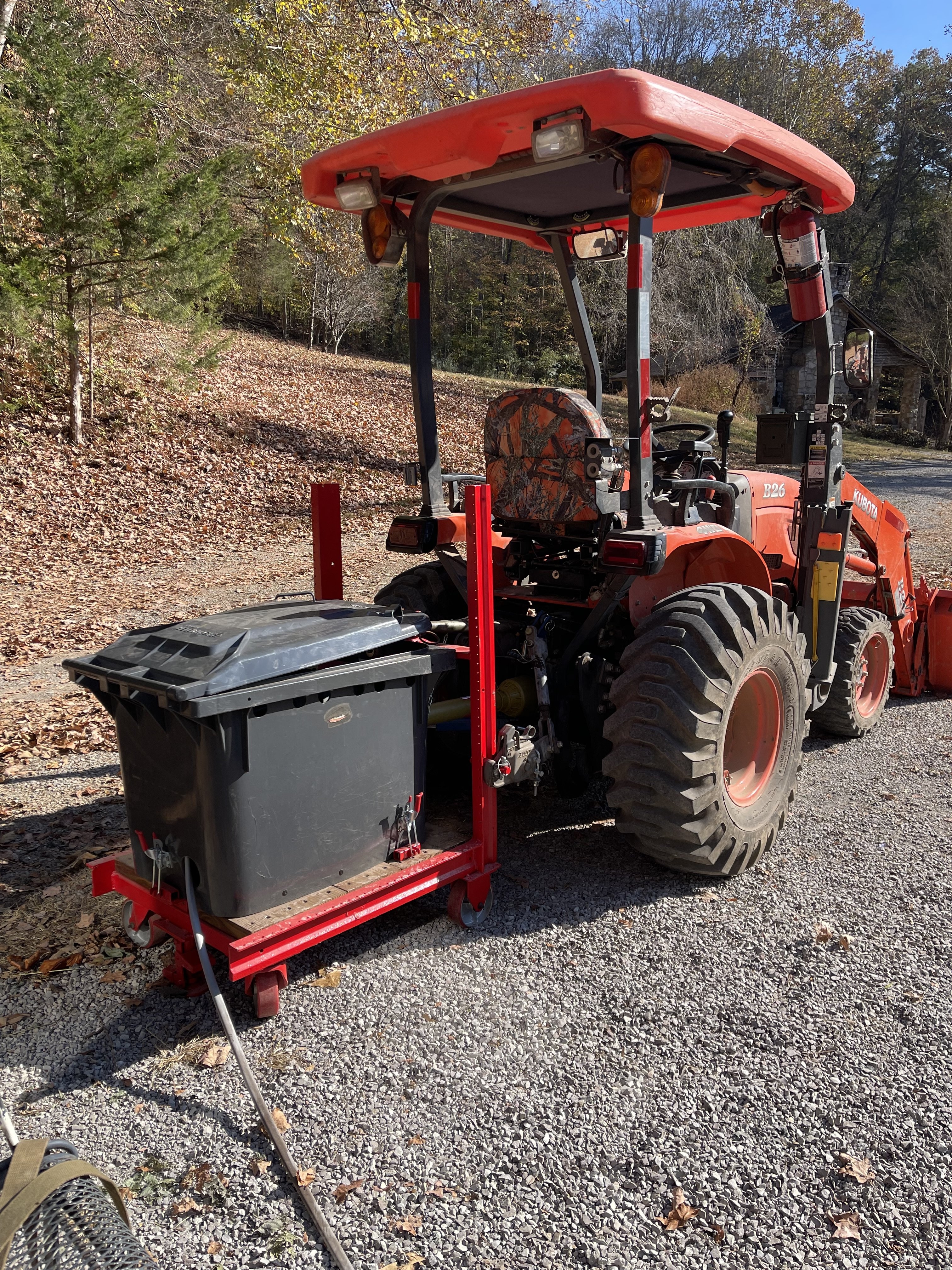

I decided to upgrade from a Winpower 10/15 KW to the Winco 27KW, it will power everything without a problem. My L6060 works great, my M5-091 works even better with the EPTO, less fuel use. My B2650 will run it, but I wouldn't try to start the Air Conditioner, that might be a little much for that tractor. A couple of the pictures are from an outage in July, about 9 hours.

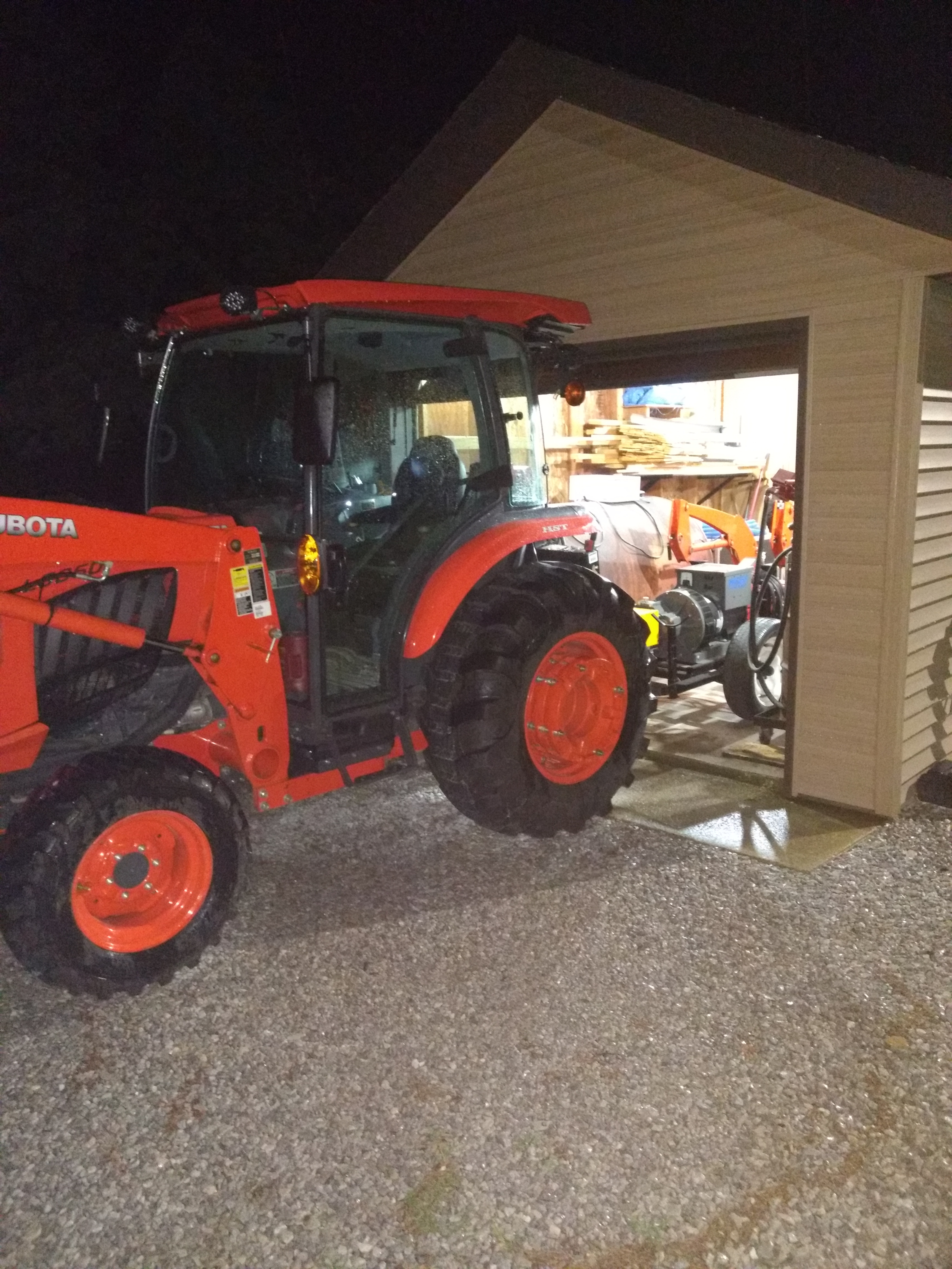

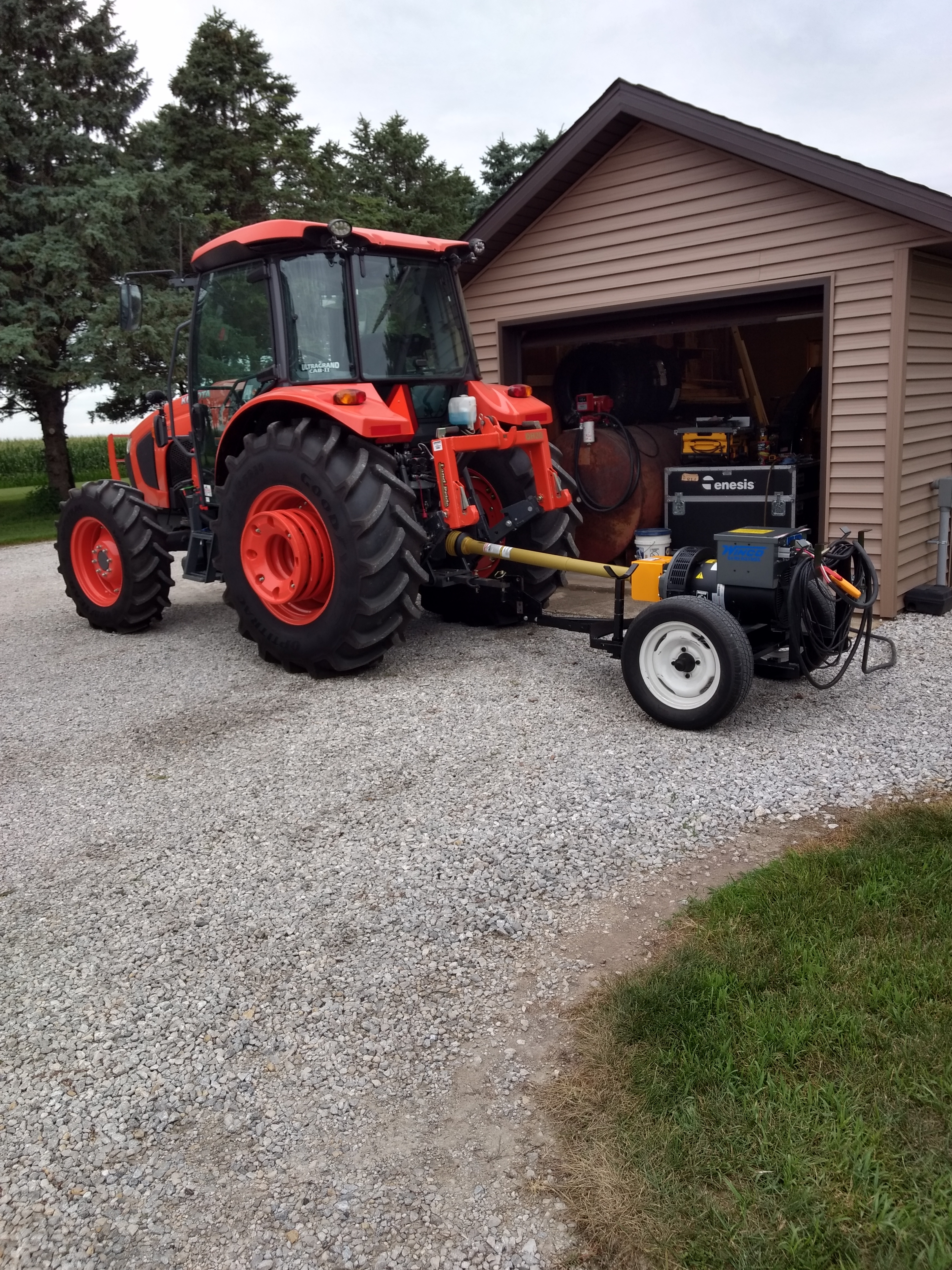

Have a 10K PTO powered for my L4240 Kubota.Mounted on a trailer,correct disconnect/switch.Works well the few times it has been used.Disadvantage is that the wife would have no idea how to hook up.
