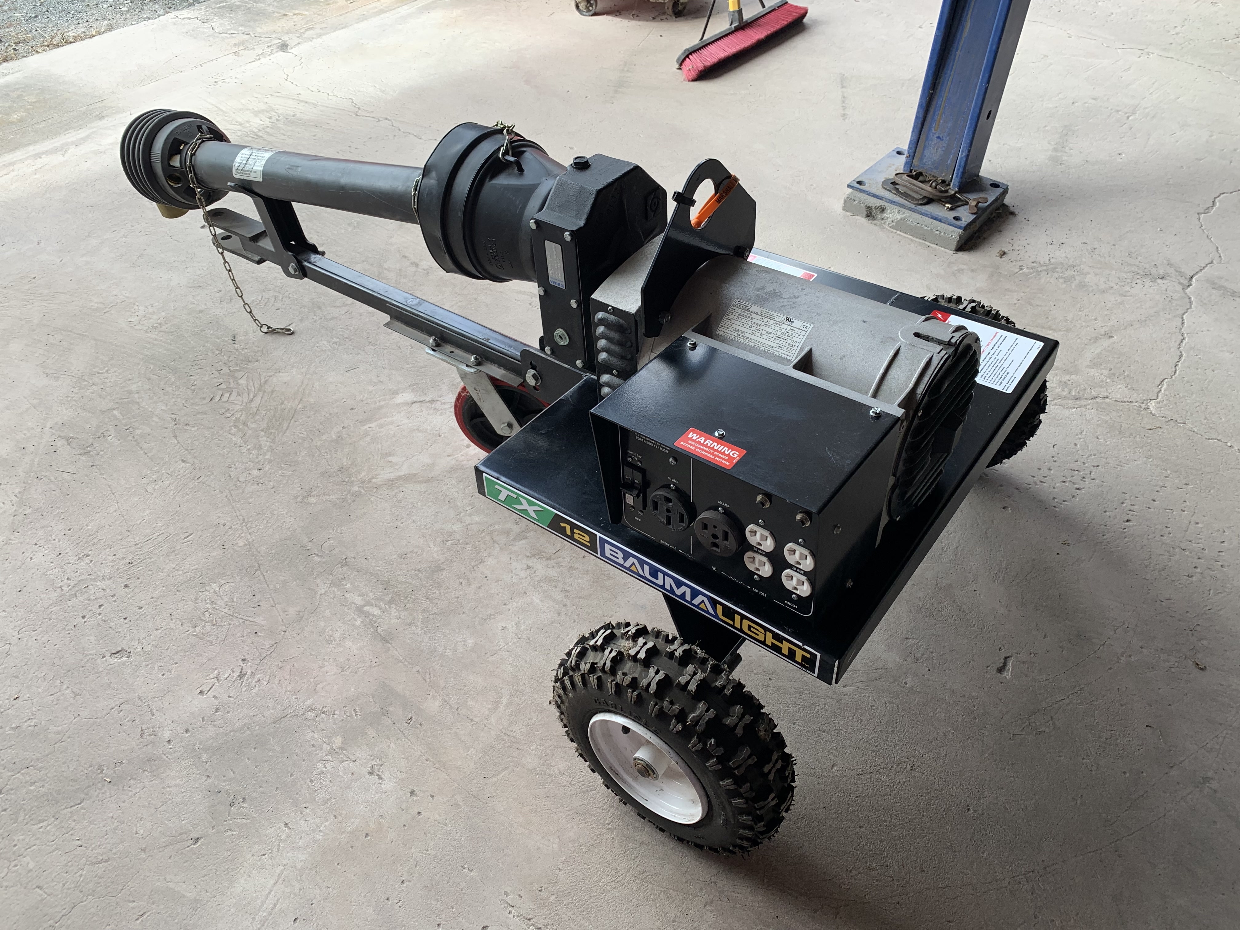

Too bad you didn't post earlier. I just sold my Baumalight TX12, 12KW PTO generator 2 weeks ago;
It served me well, but I'm getting older and not as able to hook it up for every outage we get around here.

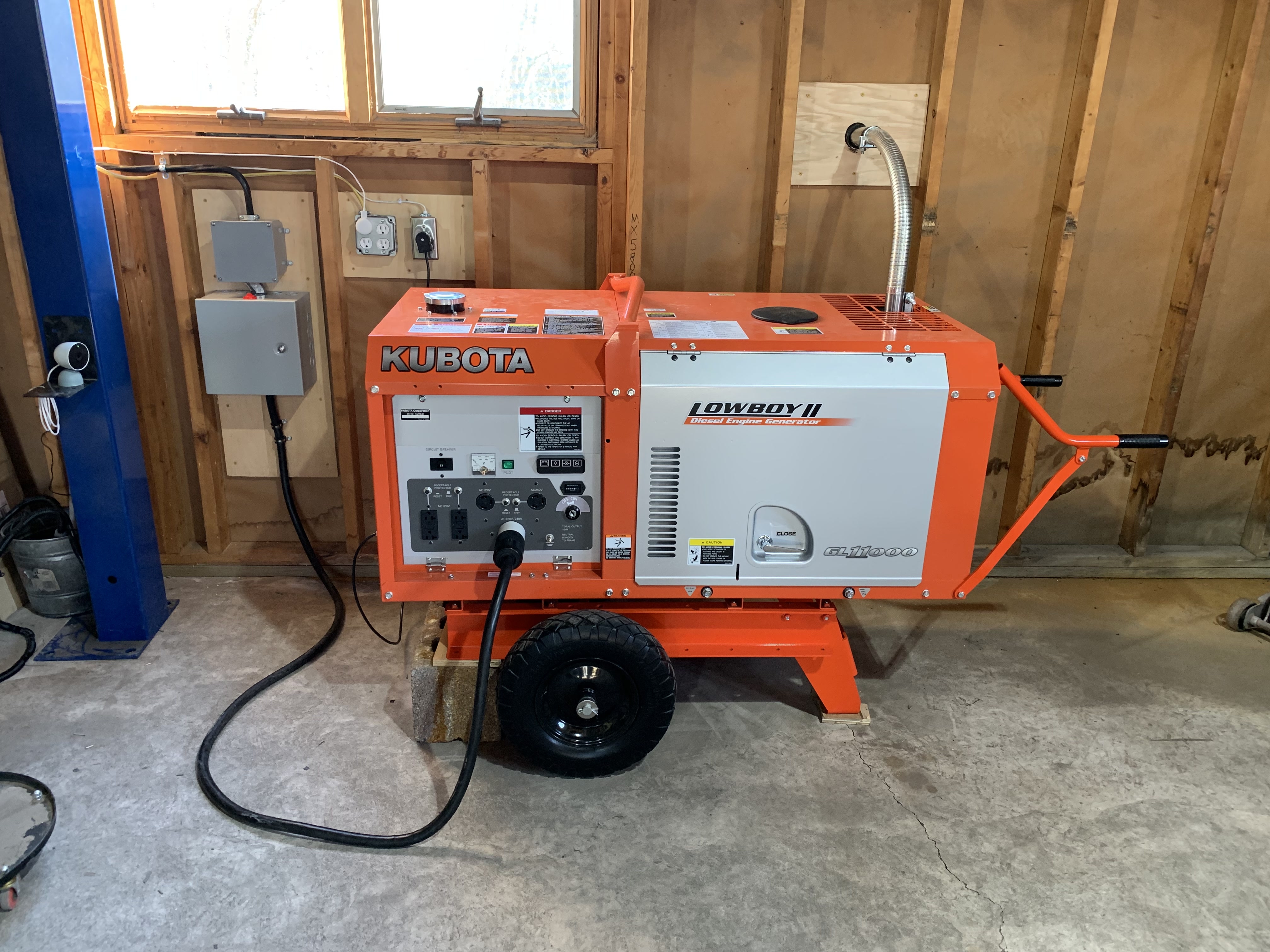

I decided to replace it with a standalone Diesel generator:
It's far more economical than using a 60HP tractor to power a 12 KW PTO generator.
Don't get me wrong, there's nothing wrong with a PTO genny, I'm just not able to deal with the hassle of hooking it up any longer.
To answer your question, I have nothing but good things to say about the Baumalight. It's a solid piece of equipment.

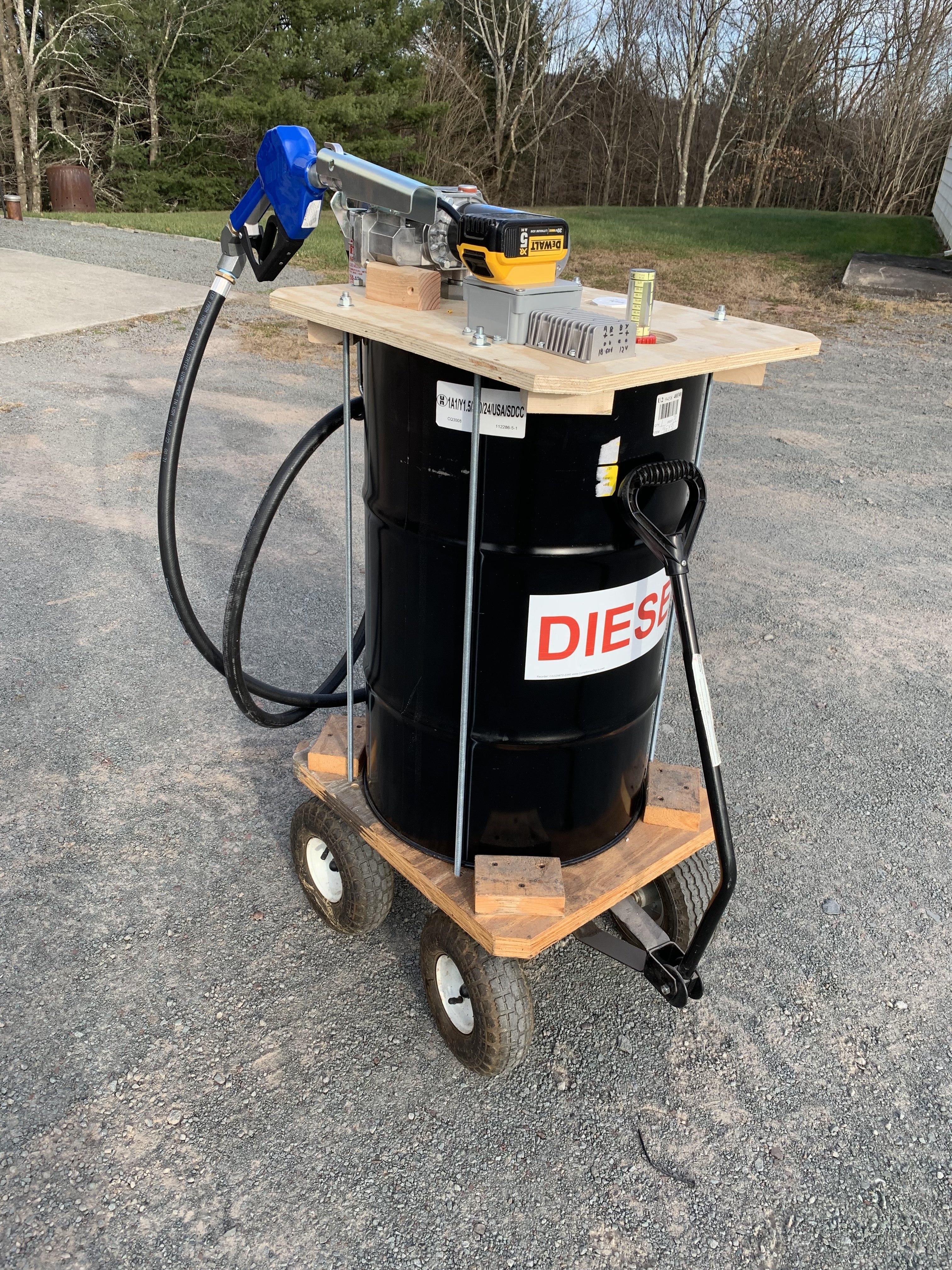

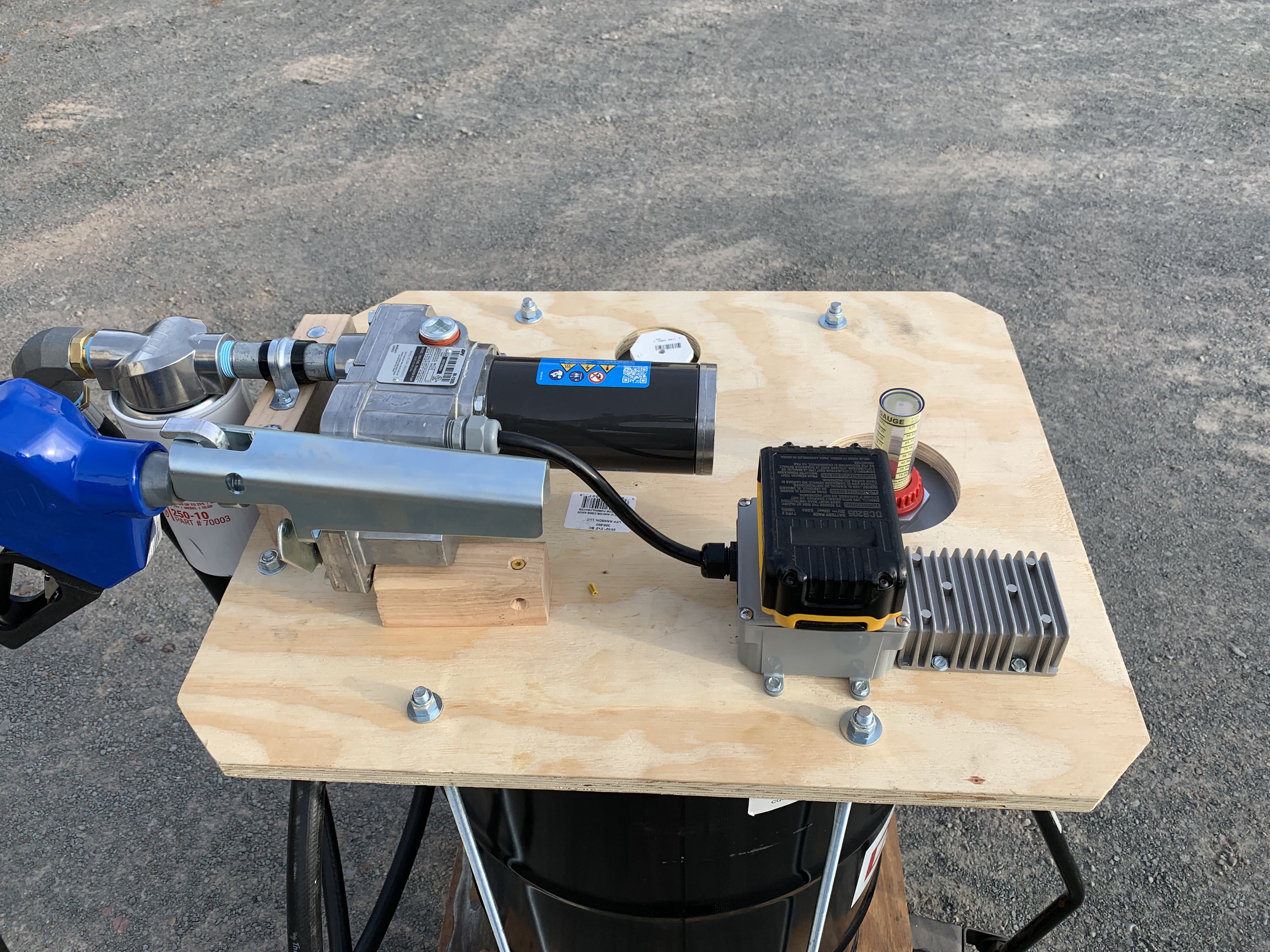

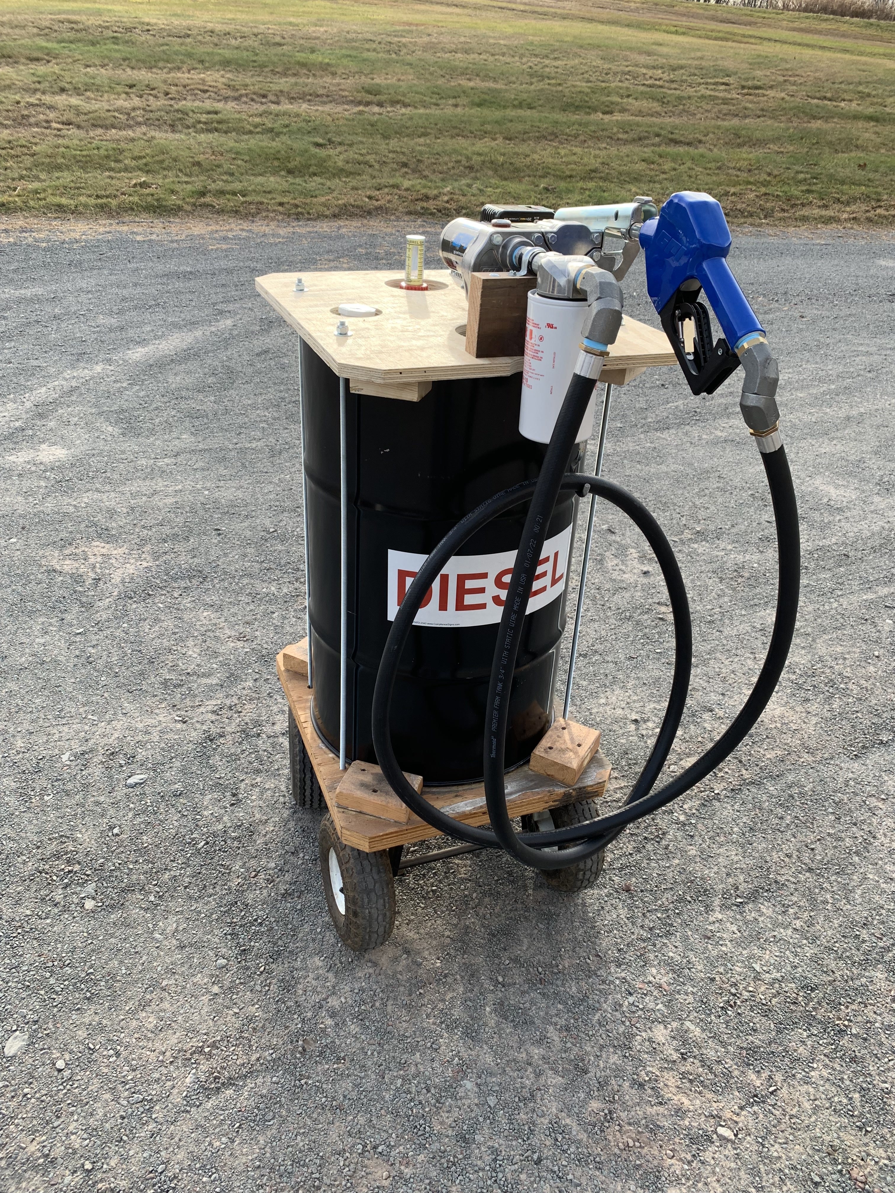

I wish I could do the same with my 1000 gal. tank. The generator is out in the barn and piping fuel out there isn't practical. Instead, I built this caddy with 4 pneumatic tires that will roll over rough ground. It's a 30 gal. barrel with a cordless tool battery powered pump:

That's a really clever setup!
I'm curious; How did you craft the battery holder? From an old tool? How stable is it?

Battery adapters for most cordless tool brands are available online:
Dewalt:
Milwaukee:
Ridgid:
Makita:
And many others. Just Google "cordless tool battery adapter."
I use the DeWalt adapters for many applications and they work very well. Just be careful not to short the leads with a battery connected.💥

What's your Dewalt battery voltage? I love the idea, but don't want to put 18 volts to a 12 volt pump.
/ PTO Generators - Any Favorites? #19
Checkout the grey item to the right of the battery; I think @bdhsfz6 used a voltage regulator off of some vehicle.
