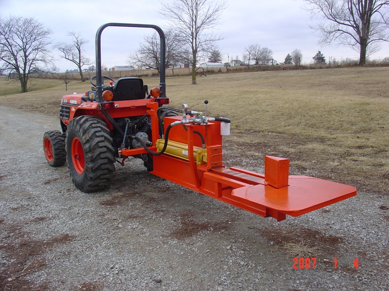

I'm with the pessimists here.... Don't think you are going to be happy with a 6-7gpm pump.
I built a splitter several years ago using the 20gpm pump pictured above. Like SawyerRob I got along fine. Was fast and powerful. I ran it on a B2910 Kubota (30HP) tractor.
What size reservoir are you running that pump with?

Hmmm.... then I should be fine if I go with a 20gpm pump and a 11gal tank?

I can only speak from my personal experiences. I never had a problem.
I built my splitter and did a thread, but can't find it, seems threads more than 10 years old are purged??? Probably just my ignorance.....

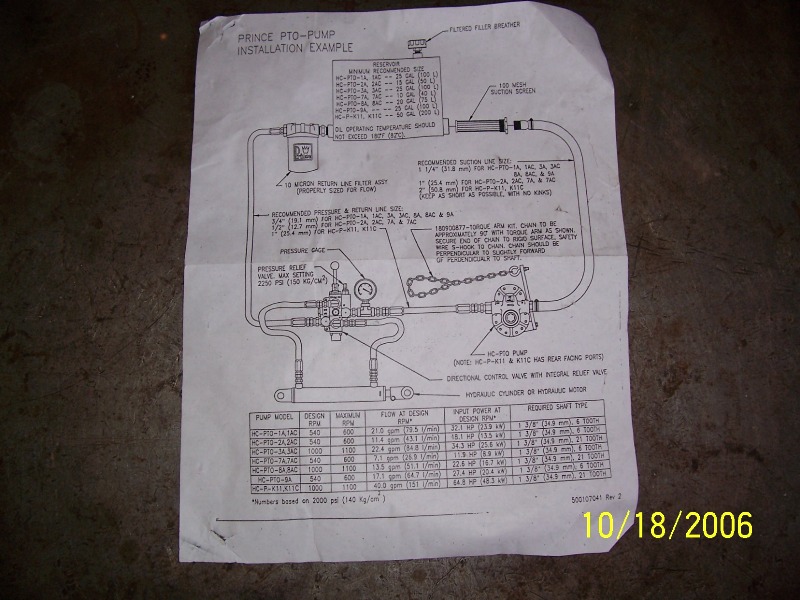

Here's the guidance that I got with the pump as well as a pic of the finished product.

I'd go with a 20 gallon pump, you can always lower the rpm to get the gpm you want, if heat is an issue.
