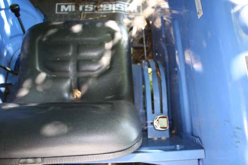

I have a grey market Mitsubishi MT3201D tractor that has a 4 speed PTO. I have not been able to find information on what speed the PTO settings were. I could tell when the PTO was somewhat close to 540 just from previous experience driving other tractors, but I wanted to be more accurate. I was trying to think of the easiest way to measure the PTO speed and wondered if I could trick a bicycle computer into displaying the PTO RPM. I knew from setting up bicycle computers before that you calibrate them by telling the computer how far the bicycle travels(in mm) for one revolution of the wheel. I did some calculations and determined that if you set this distance at 2682, then the MPH would be 1/10 the RPM of the wheel. Here is the Bike computer I used:
attachment.php
I installed it on my tractor yesterday and it works great! Now I can tell at a glance exactly how fast my PTO is turning(as an example, the 38.2 mph shown in the picture would be 382 RPM). I also get the added benefit of a clock. I haven't taken any pictures of the installation yet, but if anybody is interested I will post them after I do.

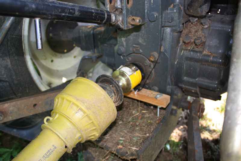

Where did you put the little magnet? I think it would have to go on the PTO output shaft, since changing implements usually means changing PTO shafts, so the only common factor is the output shaft.
/ PTO RPM Indicator

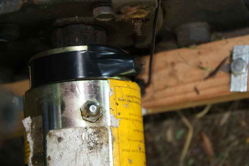

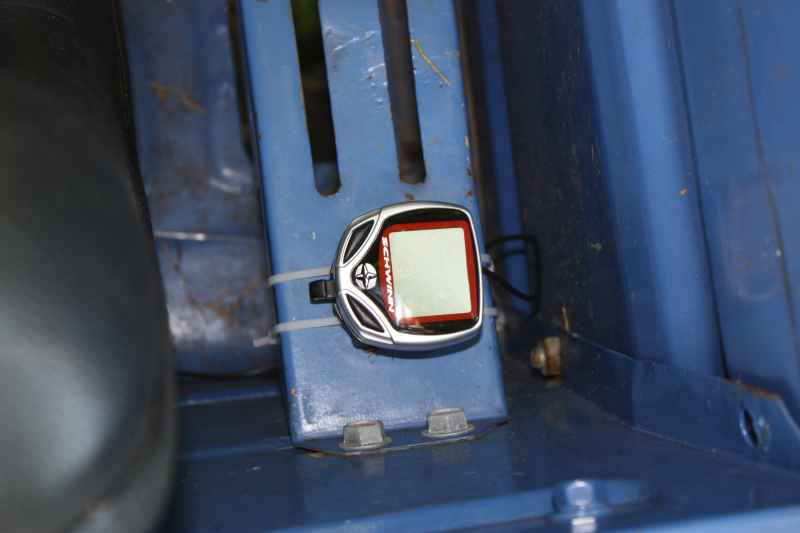

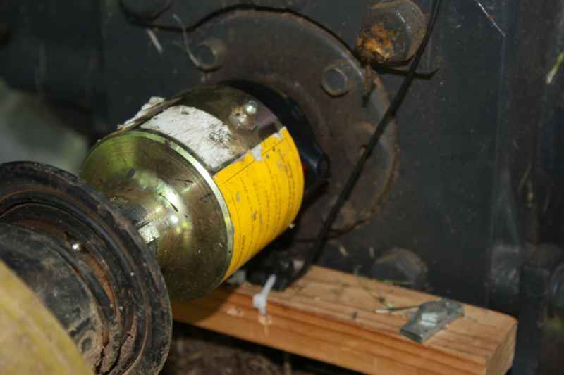

I took some pictures this morning. I have an over running clutch on my PTO, so that gives me a perfect place to attach the magnet. The magnet is the lump wrapped in electrical tape. I plan to glue the magnet to the clutch, but I started out just using electrical tape to make sure it would work. Without the clutch on there, the PTO shaft would be the place to attach it.
