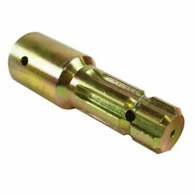

I have the shaft that came on my equipment new so it is not “the wrong shaft” A quick note Both these Bush Hogs are very old. My 306 is nearly 50 or maybe more. My 502 or 600 is 40ish. My guess is things were a little different then when they were sold/bought. 1) There were not as many lawyers and 2) Maybe the end user knew how to use them properly. Something that I think helps is I Bush Hog very high. I am not mowing a lawn so I don’t try to mow close. Never had an issue since 85 but I do recognize the benefits of a slip clutch thus this post hoping to glean info. Thanks

Geeez, I’m trying to find a slip clutch. That is the purpose of my post. If you read my post I have never denied it would be wise if I had one so I’m not gambling I’m trying not to gambler
Sorry I made an assumption on your equipment and offended you bones66. I stand by my statement you have the wrong shaft for a brush mower.
Even though if you look at the diagram you will see my exact PTO shaft. How can it be the wrong one??? Bush Hog put them on from the factory they have a part number etc.

I'm fairly sure you're not going to find that exact clutch anymore. Those parts are either outdated or discontinued. Best advice is what was suggested earlier. Figure out how to modify your current PTO to accept a clutch that's available. Or just buy an entire new PTO with clutch.
Maybe others can help GL either way.
I am not trying to be a dick. I guess like others I was unaware Bush Hog ever delivered a mower like this.
I was trying to point out that this type shaft would normally only come on a finish mower which has belts to provide the slip protection.
Looking more at the conversation and parts list it doesn't look like any reasonable way to update without replacing the gearbox and driveshaft since they didn't have the groove in the input shaft.
Sorry to offend you guys.
   / PTO shaft #40
There are adapters available for this..
Would extend the length some but the pto shaft can be shortened if needed.
