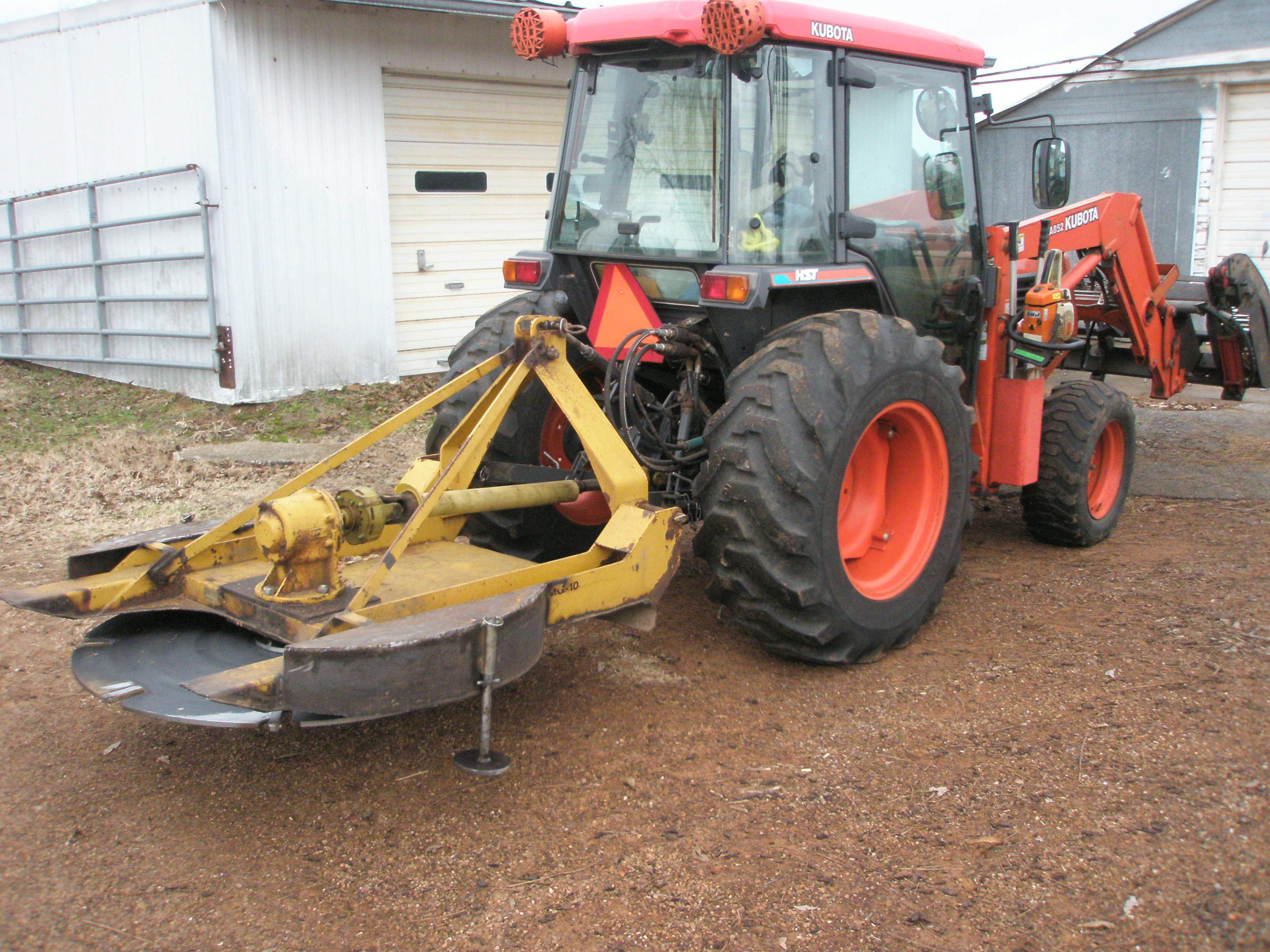

My latest project was to build a tree saw out of an old discarded brush cutter.
We may later add a hydraulic tree pusher, if we find we need it. Till then, if we have any doubts about how it will fall, we just fall it with a chain saw, then cut the stump off at or below ground level.
It will cut up to 19" in a single pass.
Together with my homemade grapple, I can get some serious work accomplished.

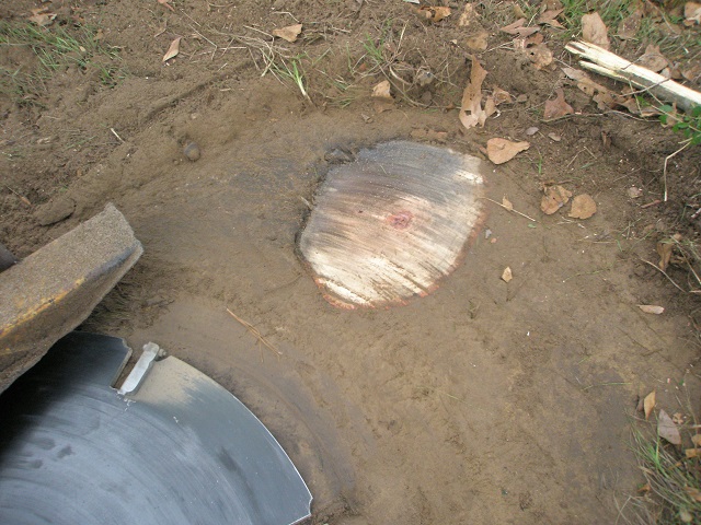

Well, we have not learned to take video's or post them.
Attached is pic of a 13x17 black jack tree we cut. If you don't already know, black jack is really hard wood. Probably the most hard we have in our area that I know of.

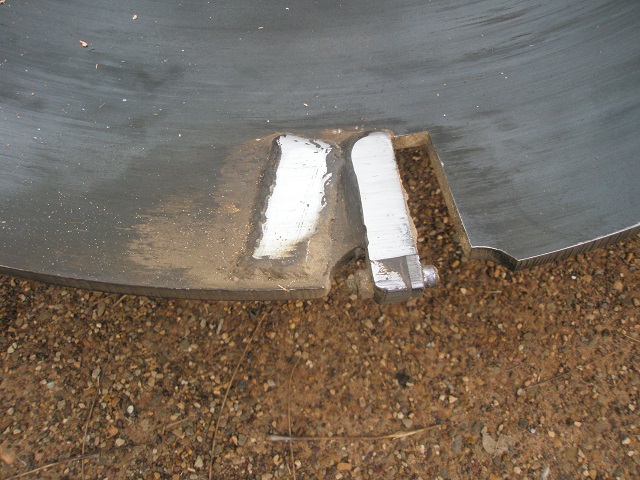

What did you use for teeth. And great job.
We had the saw blade made for us. It is made with 1/2" plate, is cut out for the teeth, then has a 3/4x3-1/2 bar welded in to mount the carbide insert to for cutting. Insert is 3/4x3/4x1/4 rotatable & reversible. All 8 sides can be used.
Attached is pic, this particular one shows one of two weights we added when balancing the blade.

/ PTO Stump/Tree saw
Nice clean cut and nothing to grind.
You can actually cut below ground level. Of course, you lower the ground level for 4' also.
/ PTO Stump/Tree saw #12
That looks like a nice peace of machinery. What make and model was the discarded brush cutter? Is the main part of the blade mild steel?
#13
The mower was a MG 10 Sidewinder. We had torn up 3 center T Gear boxes by hitting stumps, so got tired of replacing gear boxes.
The 90 degree gear boxes are 75 HP rated, 1 to 1.46 increaser ratio.
Not sure about the grade of steel. We talked to someone else who had built one & he said these people were knowledgeable on the wheels & he was happy with his. We liked his price, so just went with him.
We have probably put 8 to 10 hrs on it so far & have not rotated any tips.

/ PTO Stump/Tree saw #16
I reckon you need to beef up the side plating on that. The energy in 4+ foot of 1/2" plate rotating at 540 rpm is mind boggling. Do some sums, but I reckon you'd need at least 3/4 plate around it rather than the 1/4 stuff it looks like. At the moment if that gearbox output shaft let go people in Mexico would be saying "What the F*ck was that!":eek:
#18
It does have lots of momentum. I have cut a 1-1/2" then moved & cut a 3" tree after disengaging the pto. It does slow down very fast (and can even bog the engine down) when it engages the ground, much like a rotary mower. It has two layers of steel between it and the tractor on the front side, and on the rear side it is below all the steel, so I can cut below ground level. Normally we are 1/4 mile away from any living beings.
