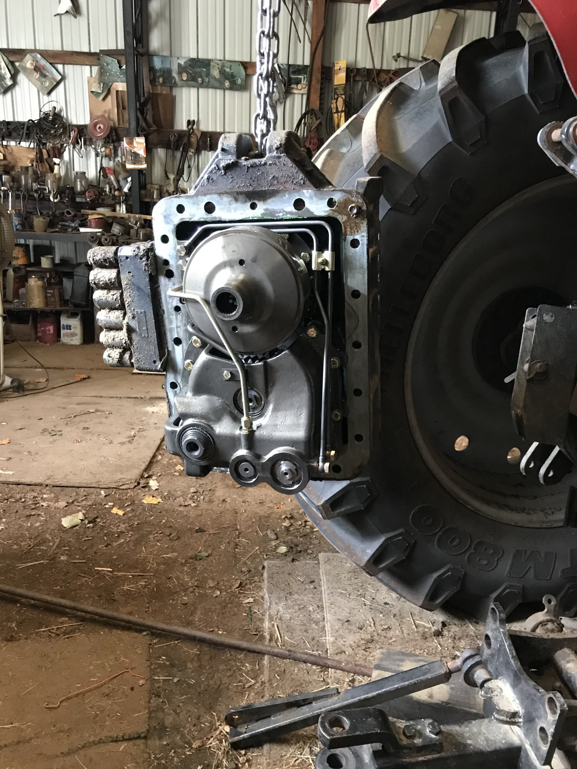

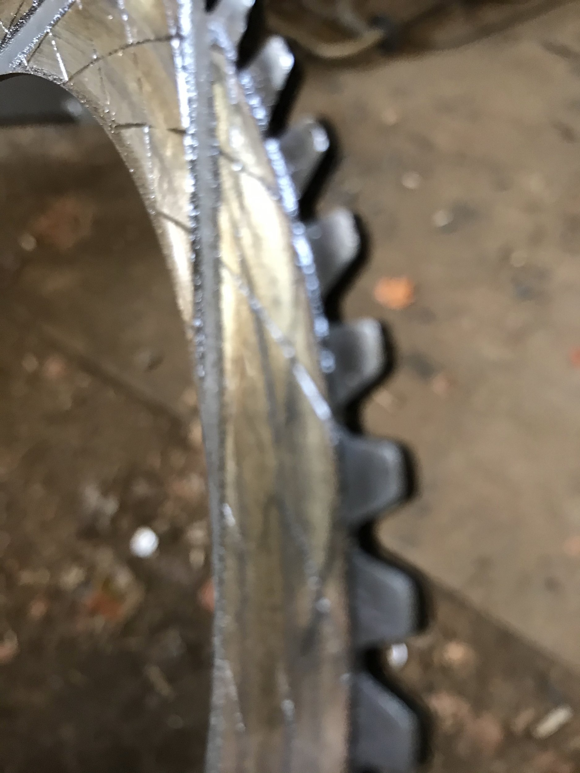

If it's a hydraulic shuttle, the pto clutch will be a multi plate wet pack and the pto will be a 6 spline 540. With a hydraulic shuttle, the is no dry clutch in the bellhousing at all, just a damper plate. The main clutch is also a wet multi plate pack and all the 'clutch' pedal does is act on the proportioning valve that controls the lock up pressure to the wet pack.
What I have and the only way to fly in my opinion because all dry clutches will fail at some point and all will require a split to replace.
Kubota's especially require an over running clutch on any implement that don't have one because the wet pack clutch brake on a Kubota is notoriously weak and any implement that don't have a built in over running clutch will destroy the internal clutch brake in short order. Once the internal clutch brake is destroyed, the pto stub will constantly free wheel.
Something you need to check when buying a used Kubota with a hydraulic shuttle. Grab the stub and turn it (engine off pto disengaged). If it turns freely, the clutch brake is shot. If it turns about 1/2 turn and stops, the clutch brake is ok. Renewing a clutch brake on a hydraulic shuttle tractor entails splitting the unit as the wet pack is in front of the final drive ring and pinion and is only accessable from the front of the gearcase.
If the pto stub rotates freely, pass on the unit. Not a cheap fix by a long shot. The 'fix' is easy, replacing the brake discs, but the access is costly.
