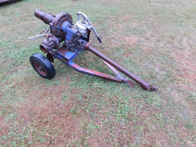

There used to a lot of towable pumps around here before pivots came along. Check farm equipment auctions or farmers junk piles. My dad had one similar to this for irrigating from the pond, and priming it was an ordeal.
/ PTO water pump #14
That looks about perfect. I'd like to find one myself.

Many of the water pumps or trash pumps will have a hard time priming with any lift.
One way often used to prime irrigation pumps was with a gas engine vehicle as a vacuum source,
a hose from the intake manifold to a valve at the inlet of the pump with the discharge valve closed,
use the trucks engine vacuum to suck the water up and fill the pump body, close the vacuum line then start the pump and crack
the discharge valve open and the water was pumping.
Especially the 4-8 inch pump suction lines with the semi-trash pumps even with just a 1 to 6 foot of lift can be very difficult to prime.
