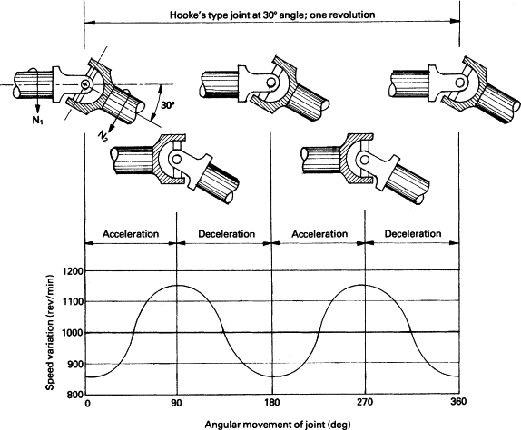

U-joints create a speed variation. Here is a graphical representation for a 30 degree shaft angle - shaft varies in rotation speed from 850 to 1150 rpm twice each rev for this example. That's why the u-joints are phased on a drive shaft - opposite end at the same phase angle cancels the acceleration/deceleration - but the shaft sees the speed change and they wobble. Your posthole auger has a very large u-joint angle so speed changes in the shaft are extreme, but as the input shaft on the gearbox is at roughly the same angle as the pto shaft on your tractor, there is no speed change at the auger and it runs pretty smoothly.

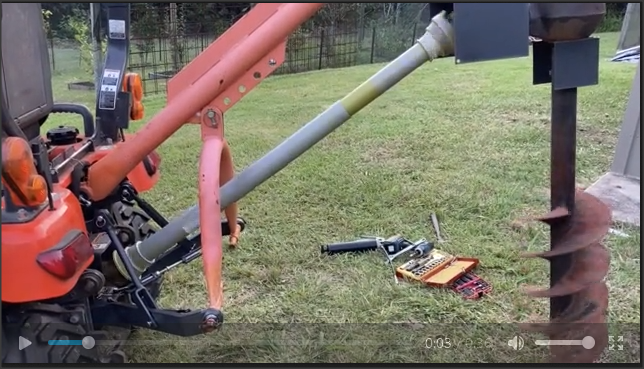

Suggest you check the indexing of your PTO driveshaft uni joints as they may be out of phase
You may also wish to join Aussie/NZ Kubota BX Owners Facebook group as you'll find a lot of 'local' knowledge available for us Aussies.
   / PTO Wobble
#23
Thank you all - didnt realise speed variation and phasing was even a thing! The alignment looks to be correct though from what I can tell. Hopefully it is just the angle as mentioned - I've tried it on a small test hole and it seems to operate okay so fingers crossed! Appreciate all the advice
   / PTO Wobble #24
That PTO shaft only runs 540 rpm so it should be fine.....run it.
   / PTO Wobble #25
Its just the shroud. if the shaft was bent it'd be shaking like crazy. I guarantee its fine.
Yep. Shaft is straight. Look at the shroud where the two pieces meet. No wobble at all.

my thought is some of the wobble is in the U/joins when you lower it down the wobble will be less or none

I don't think PHD u-joints are past maximum angle. I wonder if condition of PHD u-joints has been checked lately?

I see nothing to worry about. AS long as the shaft halves can slide in and out of one another....no worries
