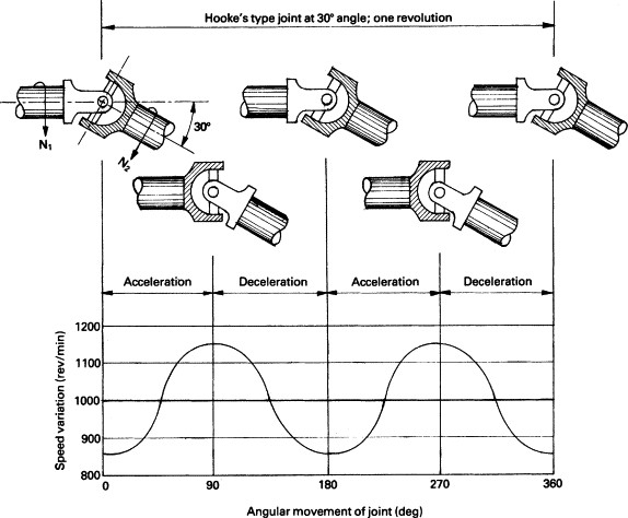

U-joints create a speed variation. Here is a graphical representation for a 30 degree shaft angle - shaft varies in rotation speed from 850 to 1150 rpm twice each rev for this example. That's why the u-joints are phased on a drive shaft - opposite end at the same phase angle cancels the acceleration/deceleration - but the shaft sees the speed change and they wobble. Your posthole auger has a very large u-joint angle so speed changes in the shaft are extreme, but as the input shaft on the gearbox is at roughly the same angle as the pto shaft on your tractor, there is no speed change at the auger and it runs pretty smoothly.

Suggest you check the indexing of your PTO driveshaft uni joints as they may be out of phase

Thank you all - didnt realise speed variation and phasing was even a thing! The alignment looks to be correct though from what I can tell. Hopefully it is just the angle as mentioned - I've tried it on a small test hole and it seems to operate okay so fingers crossed! Appreciate all the advice

I don't think PHD u-joints are past maximum angle. I wonder if condition of PHD u-joints has been checked lately?

Actually, if there's no double cardan joint involved, the two shafts are parallel. Then the amount of difference between the shafts is limited by the max angle the joint can run. Most single joints max out at 15 degrees.
