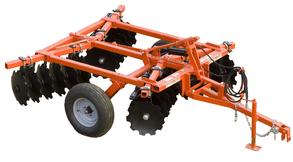

MF 245 , MF451 fwd.
I'm trying to match up the right size wheel disk for the sandy soil we have.
My tractor is fwd 52 eng. and 47 hp pto .
I found a good deal on a new 8' tufline out of state, that I want to order
Any input would be appreciative

It's not built yet leonz, I was going to go with , 9" BLADE SPACING, 20 blades, 20" notched blades on front, plain on rear.
I've been using a cross drawbar on the 3pt. to pull a older 6' offset drag type disk with 18x20
and I use full throttle (in low 4th gear fwd.) that pulls around 5 mph.
I'm very new to this tractor I just got it , its a MF 451
Here a picture of how my disk is going to be set up, not the same size disk though.

You should have zero problems with that disc harrow.
The one thing I would think long and hard about is whether
I would really want a set of smooth discs on the rear.
One quick cheat with towed implements is to attach a pair
of heavy chains to the corners and tighten the chains
up to make the harrow follow more closely in turns.
Its especially handy when you want to back up and the
implement has a mind of its own and goes where only
it wants to go.

I'm not sure what you mean (heavy chains to the corners and tighten the chains) Do you mean to have two chains attached from the tractor to the corners of the implement ?
And to the blades I first was thinking of going all smooth , I figured they would last longer.
But maybe smooth disks are harder to pull in sandy soil conditions like we have here.
Another option they have is grease-able trunnion bearing housing, compared to triple sealed bearings that comes standard.
Thanks :thumbsup:

I would go with a 10 foot wide, un-notched blade, pull-type disc for a tractor of that size and sandy soil. Smooth blades last up to 4x longer, and notched style are not necessary in sandy soil. Most folks here relate more to 3 point discs which are far more common on CUT's, and an 8-foot 3-point would be the right size for that tractor. You are definitely on the right track with the pull-type disc, which do a far better job than a 3-point, the most significant improvement being aproximately 30% less fuel usage to do the same job, assuming equal weight per disc 3-point and pull-type. I have an 8-foot pull-type disc that is sized perfectly for, and I use often behind a 28 hp, Ford 8n tractor. I also use it on occasion behind a 20 hp Allis Chalmers C (a little bit much for on more aggressive settings), or a 46 hp, 4wd, JD 4120. Honestly, the JD does not even seem to know the disc is back there, even at the most aggressive cut angle, and could probably handle a 12-footer. It pulls that disc easily thru plowed ground at relatively high ground speed and the engine at idle speed, as long as the 4wd is engaged. Other than a front-loader, I can think of no implement that benefits more from 4wd than a disc. With your 4wd tractor, you can definitely bump up the disc size compared to what a 2wd tractor of the same weight could handle. Again, fuel economy comes into play here and your 4wd will get the discing job done using around 25% less fuel. If you add these two factors together (pull-type disc and 4wd), less than half the fuel can be used to do the job compared to a 2wd tractor with a 3-point disc. In these days of $4.00 diesel, I think folks are crazy trying to work any serious ammount of land with the latter.
/ Pull Disk in sandy soil #7
That disk should work well for your tractor, I would prefer smooth disks front and rear for sandy soil. Notched in front and smooth in rear is okay too. 9" blade spacing is what I prefer. If it were me I would prefer an 8' pull type with 22" blades on 9" spacings with scrapers. Tuffline makes a nice disk, you should be good to go.

"exactly!, it limits the "wild willie" factor when backing and avoids excessive overlap" and the front discs are made more aggressive by restricting the amount of swing off the pivot.

Yes I thing I'm going to go all smooth front and rear like you say.
curious why you like 22" blades ?
I was thinking I didn't need a scraper kit in are sandy soil here.
:thumbsup:

22" blades are usually a bit thicker and stronger than 20" blades. Will you be disking in growth other than grass? Any sticks, or stocks of any kind? If you are going to need to disk vegetation other than grass, I would recommend that you get serrated blades at least on the front. The serrated blades tend to go up and over material vs just pushing it along in front of the disk.

I prefer the 22" blades for the extra depth and blade weight, simply get more done in less time. I also prefer to have about 90 to 100 lbs. per blade weight.
You may not need scrapers but it seems every time I have used a disk I needed them. The Frontier 1508 (?) pull disk is a good example to look at, it is made by Tuffline for Frontier according to my dealer. You can likely get it from Tuffline for a little less than Deere. .
