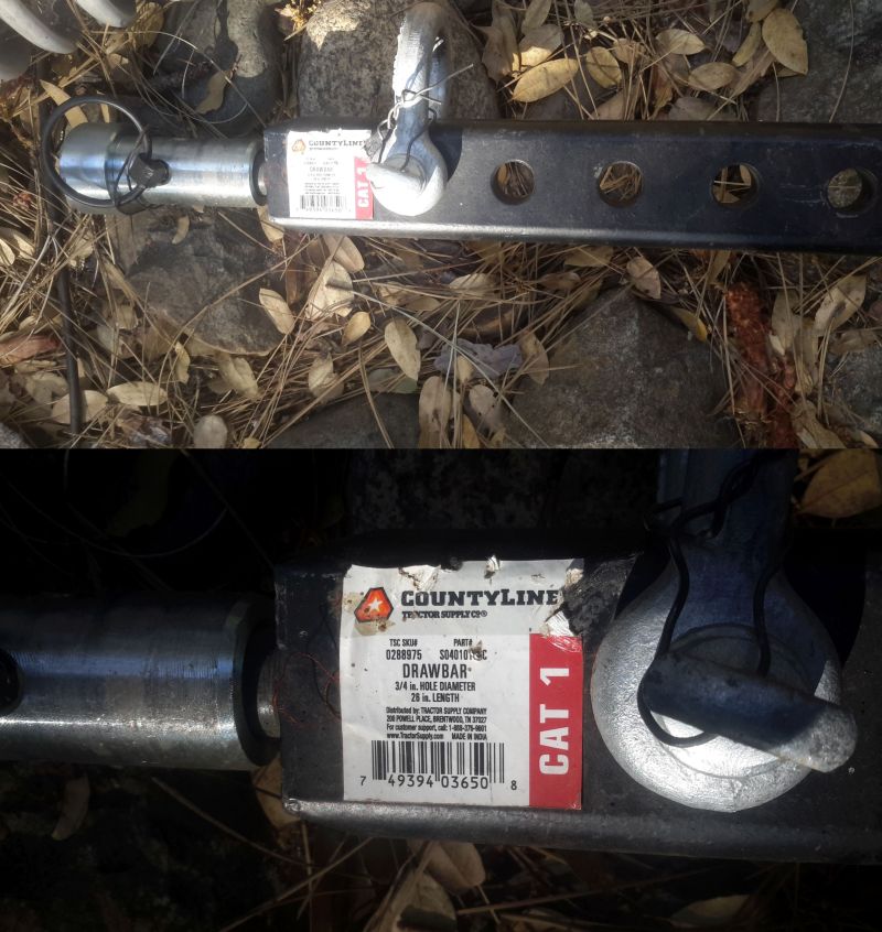

And yes I know I have used linch pins instead of driving in roll pins to lock adapters on, but I am not sure adapter are going to stay with this "xxxxxxx bar"
Dale

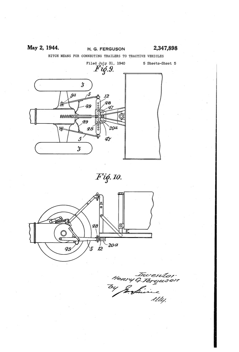

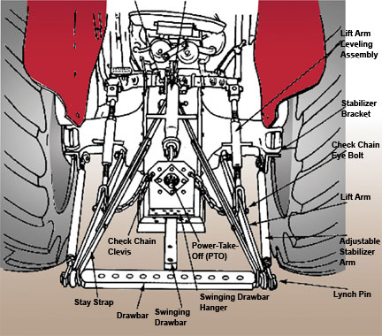

The 3-point drawbar was part of Ferguson's patented hitch system for transferring trailer weight to the tractor for better traction. I didn't notice any mention of it in the hitch patent, which was mostly about the draft sensing.
When the 3 point hitch first became available, almost all older implements were pulled, not carried. The implements usually had a clevis hitch. The 3 point drawbar (with stay straps to keep it at a fixed level) was convenient for these implements, and also allowed greater vertical angle in dips and ridges than the fixed or swinging drawbar and clevis.

Others used a extension drawbar that laid on top of the 3pt crossbar with a clevis. I had though that the extension was just a scrounged up part but I saw very similar pieces at times so maybe it was a Ford part.
As mentioned, that setup made use of the stay straps to keep the 3pt from floating.
As far as the crossbars having several holes I think that goes back to the earlier tractors. Most had cross drawbars with several holes. There was even some equipment that mounted to the tractor using those cross bar holes.
We used a Minnesota brand sickle mower that had a similar crossbar. That crossbar was bolted to the tractor crossbar, a bit of a hassle in all.
That was why the mower was left on that 8n all hay season.
A swinging drawbar could also be used to offset the tractor tracking to the equipment tracking (plowing with the tractor tire in the furrow).
Farmall in particular used a floating drawbar on the crossbar using rollers. I remember looking at those Farmalls not understanding the point of the rollers (my family didn't know either). I was at an auction or something and brought it up. A oldtimer told me that the floating drawbar was used to help the tractor turn in the field. The tractor would start turning and the drawbar would slide to the inside of the turn, a big help especially with disc's that weren't raised for turns.
