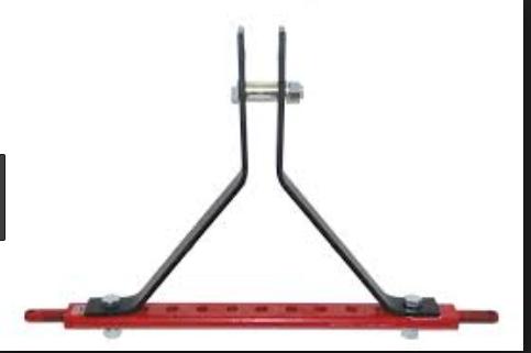

Ummm.... Sort of a universal fix for the object of discussion when using QH....
Would also leave a selection of holes in "that thing" available to attach something...
Dale
Dale
Dale, thanks! I like it.
