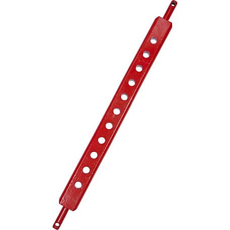

They are NOT DRAW BARS, They are spreader bars. Made for spacing the lift arms when no attachment is fitted.
That people call them draw bars, or use them for "pulling", is testimony to human ignorance.
I have one that stays on the tractor just about all the time, has a trailer ball in the center hole I use to pull my trailer around. It also can carry rear weight when needed using the loader. Also use it to pull small sawed up lengths of trees. Comes in very handy.
CountyLine Cross Drawbar, Category 1, 3/4 in. dia. at Tractor Supply Co.

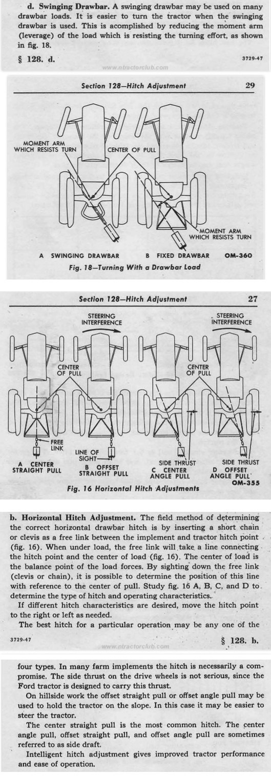

   / Pull from the front or the rear? #107
It is a drawbar, or Ford was misinformed.
Here are some clips from the 8N manual. Ford calls it the fixed drawbar, and diagrams always have drawbar stays installed to keep it at a set level. They even have a section about using the holes to offset the implement, and how it affects the handling.
Bruce

I think you will find that today, John Deere calls it an "implement bar".
Lawyers being what they are.
They are not meant for pulling maximum loads that might lodge against immovable objects. The draw bar IS!
Only a fool would use terminology to justify stupidity!
