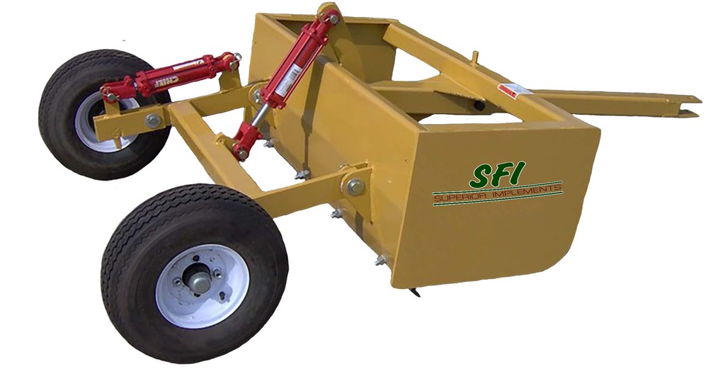

Anyone using a pull type box blade? I have found a 8 and a 10 for a tempting price. Would be mainly for road repairs that never end (over 50 miles of road).
The back wheels can be manual or hyd. I know you couldnt berm roads with it. but with the guage wheels seems like it could be a good first passes implement to get everything smoothed and then use another tractor following it with implement for ditching and berming.

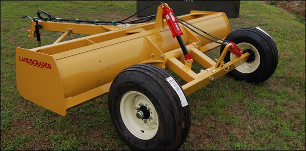

I would consider a HEAVY Land Plane Grading Scraper with a hydraulic lift rear moldboard. before finalizing on a drag scraper. With fifty miles of road you need speed. A LPGS will level fast, is a simpler implement and easier to turn around. But, the price you are seeing may be irresistible.

Many do tilt. On some, the whole axle will tilt. Others tilt by having one trailing arm adjustable.
"Drag scraper" gets the most uncluttered Google image hits, where I found these photos.

If you need to move material from here to there or anything more serious than washboarding then the drag scraper is your tool. If you are dealing with smoothing and/or washboarding then a very heavy duty land plane grading scraper will do the job.
Honestly - if you are dealing with 50+ miles of gravel road that needs year-round repair. I'd be looking for an old non-motorized road grader or even a motor-driven one.

I have used a 3 pth box blade and found it very terrible for road work. I bought a 10 foot pull box blade and to use for grading pond sides and it had worked great on short dirt road across our property. It is hyd operated and the right wheel can also be raised or lowered by itself to allow either to cut less or more than the other. I was surprised how well it did to the crown road. No comparison to a 3 pth for leveling due to the pull box blade wheels are riding on graded ground while the tongue moves it away from the tractor and the rear wheels which mover with the rough ground being graded. Much like road grader design. I have used rear blade that rotates left to right and also the angle of the blade. Neither the 3 pth leave as smooth ground as the pull type does. Have never used a land plane. Do not seem to be very popular around here. Might have seen one on a implement lot.
/ Pull type box blades? #9
I have a 10’ one. I really like it. It is kind of tricky to set so it doesn’t get too full. If it gets full you are going to need a lot of HP and weight to keep it moving. I pull mine with a 130hp 15,000 lb tractor with dual rear wheels. You don’t need that much grunt for light use if it is not full but load it up and you will want that much and more.
I can get better results with it than I can with my road boss but I use my road boss more because it is easier to connect to my skid steer and is a lot more mobile. If you have long straight always which it sounds like you do the. It may work for you. For small areas it is a pain to turn around.

Never owned one, but have borrowed several. Definitely want hydraulic tilt. Great tool to move a lot of material and shape the fill area.
price was the attention getter. Ideally a motor grader would be the ticket but this is a hunting club and there is no budget for that. We may look into a land plane. Currently for yearly maintenance we use grader blades to pull the ditches and keep up a high crown. We try to have at least a 1 ft drop from center of the rd. About every 3 years we will rent a small dozer and work the worst spots.
/ Pull type box blades? #12
It is good news that you understand the need for a high crown.
Many do NOT!
A land plane will likely serve to decrease your crown over time, though if you have significant crown to begin with, it may last for a good while.

The pull type box Blade would be fine for the initial smoothing imo. But a good land plane grader scraper would be my pick for the long term. I often use my lpgs to smooth up rough spots and while not as aggressive as a box Blade it is fast enough. For an existing road it would be my choice.
