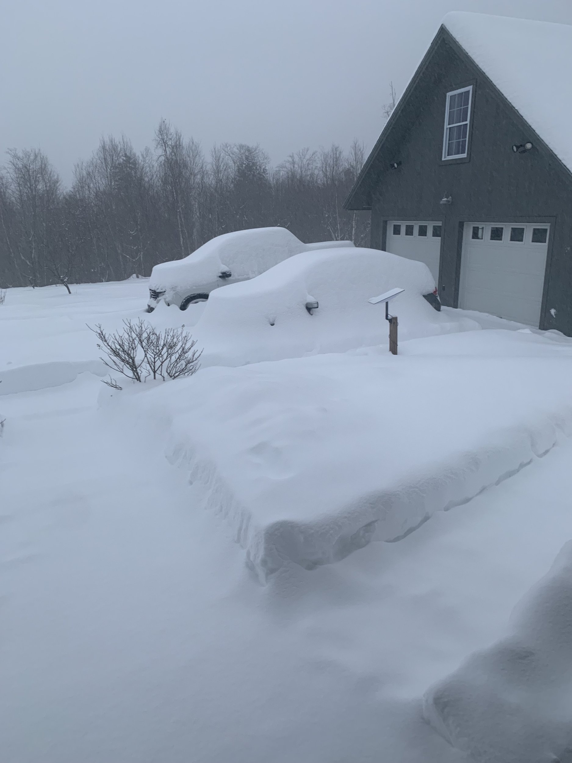

We got 18” of snow yesterday, I’m going to prove all the nay sayers that the inverted blowers can handle that amount. I know it helps to have a 5 series tractor with ice chains! This is a before picture!
   / Pull type Hybrid snowblowers ? #89
I am standing by for results. This is a good test.
   / Pull type Hybrid snowblowers ? #90
I'm not worried about the blower, but the tractor driving through 19" of snow.
I find myself turning around to look at my inverted blower a lot. Still turning around.

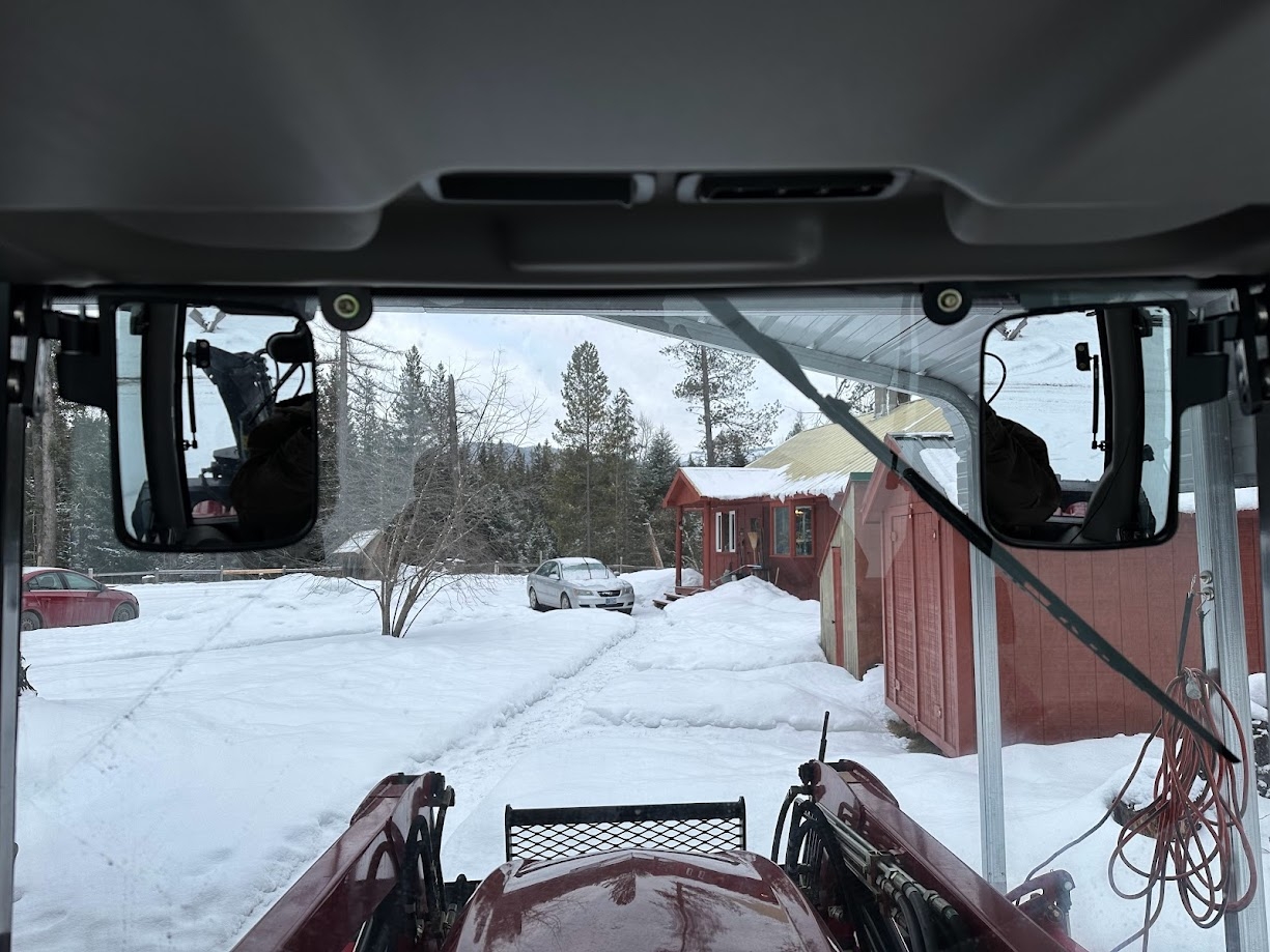

I drive through 18'' of snow with my small TYM T474 with no issues and my 68'' MK Martin pull type blower. I added some magnetic inside mirrors to help keep track of the turret instead of adding electronic devices. I work in IT and has become more simplistic the older I get.
