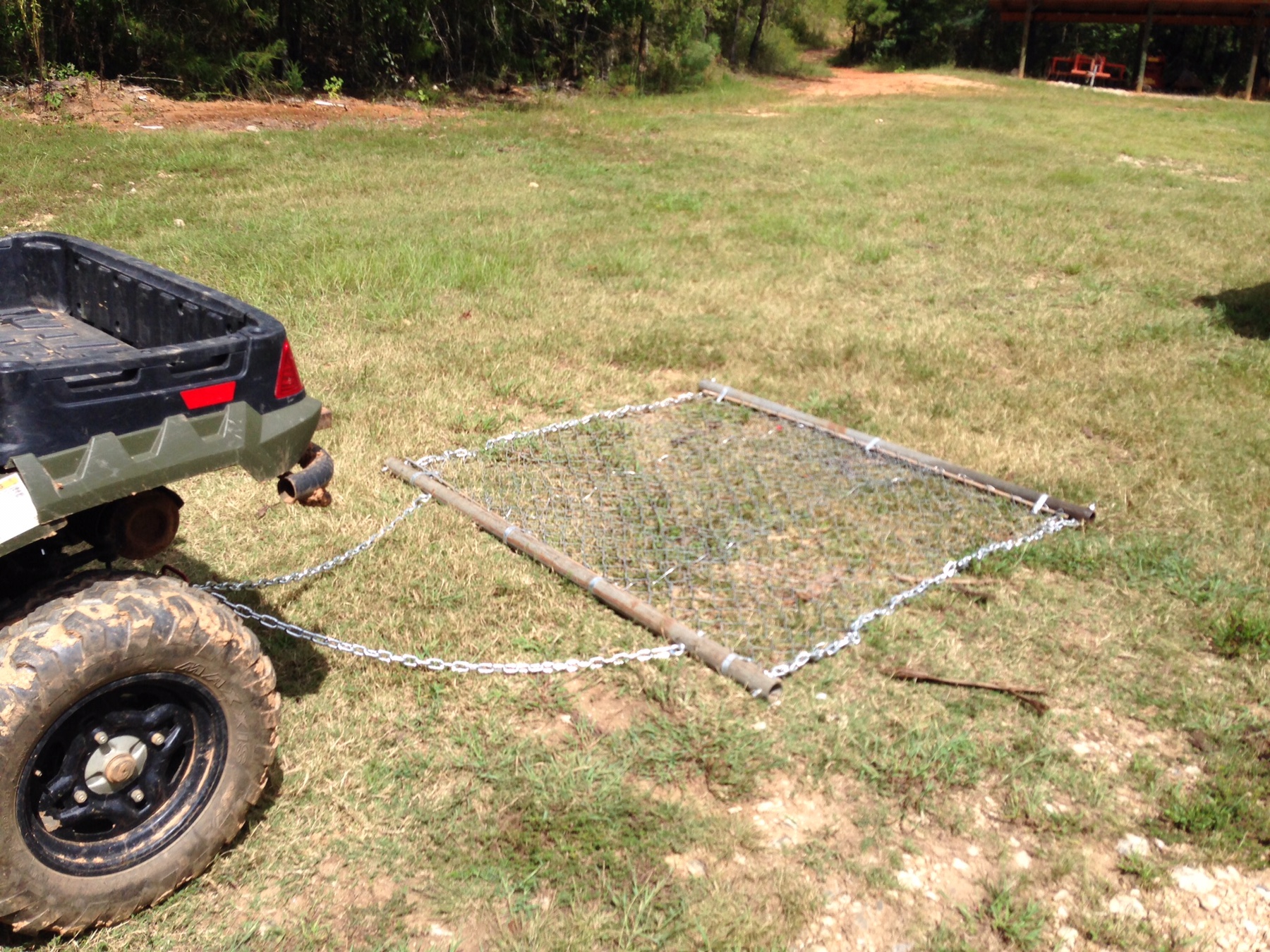

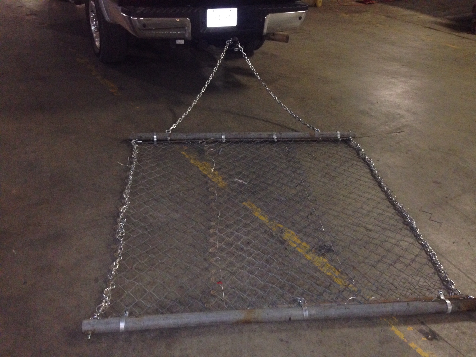

Thanks. I made a 6 foot wide drag harrow out of pipe and fencing and pulled it around today. Yes, if did great.
Got any pics? I'd love to see that home made drag harrow. I've been using an 8 foot chain link fence gate. But I tore it up this past summer, so I'm gonna have to make something soon.

Yes. Here are some pix. It did pretty well. The pipe and connecting chains are very strong. The fence is the weak point. But after dragging it a few miles, the fence tore a little, but it still works. I bought a roll of scrap chain link fence so as it deteriorates severely, I can quickly replace it. The pipe is not fence post pipe but much heavier. I bought it as a scrap yard. It is 6’ x 6’ IMG_4657.JPGIMG_4658.JPG

That looks good. When I was using my old chain link fence gate, it was so light that it would bounce around on rough ground. So I put some old scrap tires on top of it and wired them to the chain link with baling wire.
It worked really well then, but the weight of the tires put a lot of stress on the gate frame and it eventually tore completely apart.
