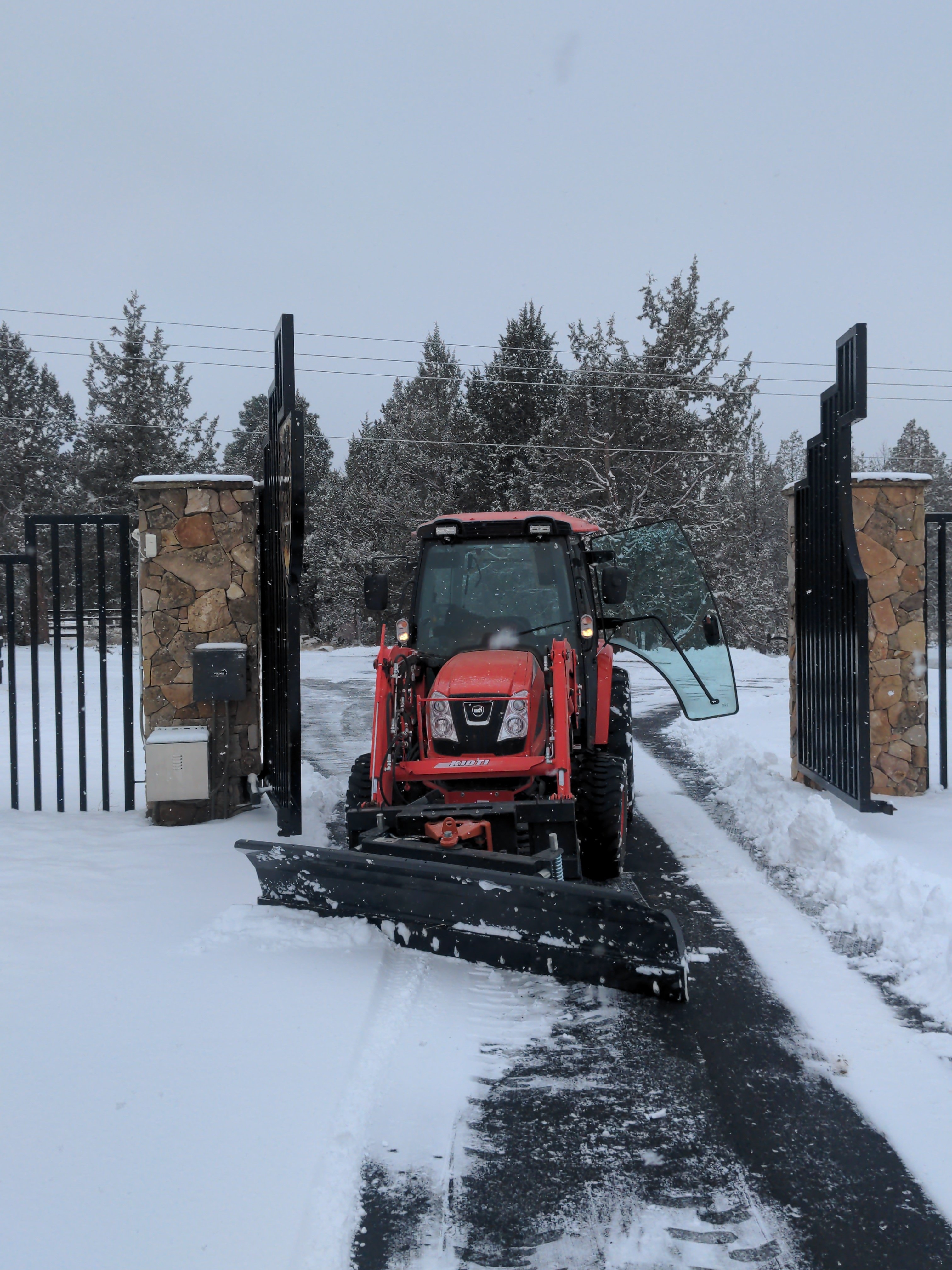

Hey Bendboater, greetings from Tumalo.
I ended up buying the 92" Titan Attachments snow blade and did the 'horse stall mat' modification in order not to damage my driveway.
I actually used it the first time this morning and have nothing but positive things to say. The blade worked as intended and i was able to clear my property in 45 minutes, whereas it used to take me >2 hours.
The third function (allowing me to swing the blade in any direction without having to exit the tractor) and the cabin heating result in a totally different experience from the past (ATV/quad with front blade). I was just listening to podcasts in a warm and comfortable environment, highly recommended !
Detail of the horse mat fix :

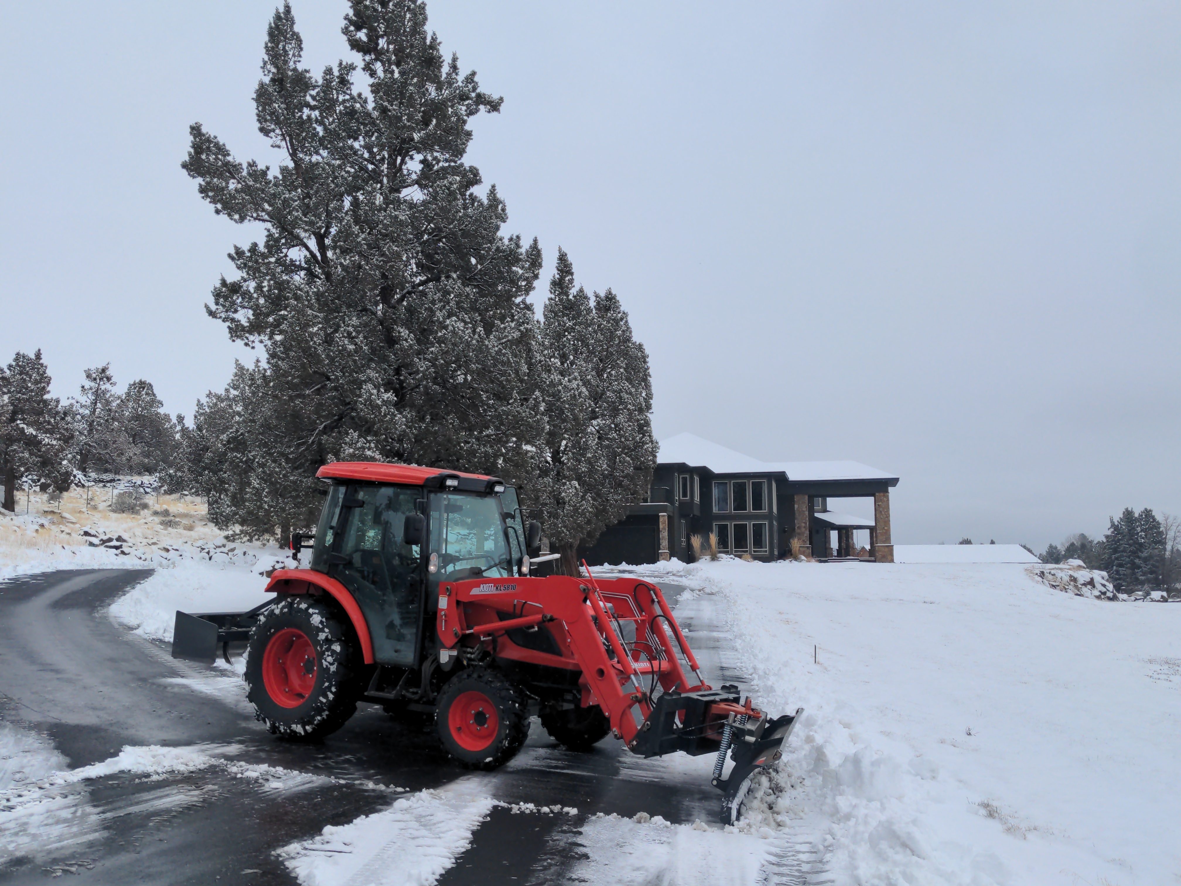

I know this is an old thread. Didnt read all the posts so not sure what you did.
I was in the same boat. Pusher or Blade. Pushers are nice but if you dont have a few pull-offs to dump the load, you may not make the full run down the driveway.
I went with the Blade. I too have third hydraulics. I got the V blade. Virnig V blade with quick attach.
The important thing to consider is how much Float is designed into the Blade assy. Most plows with QA are made for Skid Steers. With the short wheelbase, they dont have Float. With your tractor, one little inperfection in driveway will cause the plow to want to lift or dig if you dont have float.
