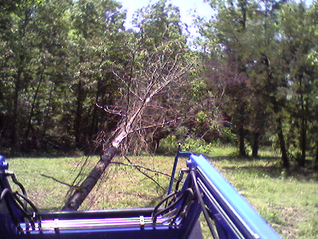

You may have had a better chance of getting the roots out if you had not cut the trees. Place the loader bucket against the tree and push from several feet above ground. At least that is what has worked for me.
I agree with others on here, it may be hard to get them out now. You might get some stump killer, check local ordinances though, and put on them to kill the stumps, if time is not imperative.
If I were going to pull on something like that I would do it from the swinging drawbar, not on the bucket, or the three point hitch. Otherwise you might just have to use the loader and break the roots and then level the ground afterwards. Just my opinion.
