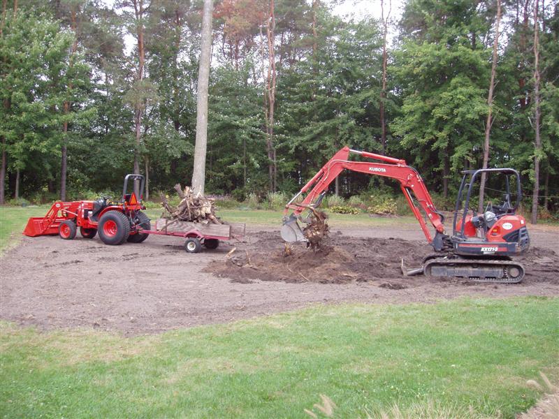

In my area, non coastal New England it is so rocky that digging with a front end loader is useless. Ther is no way that I would ever get a 24" oak out of the groudn with anything other than a backhoe and several hours or my excavator and a hour.
