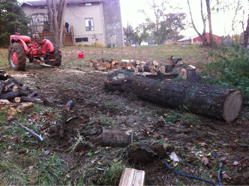

If you use a cross draw bar, and say your skidding a big log. Can you run the chain over the cross drawbar and then hook to the pulling drawbar. Then raise the hitch enough for the log butt to clear the ground. Is this effective or a waste of time.
I'd say you probably shouldn't, sure would like other opinions on this.
/ Pulling with the Drawbar #46
I'd say this would have he same effect as connecting the chain directly to the cross draw bar.

We had a guy here in Marlette roll a Farmall H over on himself. He hadn't been here long - moved from China with his sister and her husband. Anyway, he was trying to pull a heavy (too heavy) gravity box with a chain (?) and for whatever reason he took the chain off the draw bar and hooked it around the seat bracket. Well it rolled right over onto him in almost an instant. He was messed up pretty bad (head injuries) for awhile but is OK now. Best advice I've seen here other than hooking up low is to GO SLOW.
Like that cage on your tractor Glade. Some close ups would be real interesting. A great way to mitigate a roll over along with a tree slap now and again.
