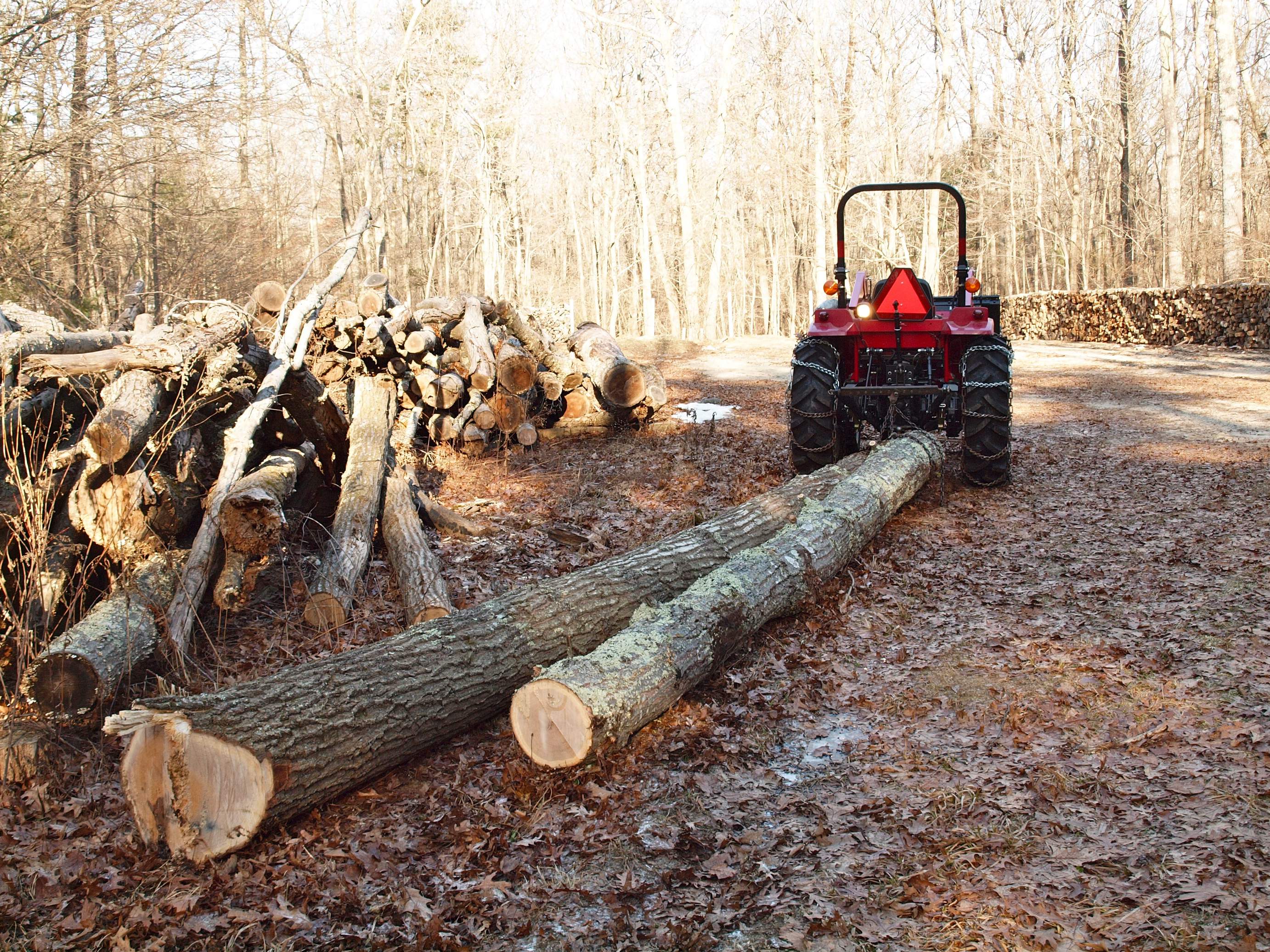

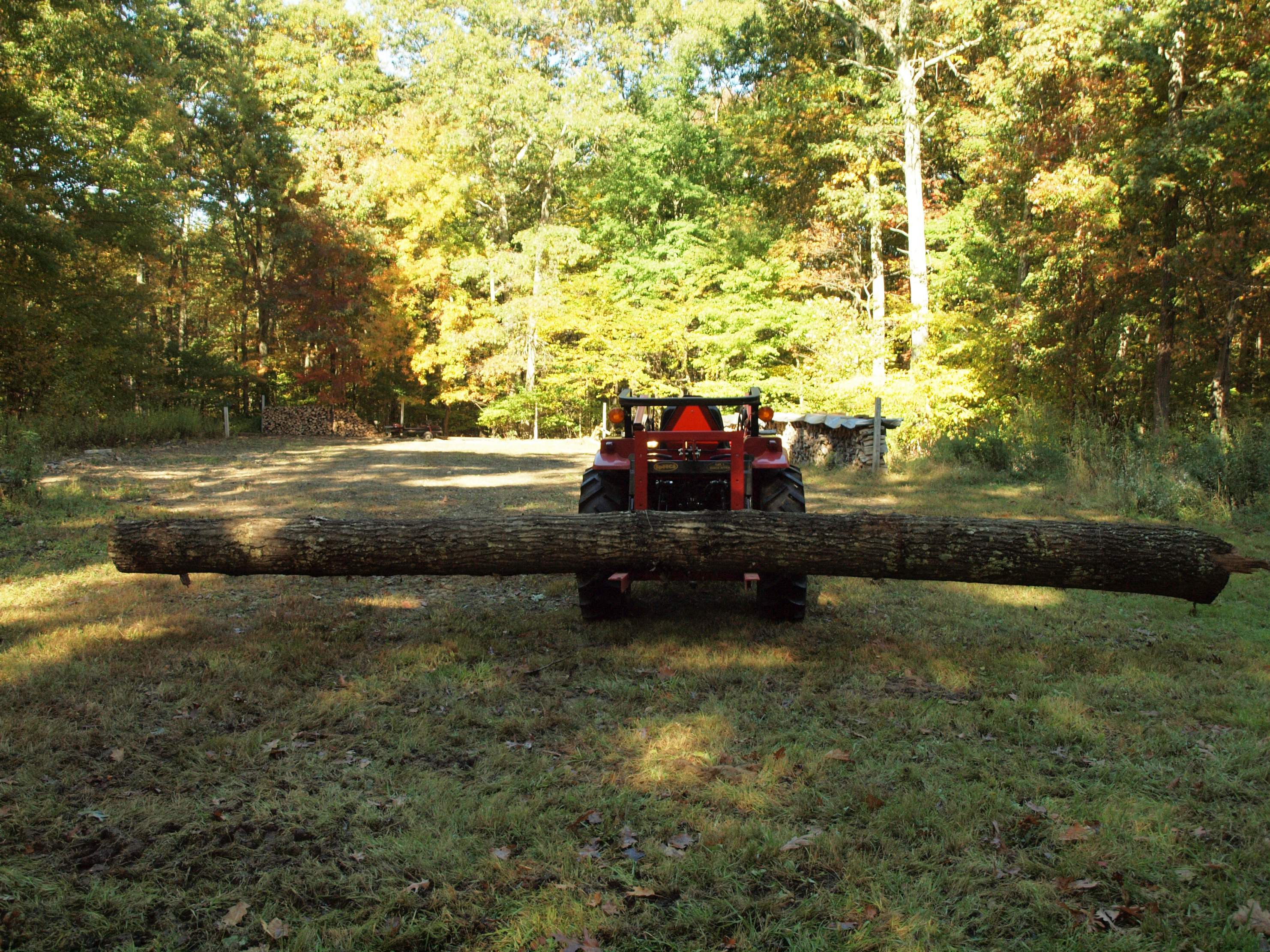

Use a tractor not a riding movwer :D
You will spin out before you do damage pulling logs. (usually)

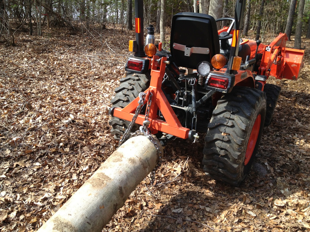

If you use a cross draw bar, and say your skidding a big log. Can you run the chain over the cross drawbar and then hook to the pulling drawbar. Then raise the hitch enough for the log butt to clear the ground. Is this effective or a waste of time.
/ Pulling with the Drawbar #34
For large logs, I use one chain to my skid plate (on 3-pt hitch) to lift the log. Then use another short chain to the drawbar for pulling.
For small logs, I only use the one chain with the skid plate.
