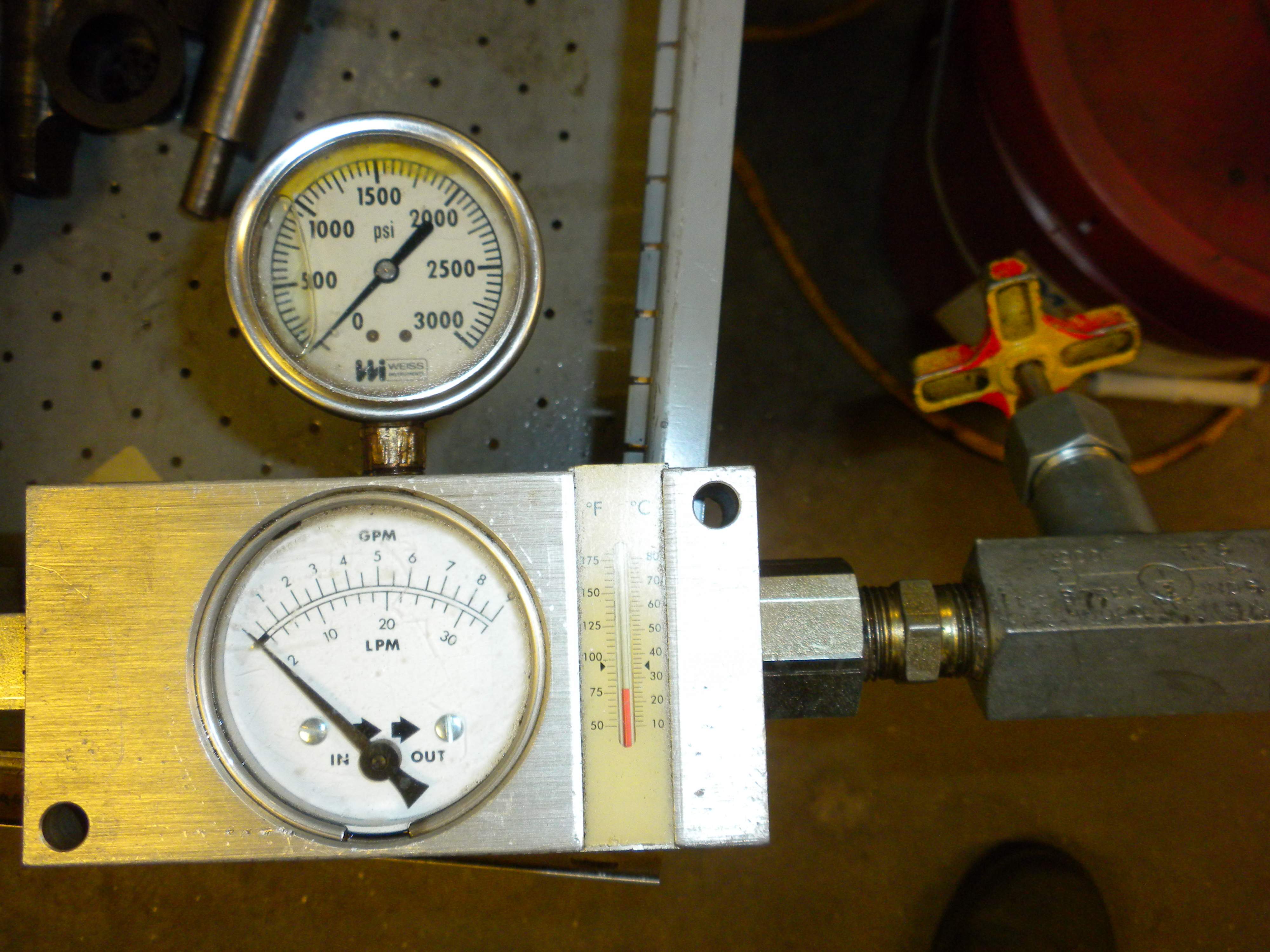

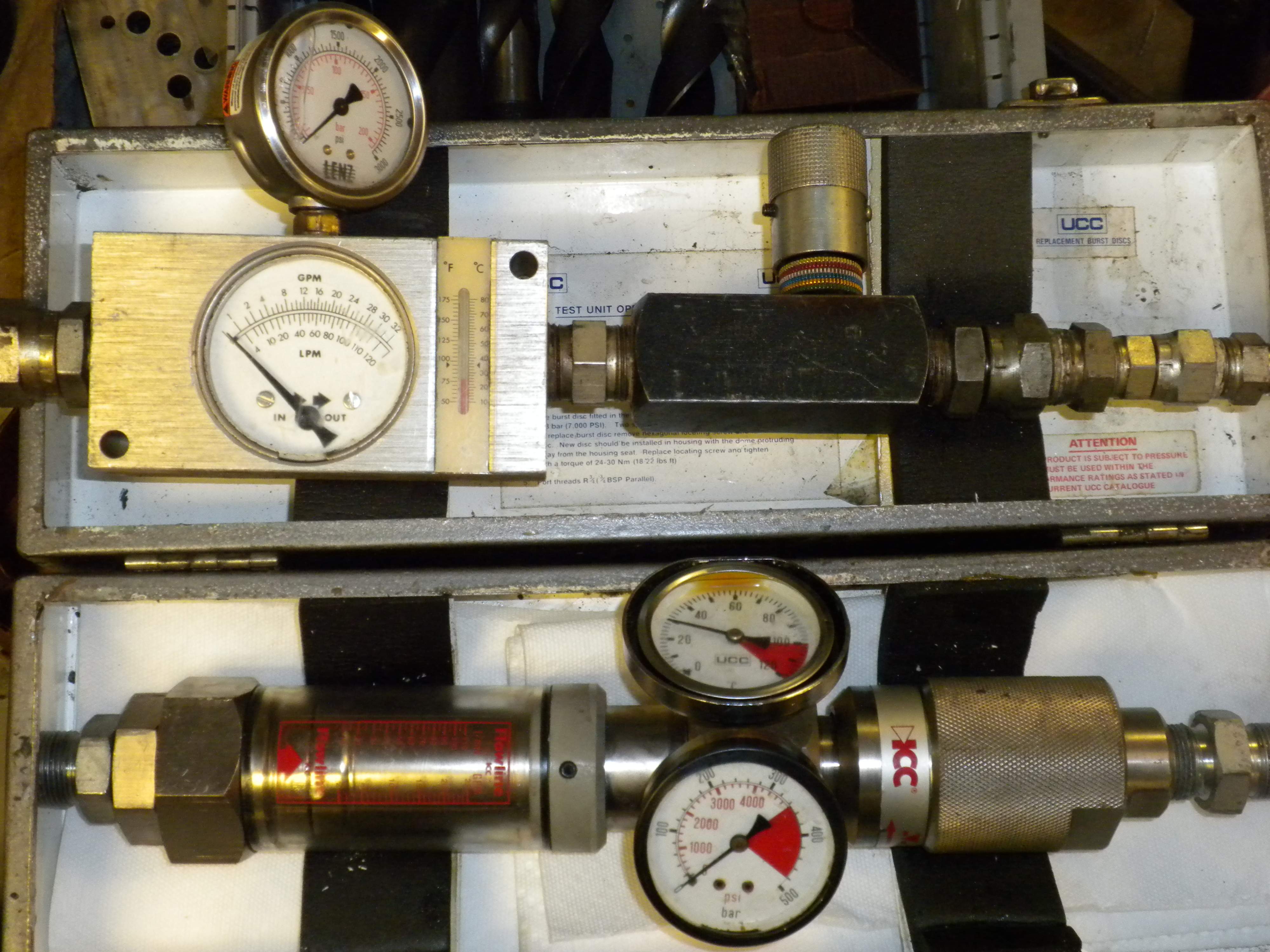

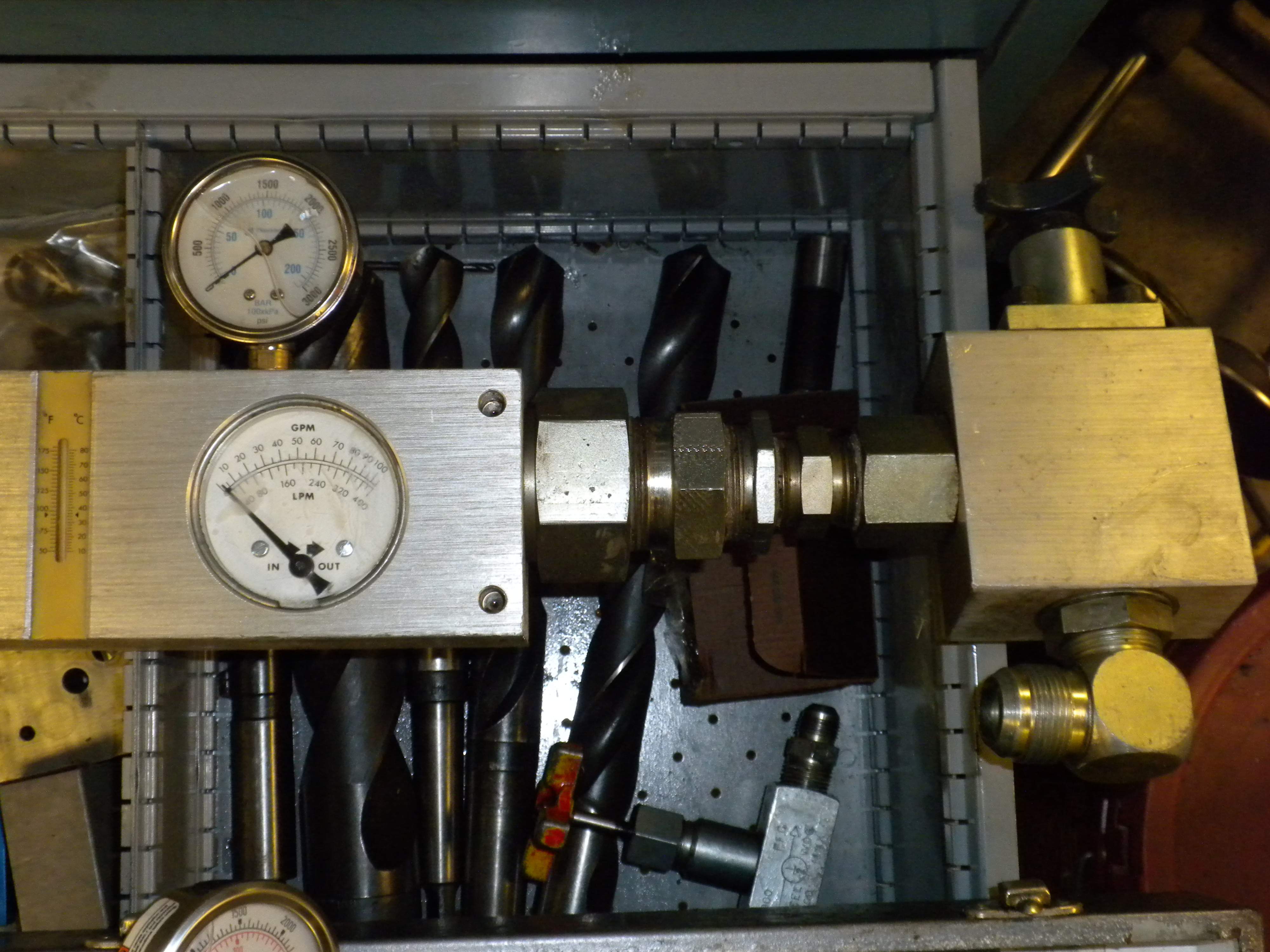

Here's a look see at these wonderful things we call "Flow Meters".....simple yes, but they do the trick.....notice they all have some sort of load valve...
Funny how most all of the posts here on TBN mention using pressure guages to troubleshoot but, hardly ever hear of a Flow/Pressure Test being done.....Best way to see AKKAMAN's reasoning's for this thread without all the Engineering/Mathematical Analysis .....(Not that it's not important:thumbsup:)

Nice setup!
I think the reason (mine anyway) that you don't hear mention of them here on TBN is simple, Pressure gauges are cheap-you can get a 0-3000 PSI gauge, short piece of hose, and a QD nipple to plug into a existing port on the tractor for $30 to $40 and virtually anyone with basic mechanical skills can use it accurately and effectively.
As you well know, flow gauges are expensive (cheapest I have seen is $150 and up), and you must plumb it in to the system, often requiring many fitting and/or adapters-plus a set of manuals to tell where the test ports are if there even is any.
The average backyard mechanic can test for pressure, and even adjust PRV's with very basic skills and tools, but to test for flow is a whole 'nother story!
