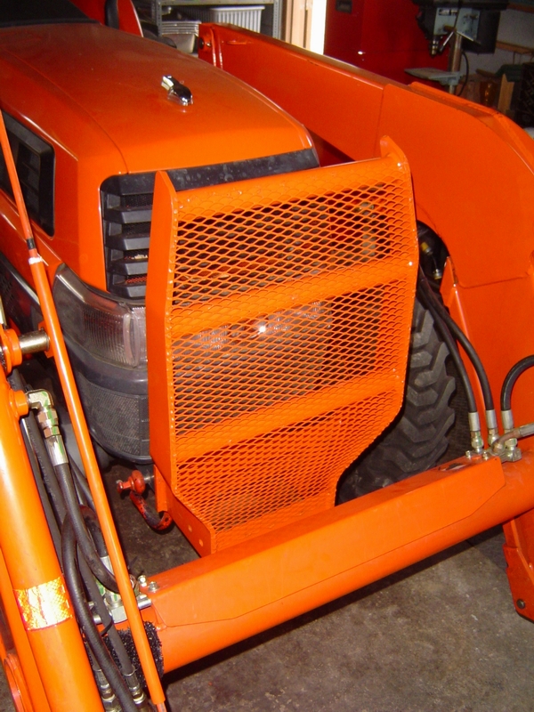

Brad,
Here's a pic of the hose hookup...from the grapple to the tractor. I am guessing the hose length on the grapple is around 4 or 4 1/2 feet. On the grapple end, there are two T's where each hose is threaded onto. Each T goes to a cylinder end. Each cylinder gets the same pressure since it is T'd, thus opening/closing equally. The other end of the hoses have connectors, (male and female), which mate to my tractor connectors. That way you don't get the open/close circuits backward. My 4in1 bucket is exactly the same. Hope this helps.

Dave - thanks a lot for taking the time to post that for me. I don't know if you are interested but I posted my bulkhead pictures in hydraulics. Cool set up you have I hope to complete mine by spring.

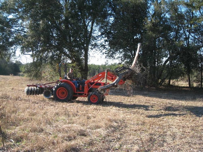

I am very impressed and satisified with the WR Long grapple. I used the root rake more than I expected. Very good design!
