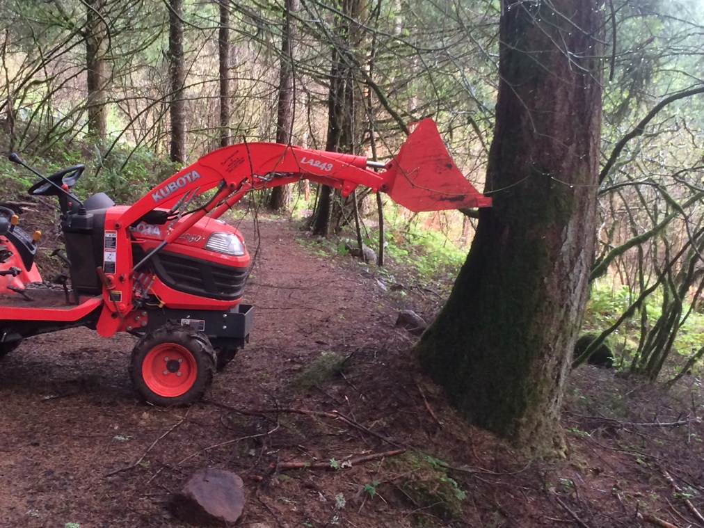

Looks to me like an impending personal injury 'accident' Heck of a way to address a 'leaner' Have a huge on in the front yard presently that needs to come down and Just called my arborist buddy with his Hi-Ranger to do it for 2 reasons actually, One, it's leaning towards the house and he has the proper equipment to take it down, plus he has insurance, should it go bad. Another 'Yuge' stump to grind. I'd say it's at least 50" at the base, maybe more. Put my 090G against the base to compare ind even the 4.5 foot bar is not as wide as the soon to be stump will be. Old popple tree that is dying. They don't have a long lifespan. Already gotten tid of the larger wood and anything under 3" he will chip. Quoted me a grand and I'm good with it. If it fell the wrong way, it would be 10 times that.

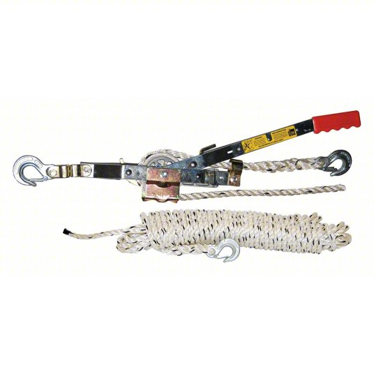

A pair of those devices and good use of Prusiks can do the job. Much better is a cable "Cable Pull" or the like, as there is no spool capacity limit.
Probably shouldn't be using a steel line at all, not enough stretch.
Suggest
keeps pulling even after you stop ;)

Very different rope.
The maasadam rope puller usually has a 1500# line, because you're typically not trying to pull a tree out by its roots and don't want to be carrying around a ship hawser.
The rope puller gets a good pull in, puts a load on a tree, and has plenty of stretch so that when the tree starts moving, the rope is still pulling for quite a while - if you've got 100' of rope with a decent tension on it, it's got a good pull for easily 5-6'. A steel cable or winch line would go slack as soon as the tree starts moving and wouldn't any help at all beyond that point.
