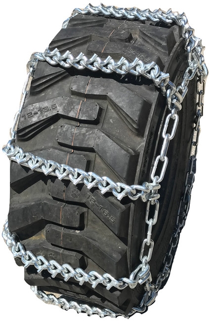

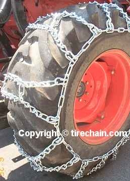

Here's a few chain types:
Ladder style: available with cross chains every 2 links along the side chain, or every 4 links with or without "V-bars" for extra traction. (4-link V-bar shown)

Duo Grip: available with or without V-bars. (There is also a variation on this style which adds a ladder-type cross chain between each duo-grip pattern: improves traction and makes the ride a little bit smoother.)
Euro-style: (European Diamond Net) Usually studded (which is more aggressive than v-bars), but I have seen some with just plain chain. There are also some variations on this style, but the basic idea is that there is always a good bit of chain on the ground, and that there is chain on the tread around the entire circumference.
